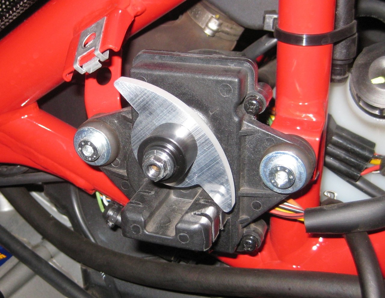

  5. If your flappy valve and motor is anything like the 1200 Multistrada, the Leo Vince decat pipe came with a dead weight that you screwed to the motor in place of the cable quadrant and fooled it into thinking it was operating the flappy valve. Andy

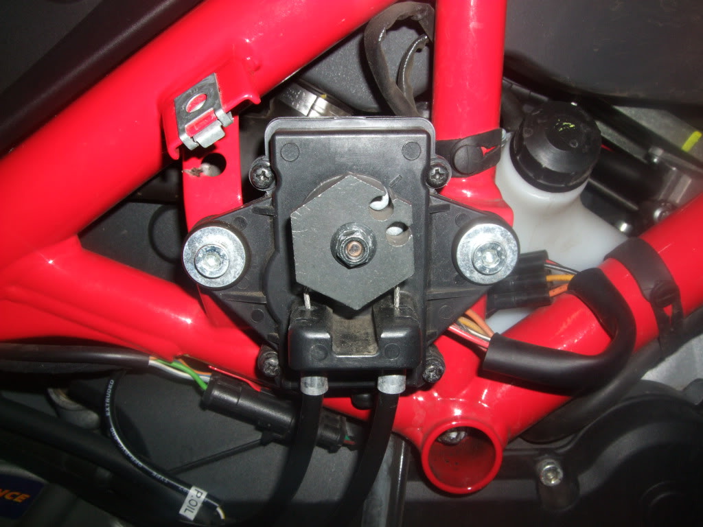

  9. On the 848/1098 etc you could use a small plate to replace the cable system on the actuator.

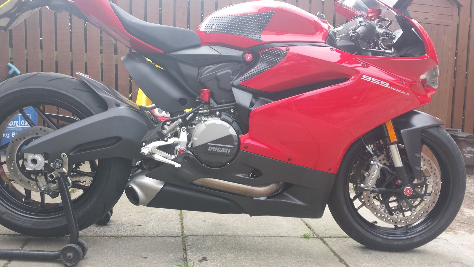

  12. Hi there Monsterleerob, I want to fit the 1299 underslung cans on my 959. The dealer (Johannesburg, South Africa) says the engine light can't be switched off. Did you get the light turned off?
    Thanks, H Man
  13. All you need to do to not have the engine light if you've removed the (0.6kg) servo motor is buy the blanking plug connector from Ducati. It's a very easy job that you can do yourself just by removing the left side fairing as you're sitting on the bike. The plug is under the battery in a cluster of three plugs.
  14. This has been incredibly useful - thanks. You seem to very knowledgeable on the matter. Can the standard map work fine with the 1299 pipe?

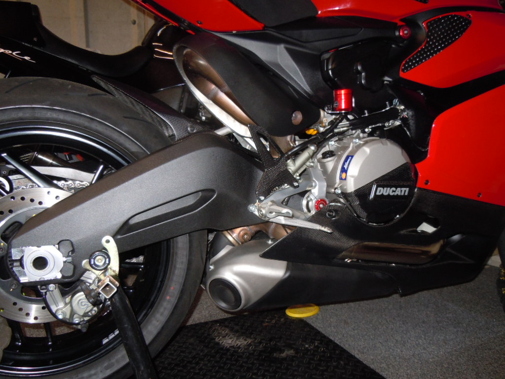

  17. Hi I done the same mod,i see there is a few standard 1299 exhausts on auction site,i have spare 1299 lower fairing.
