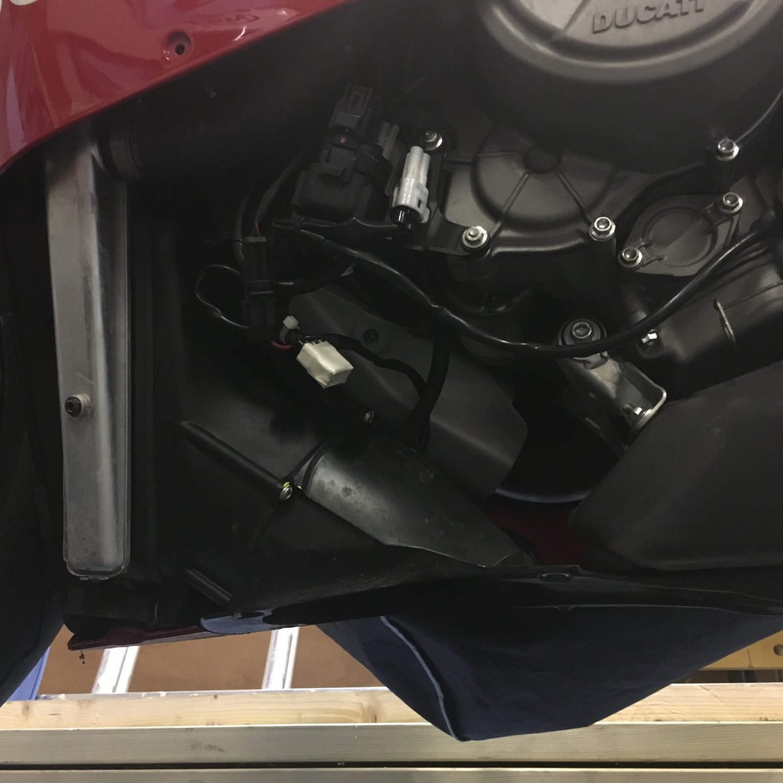

  13. Have you left some of the servo there? I'm sure I took that whole thing off. I'll see if I can dig out a photo.

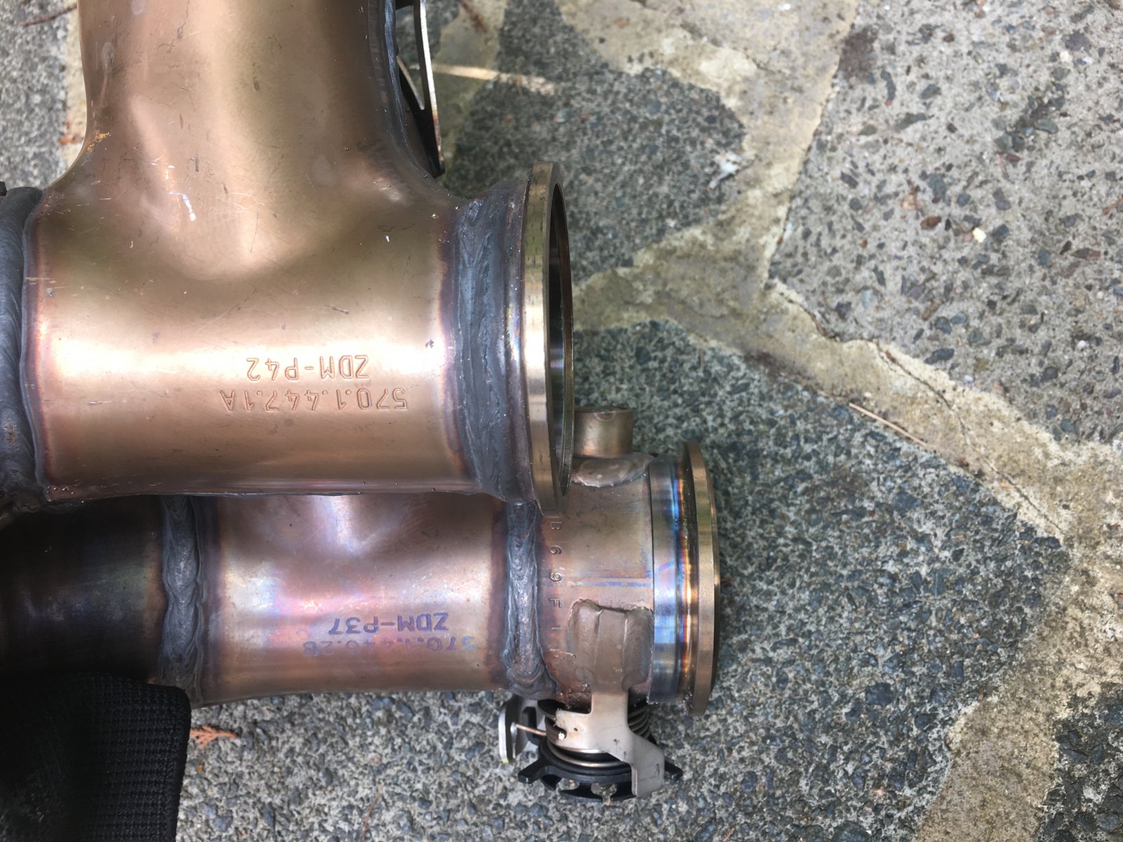

  16. Just thinking about it, unless it includes the link pipe (Y shaped) that joins the headers, then it won't fit. Unless you get a link pipe from the 1299. The 959 one is shorter because it doesn't have the flapper valve there, so it won't reach. Comparison below: IMG_9666.JPG
  17. Thanks for the answer! Then I need a 1299 link pipe to fit this exhaust.
  18. All the servo is gone the piece it mounts to with the heat reflective on I left. it's ideal to keep the eliminator and connector plug out of the way and a rapid bike unit would fit also I think
