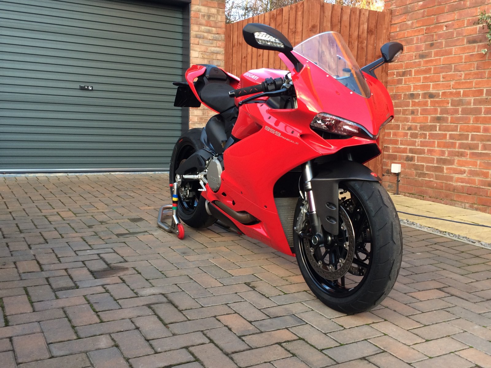

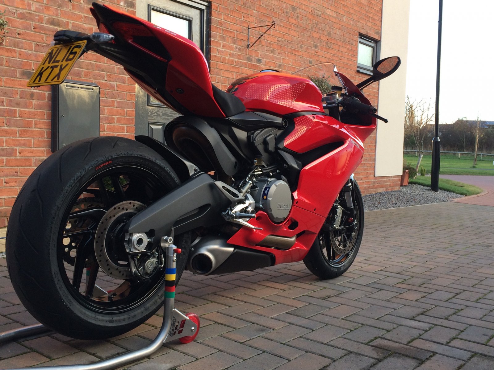

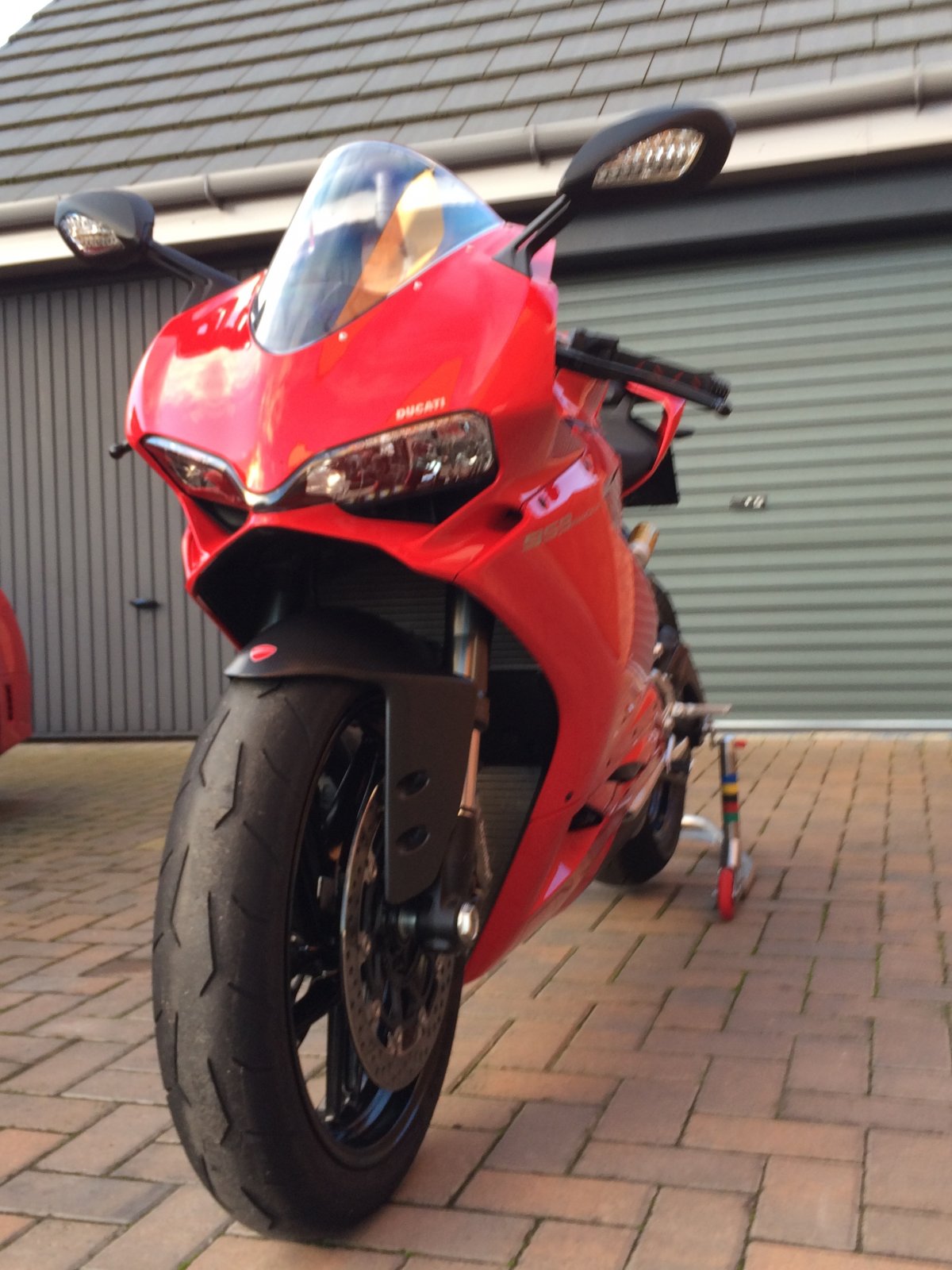

  17. Some inspiration for you
  18. Thanks for the advice and photos, your bike looks the business!!
    So did you leave the exhaust valve in place? and where did you get your healtech servo eliminator from?
    Thanks for the heads up regarding the swingarm to get the link pipe out, I might need more of your advice as I get into the project if you don't mind.
    Please let me know how it runs when you take it out next.
    Many thanks.
  19. The exhaust valve is still there but when you remove the cables fails safe to open so just leave it.
    I got the servo eliminator from HPS for about £35. I think Ducati sell one too.
    The servo is on the left side belly pan bellow the battery and attaches to the cooling fan cowling. It's straight forward to remove.
