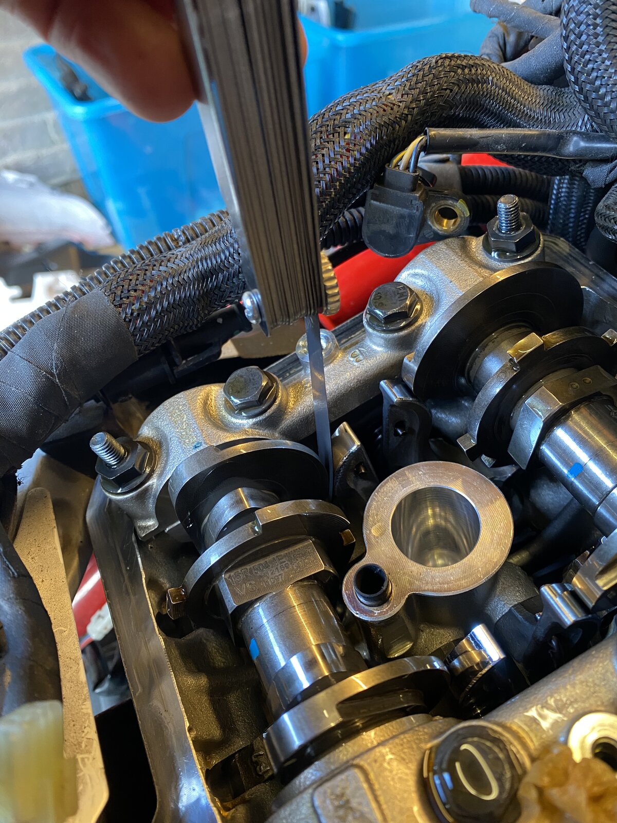

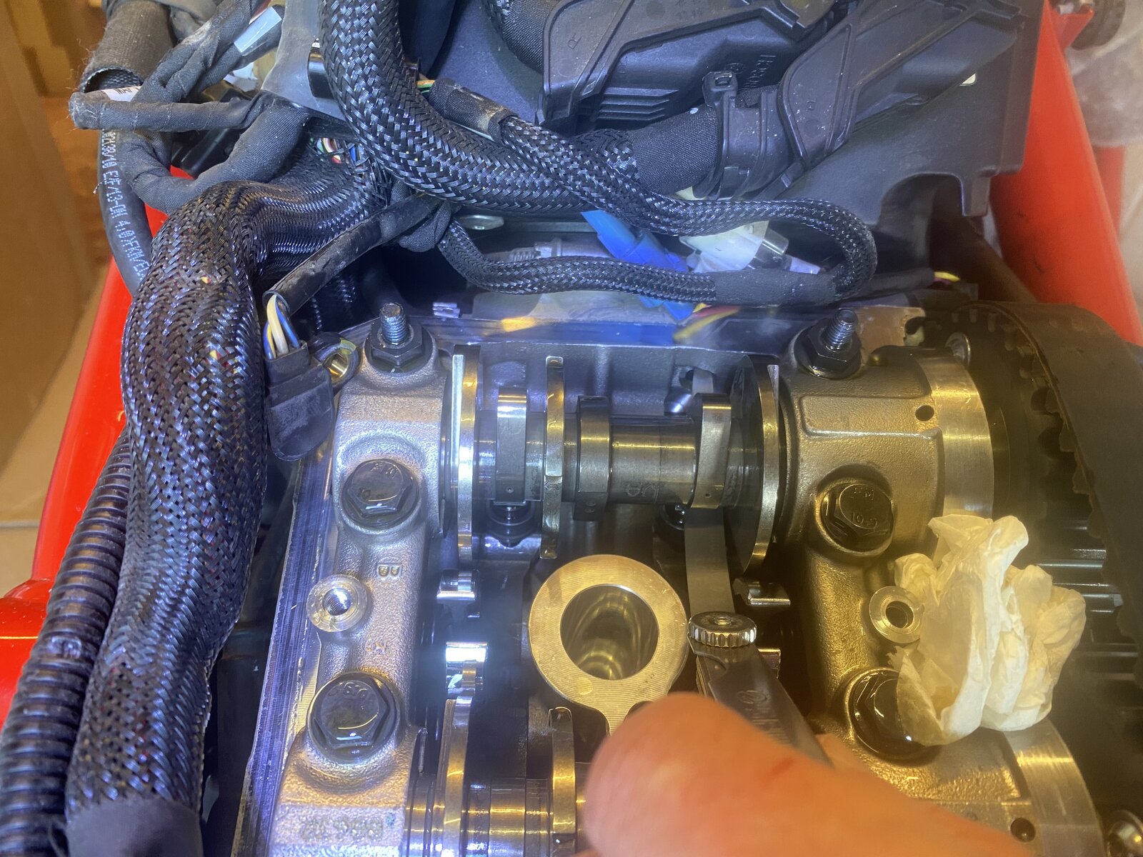

  2. Progress update... Valve Clearances Vertical Cylinder
    I managed to get an hour or two this afternoon to remove the cam cover on the vertical cylinder and have a stab at measuring the clearances. As the crank turning tool hasn't turned up, I removed the a spark plug from each cylinder and just used the back wheel in 1st gear (not sure why everywhere keeps saying it needs to be 6th gear) to turn the engine over and rotate the cams so I could position the camshaft lobes to what I assume is a correct position for clearance checks???

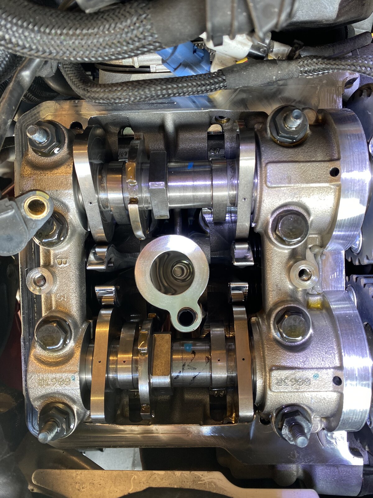

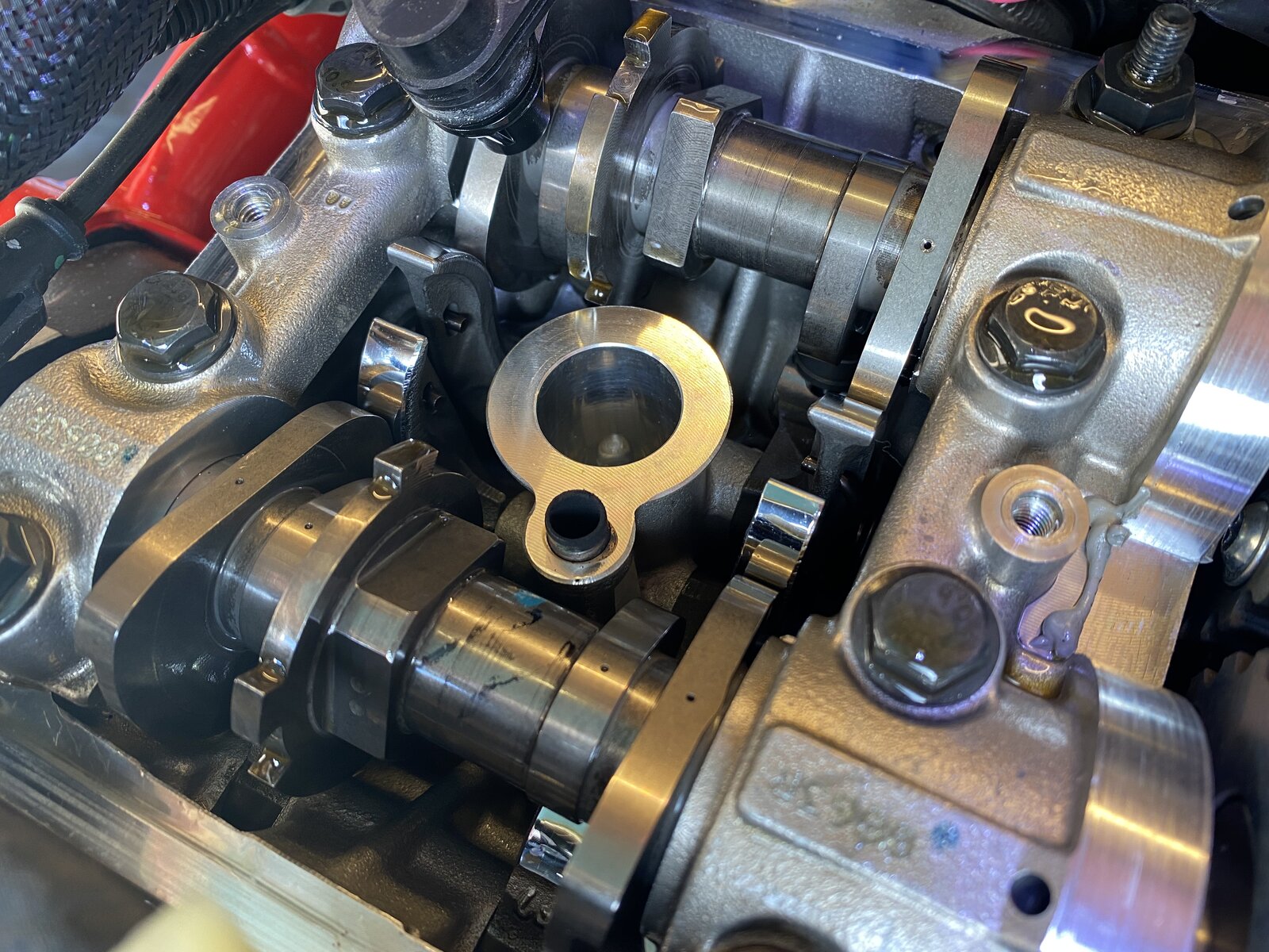

    I used these cam lobe positions for taking the measurements... IMG_0520.jpeg IMG_0521.jpeg

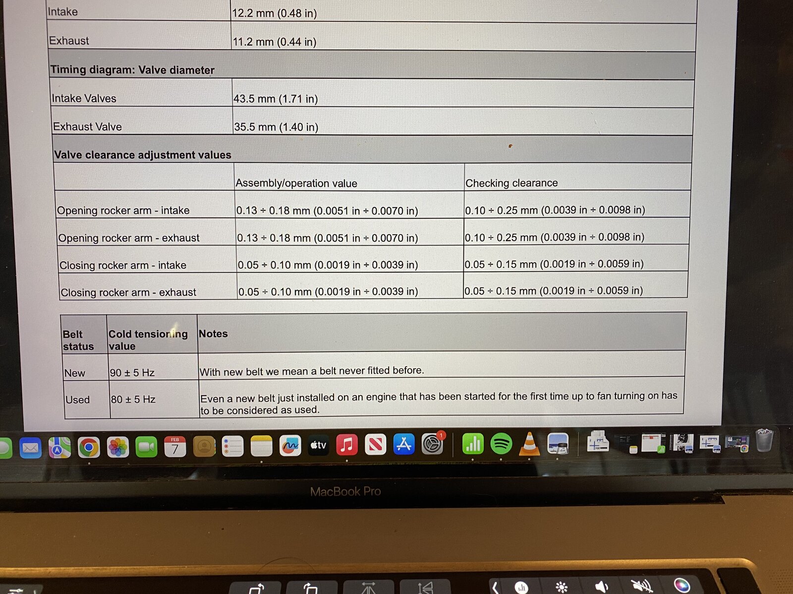

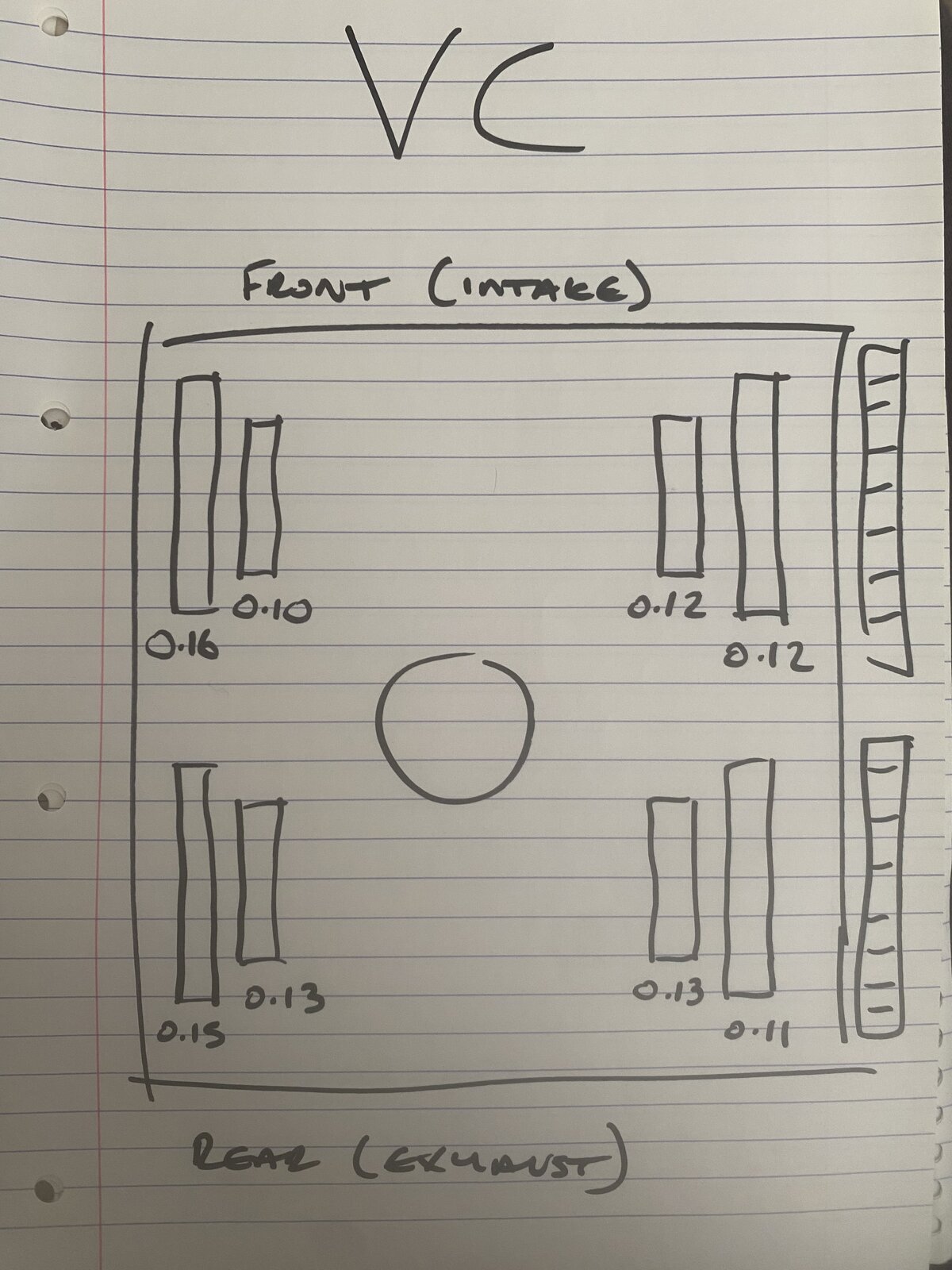

    Hopefully, if I've taken the measurements correctly the vertical cylinder is in good shape. The sliding shoes aren't showing any signs of wear, the closing lobes have no signs of wear at all, and the opening lobes have a very thin wear line through the middle. Not sure if that's normal for age and mileage?

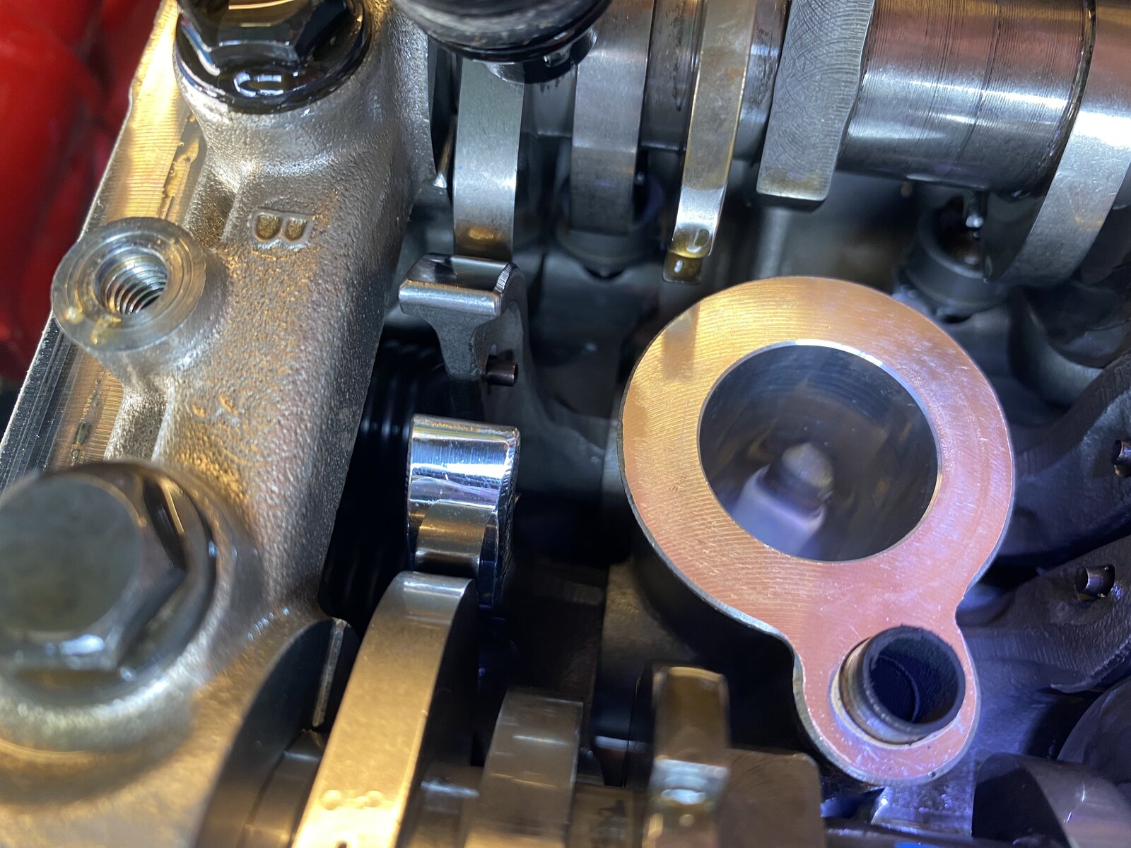

    As I've been turning the engine over by hand to rotate the cams, some oil has pooled in the exhaust area of the head around the valve stems & shims. Is that an issue?
    Plan for Saturday afternoon is to remove the radiator to access the front cam covers and carry out the same checks as today. All being well and with results inline with today, that'll close out the valve clearances.
    One concern I have when I get to the belt change is the oil build-up / pooling in the head. as I'll be rotating the engine many times to get everything lined-up, I image I'll see quite a build up of oil. does it make sense to drain the oil now and replace after the timing belt work or is it okay to have oil collecting around the valve stems & shims. The horizontal cylinder will obviously just push the oil out and towards the ground. I'll top up the oil as needed at the end of the service.
    I'll be keeping the cam cover off for now as I'll be putting the Cam Lock (Reaction Tool) on for the belt change.

    Also, whilst your clearances are presently in spec, some are very borderline and you may want to think about changing them. Over future miles the closer gaps will get larger and the opener gaps will get smaller. Admittedly, many would just say ‘that’s fine’ and button it up but you are quite close to the limit on some.

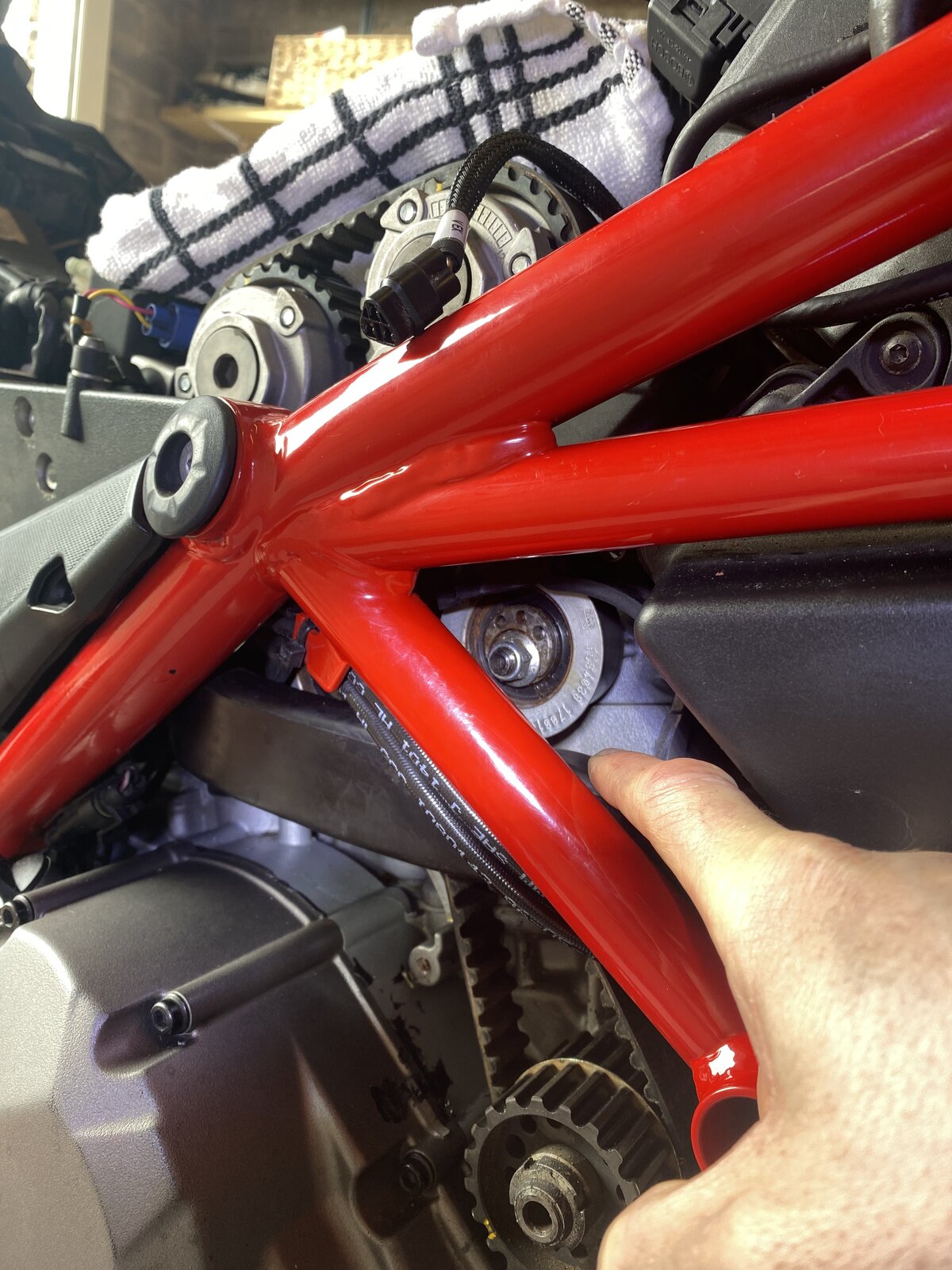

  18. A little progress made today...
    Looks like everything is lined up ready to bolt down the camshaft locking tool (Reaction tool) and then remove the belts. After testing this five times, the number of full turns of the layshaft to return to the position in the video is 27. Everything looks to be lined up correctly...
    1, Camshaft lobes match the reference images in the workshop manual.
    2, Camshaft section where the locking tool fits is flat/level. Allen key used/shown to check surfaces flush and tool would fit squarely.
    3, Punch marks inline with head flat surface, and marks made by belt change at 6,000 miles match-up.
    4, Crank / layshaft pulley mark lined-up.
    I'll be getting the radiator off tomorrow to remove the horizontal cylinder cam covers and spark plug to check for horizontal TDC matches with the setting in the video. Hopefully, then be able to lock the crank, bolt down the cam locking tool, and get the belts changed.
