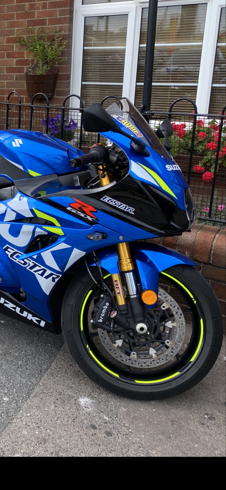

    Got the guys doing the bikes first service to pull the forks through 10mm (more flush) and MY GOD what a difference.
    Bike feels so much better. SO SO SOOOO much better. More stable. More sure footed. Holds a line better. Less nervous. Smoother. More fluid. Better under braking. Better rider ergo's.
    PLEASE - If you own one of these, pull the forks through. You will thank me.

  8. Pulled through mate. I.E less fork out of the top yoke. Or in other works raising the front of the bike.
    Lowering the front would make the front more pointy thus more skitish dude

  12. I was thinking the same. Honestly mate the stock set up feels like it's lowsiding in to turns all the time. It's way too nervous.
    This still turns really well but feels much more stable and less bum twitchy doing so.
  13. I rode back from the dealer after they did it and seriously couldn't believe the difference.
    In my mind there is absolutely no draw back to this. You can call me a dickhead if you don't like it i'm THAT sure you will prefer it!

  20. The bike turned too quickly on the road for me. It felt like the front was folding in tight turns and I had to pick it up on the gas a few times.
    It's an easy mod and if you don't like it simple to put back to standard. I've dropped mine through half of what was showing above the top yolk and it felt loads better. If I feel the need as I get quicker I will drop them through to flush.
