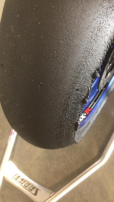

  11. I had great tyre wear after Colin had done the setup after the first session. This is after the second session. Near perfect.
  12. That looks pretty clean :upyeah:
  13. I was pretty pleased with it considering it's standard suspension. It looked the same at the end of the day as well although I didn't do many laps through the day.
  14. It’s impressive stuff for standard kit isn’t it!
