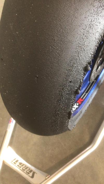

  4. I discovered on Saturday that my Cold Tear issue was down to my pressure gauge been 4 PSI out. I couldn't understand how i needed to be running so much lower than everyone suggested and had to just keep lowering and lowering. I had 4 pressure monitors borrowed from other TD'ers at Mallory all lined up so I could check which was correct and which needed to be in the bin.
  5. Thats potentially an expensive gauge error! I had a new lad doing pitcrew a couple years back who gave me 2.5bar instead of 25psi in the rear. I got halfway around Oulton Park and highsided on the chicane!!
    • WTF WTF x 2
  6. 36.2594 PSI!!!!!!!!!!!!
    yeah, it's now in the bin, luckily for me it's just cost a few early tyre retirements.
