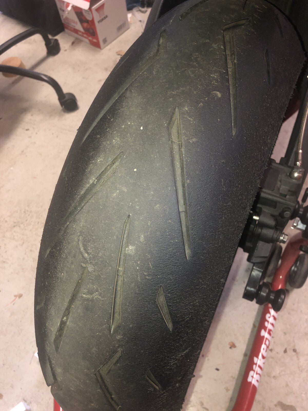

  1. I have Rosso Corse 2’s on the track bike as “damp” day tyres currently.
  2. have heard good things about those as well.
  3. They are very similar to S22s to me. I only got them as the S22s were out of stock last year.
    These have done about 1750 road miles, Ducati day Donny in about 34degrees and Silverstone this month in 9 degrees.

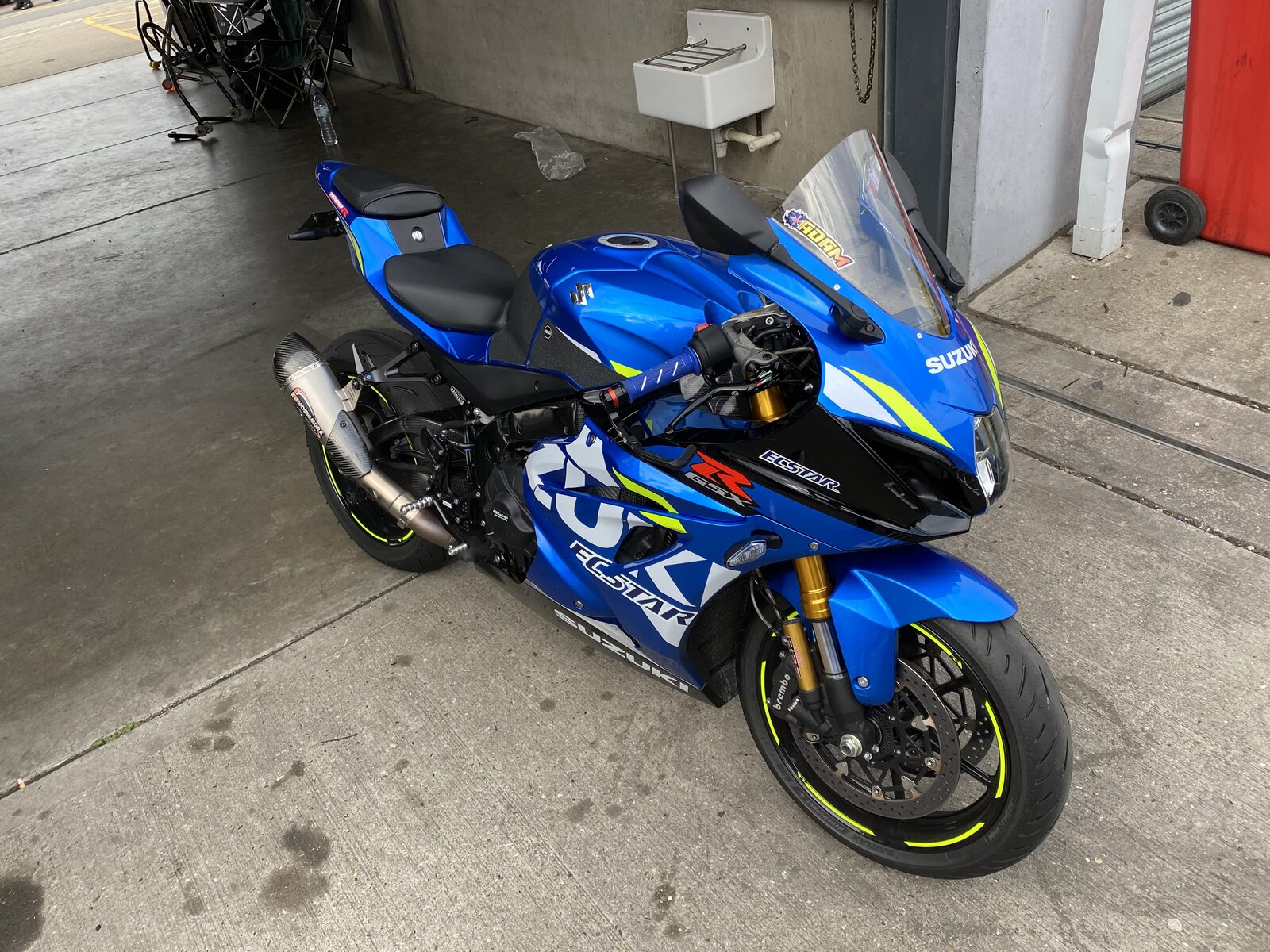

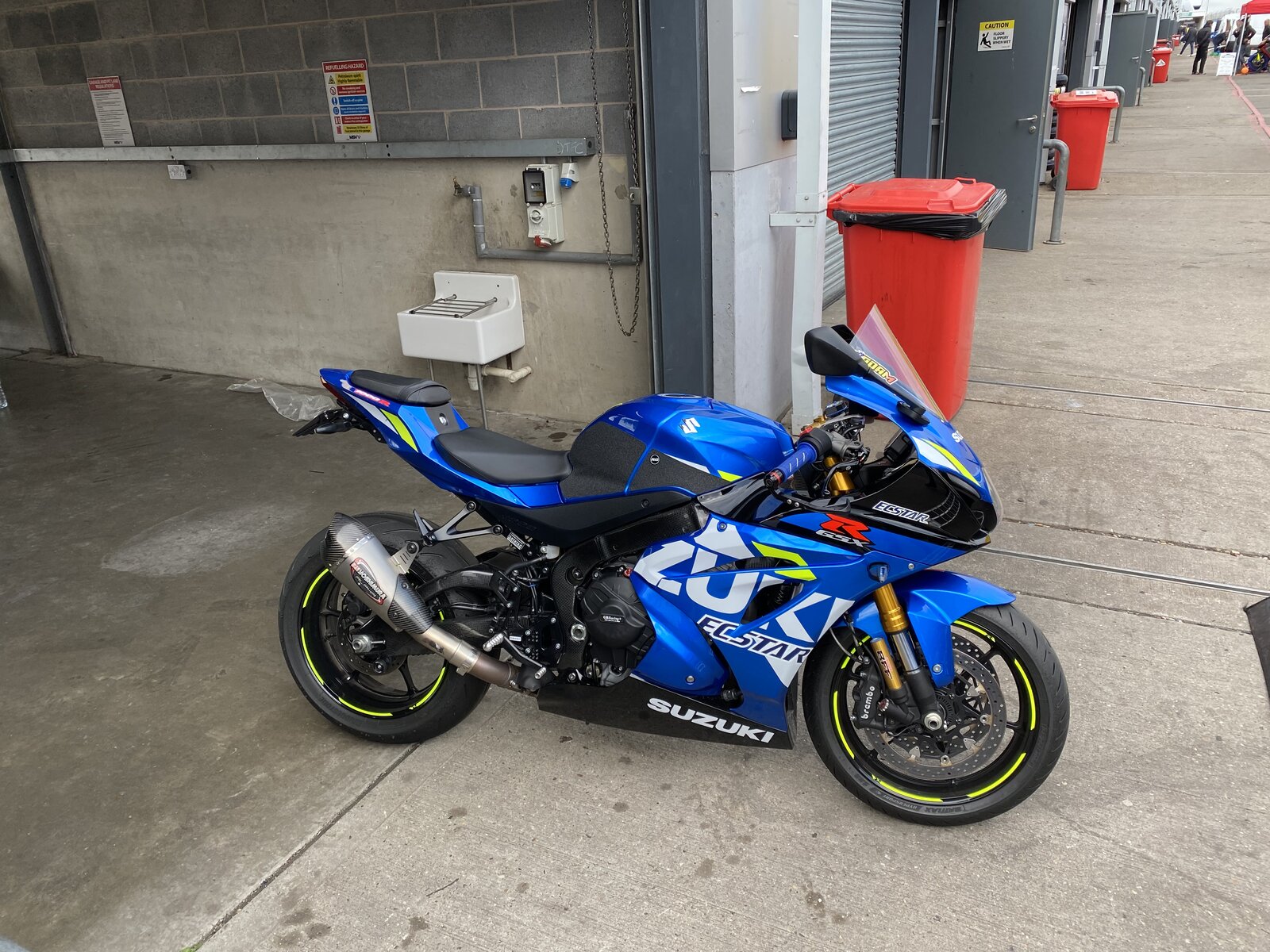

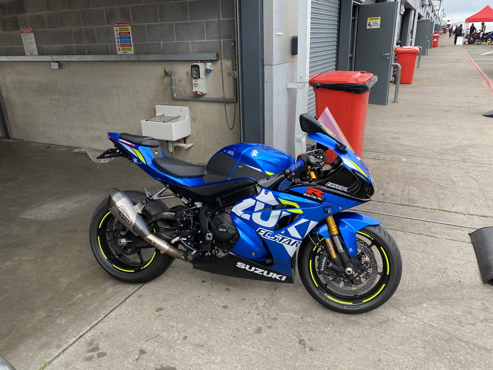

  4. Some randoms and a little update.
    I changed the pads from the stock items to some sbs sintered jobs before Donington.
    this has sort of helped in a way, the pads have a much better feel and more bite. However it’s fairly misleading really as the potential braking power however good that it ‘might’ be is unusable as the abs still kicks in with very minimal lever. They are more consistent though which is nice.
    what this has proved to me though is the problem with the gsxr brakes is 100000% the abs. I’ve got so much lever and braking power left that I can’t use! I might have the abs off soon (probably end up over the bars) :laughing:
    I’ve had to adapt my braking style, essentially braking much earlier and for much longer which isn’t ideal as it cooks the disc. However it sort of works. Not a lot of confidence under braking though which is a shame because braking was always one of the things I was good at.
    It’s not fun lunging anyone on the brakes though as the bike genuinely does not feel like it’s going to slow down. I rely a lot on engine braking.
    This was on road tyres though, it may well be better on slicks.
    I’m also having quick shifter issues again. I’ve not had any extra blips since I changed the rear sets. HOwEVEr .. about once or twice per session I am experiencing delays in power between shits. For example.. full power, clip up a gear and the motor just goes totally flat, then comes back gradually and surges. It’s 100% the Quickshifter aswell. Apparently perfect chain tension helps this, but my chain was adjusted before Donington.
    I tend to think that the stock QS is a bit... shit
