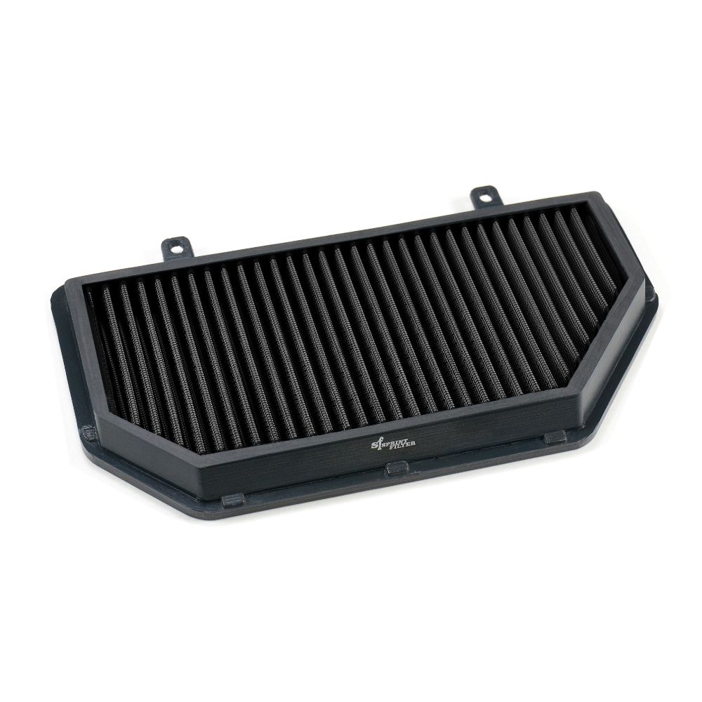

  3. EBC GPFAX Pro are the business - ignore detractors.
    Sprint P0851-85 is also the only way to go with filters :upyeah:
  4. I ran a sprint on the dyno back to back against stock and the big daddy mwr on my old race bike.
    the only filter the bike made anymore power with was the mwr interestingly. Probably why most of wsbk use them tbf. Things like stacks make a bigger difference.

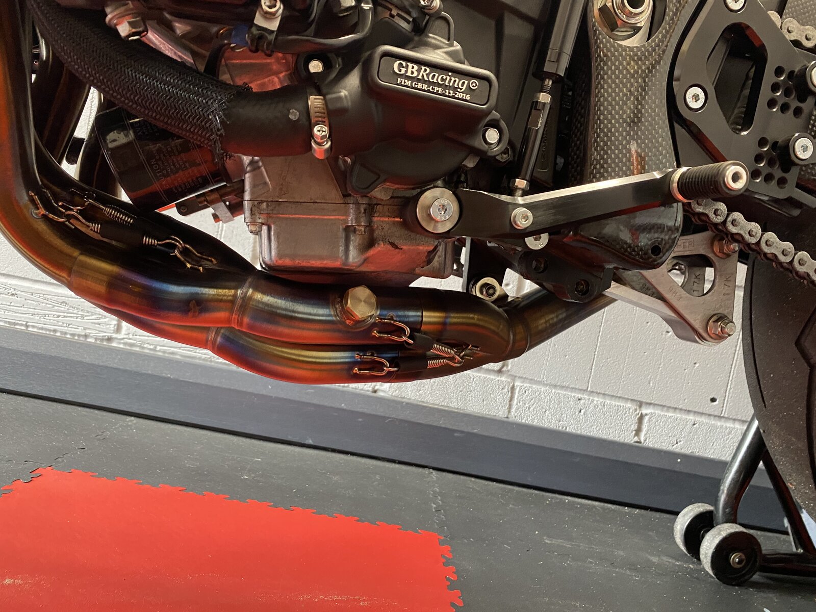

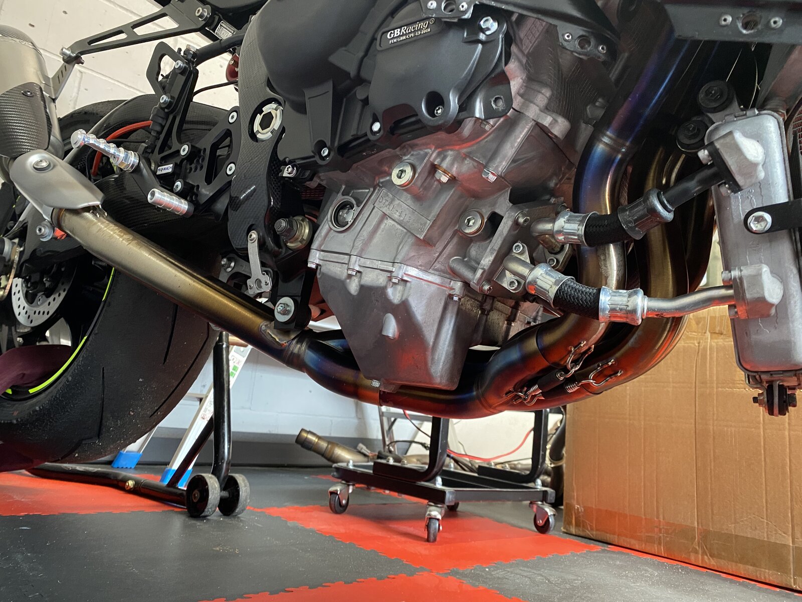

  7. Thought you’d enjoy this
    BBDCB439-7FCA-4A46-9F1B-FEA51863AFA3.jpeg 2D6D7CC5-D6C5-4F5E-A106-02BA83660493.jpeg
  8. Thanks for that. Not much clearance for the link pipe! I'll post some pics up as I fit the new system/filter/probs velocity stacks!

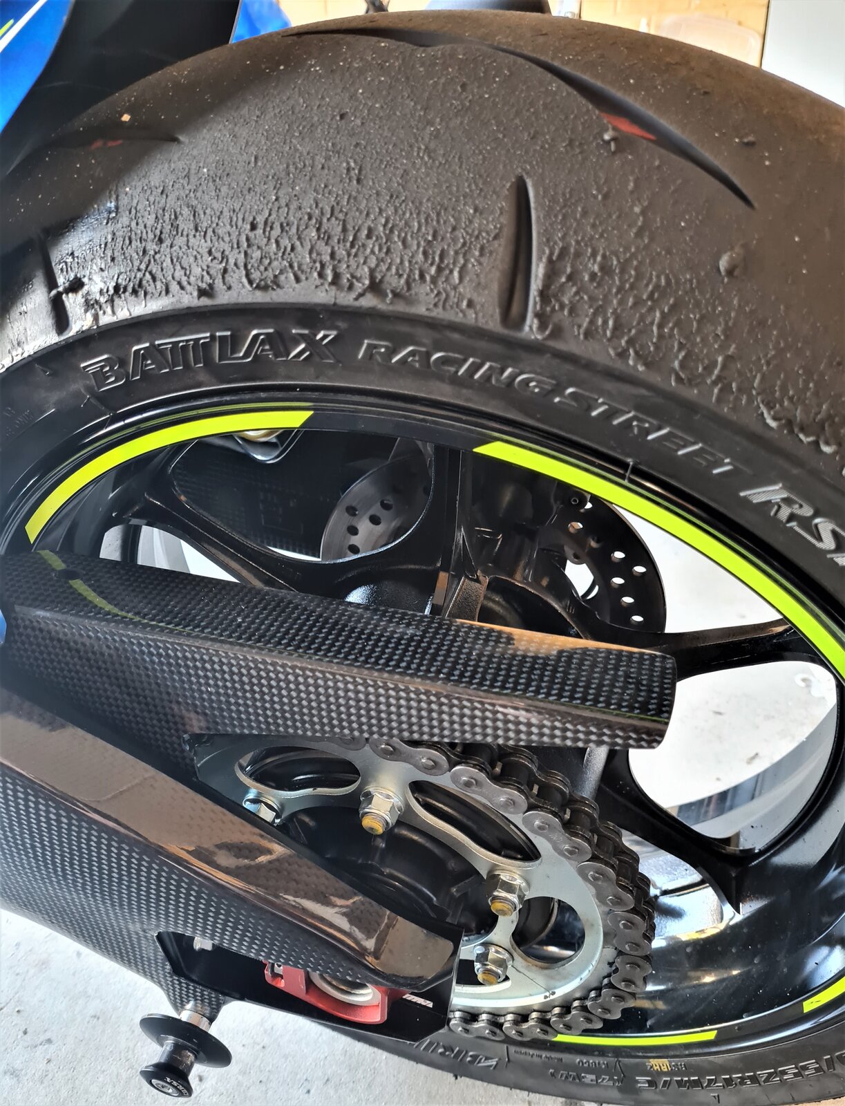

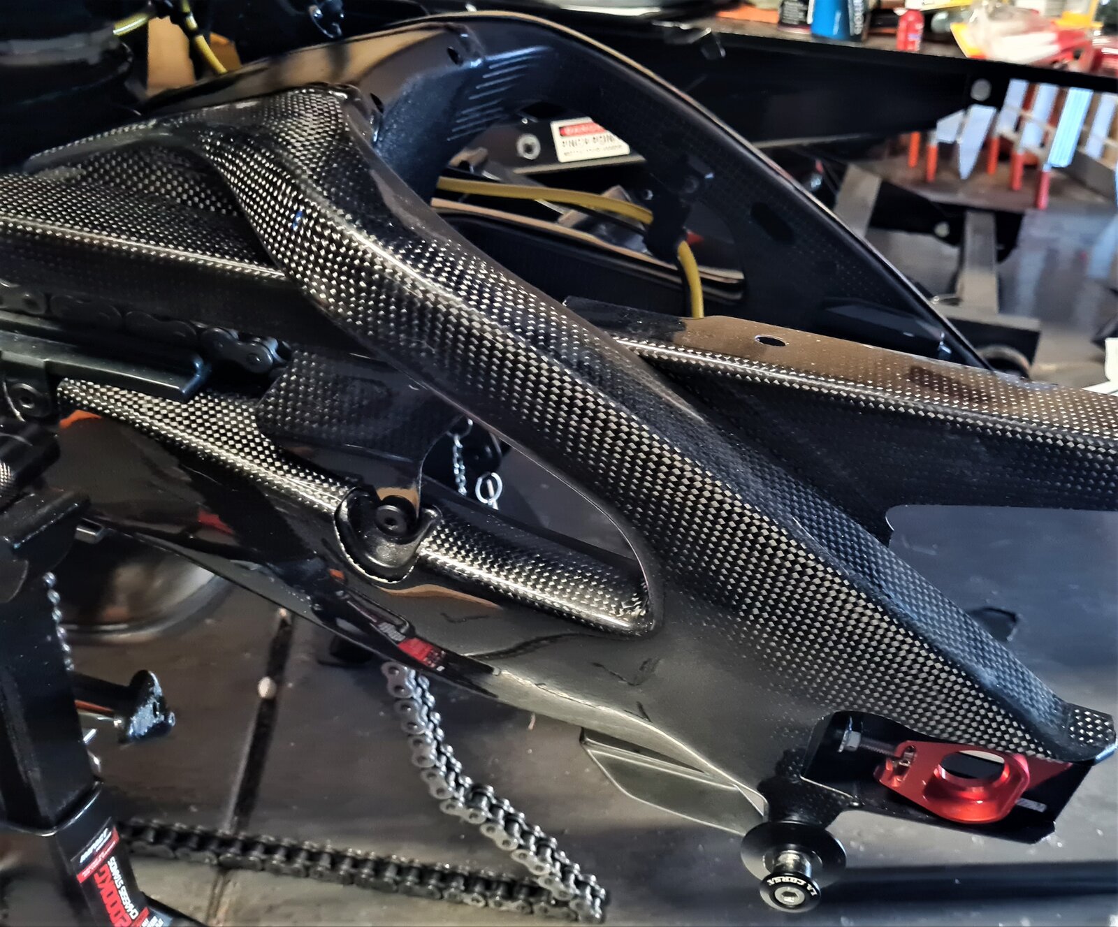

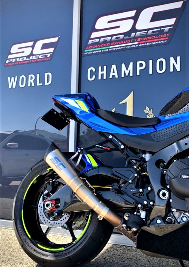

    These are a few of mine.
    CF Swingarm (2021_03_29 11_03_35 UTC).jpg At SC Project 2 (2021_03_29 11_03_35 UTC).jpg Rear tyre Collie (2021_03_29 11_03_35 UTC).jpg Collie#22 (2021_03_29 11_03_35 UTC).JPG Best together 2.jpg

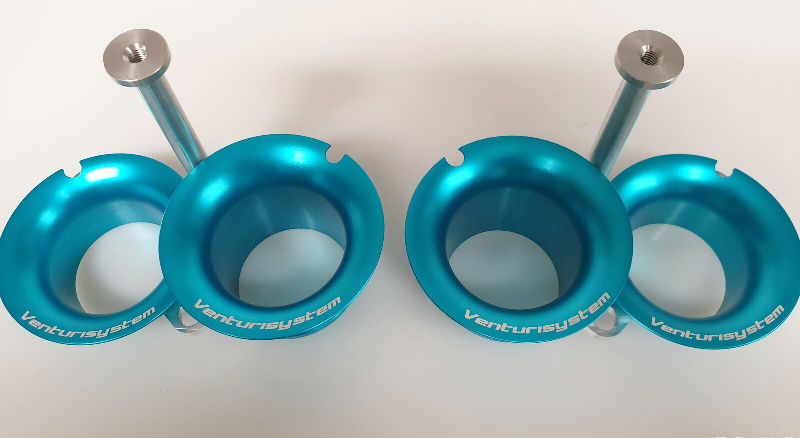

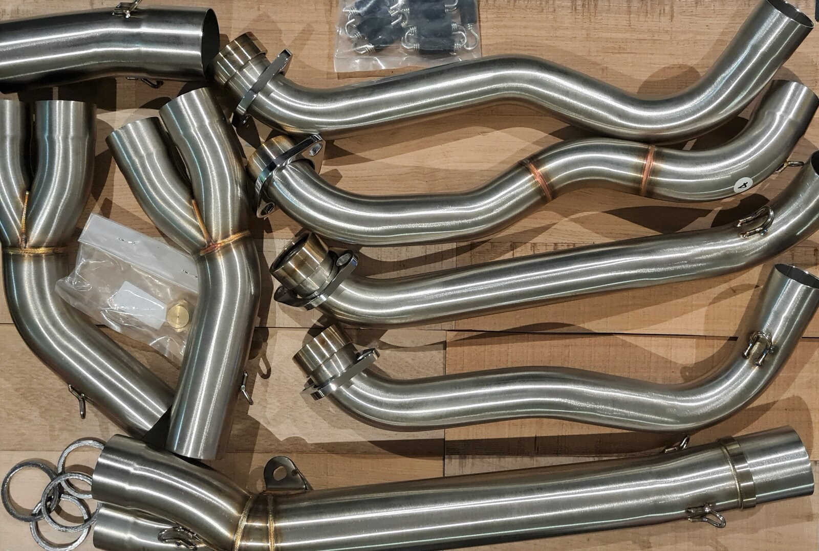

  9. The goods have arrived ... my tuner is booked until September so just going to stare at this stuff for a while ... :(

    What can you running? That SC will be superbly loud :heart_eyes:
  11. Yeah planning to hook the new system to the SC Project pipe. We don't have noise limits here as there are only 2 tracks within reach of Perth and neither has residences anywhere near. I'll just firmly plant the plugs in the ears.
    Question #268: Would you fit the system/filter/stacks (or one/two of those) knowing that the bike is not going to run optimally until you can get the thing tuned - or wait on?
    Question #269: when taking off the OEM system did you just disconnect the cables plugged into it at the exhaust and also to wherever they lead (technical term :laughing:)?

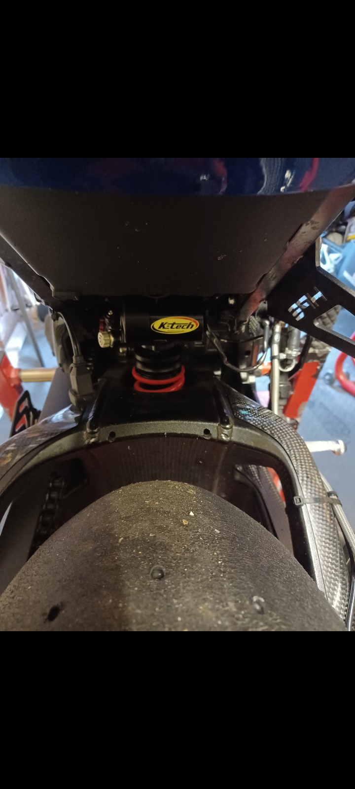

  12. Fitted the kteck shock. Forks have had the cartridge kit fitted but cant pick them up till Wednesday Screenshot_20210731-191710_Gallery.jpg

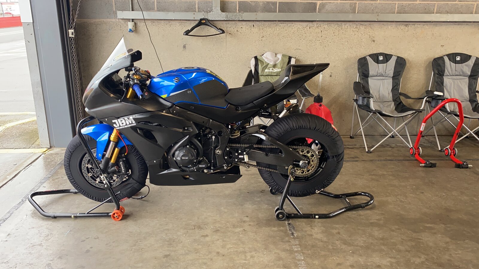

  13. Slowly getting back to grips with riding again and learning the Suzuki.
    got down to low 40’s at Donington on a two day old Pirelli that was past it’s wear markers which I am happy with.
    Bikes lovely to ride, excellent chassis. A lot to work on still but it’s a nice situation as a lot of the areas of improvement are fairly obvious :)
    had some great battles with a couple of bsb riders in the morning. Naturally I got smashed by the faster of the bsb lot, but was great fun regardless.
    Gpfax pads sorted the braking issues out. Still getting a bit of lever travel but nothing I can’t manage. They’re good enough for where I’m at, at the moment.
