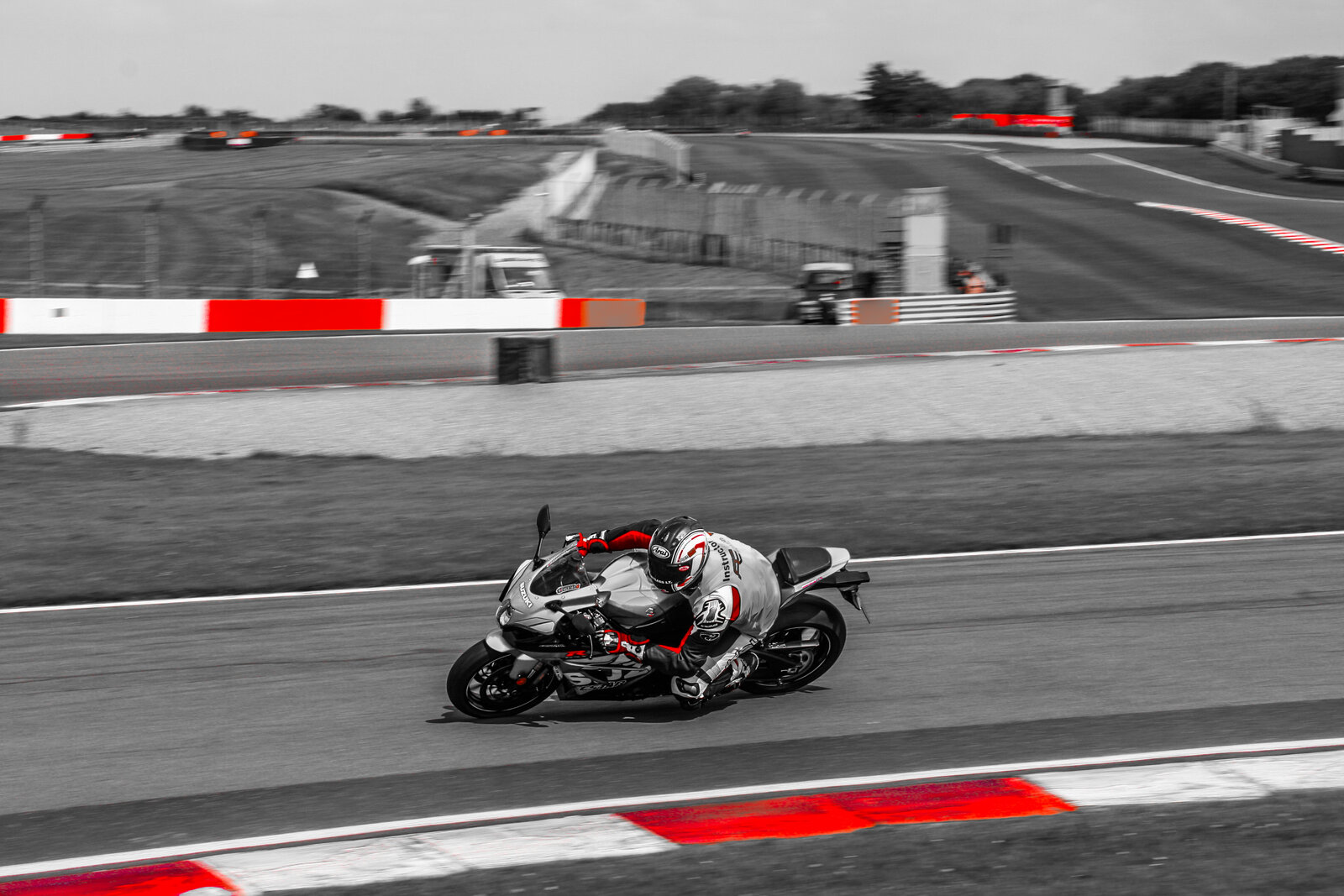

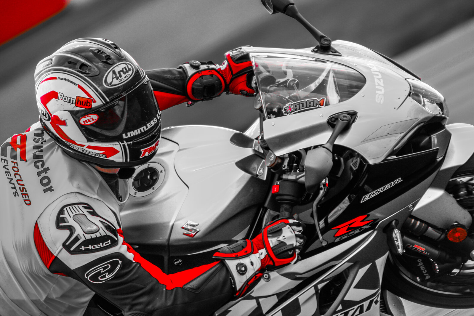

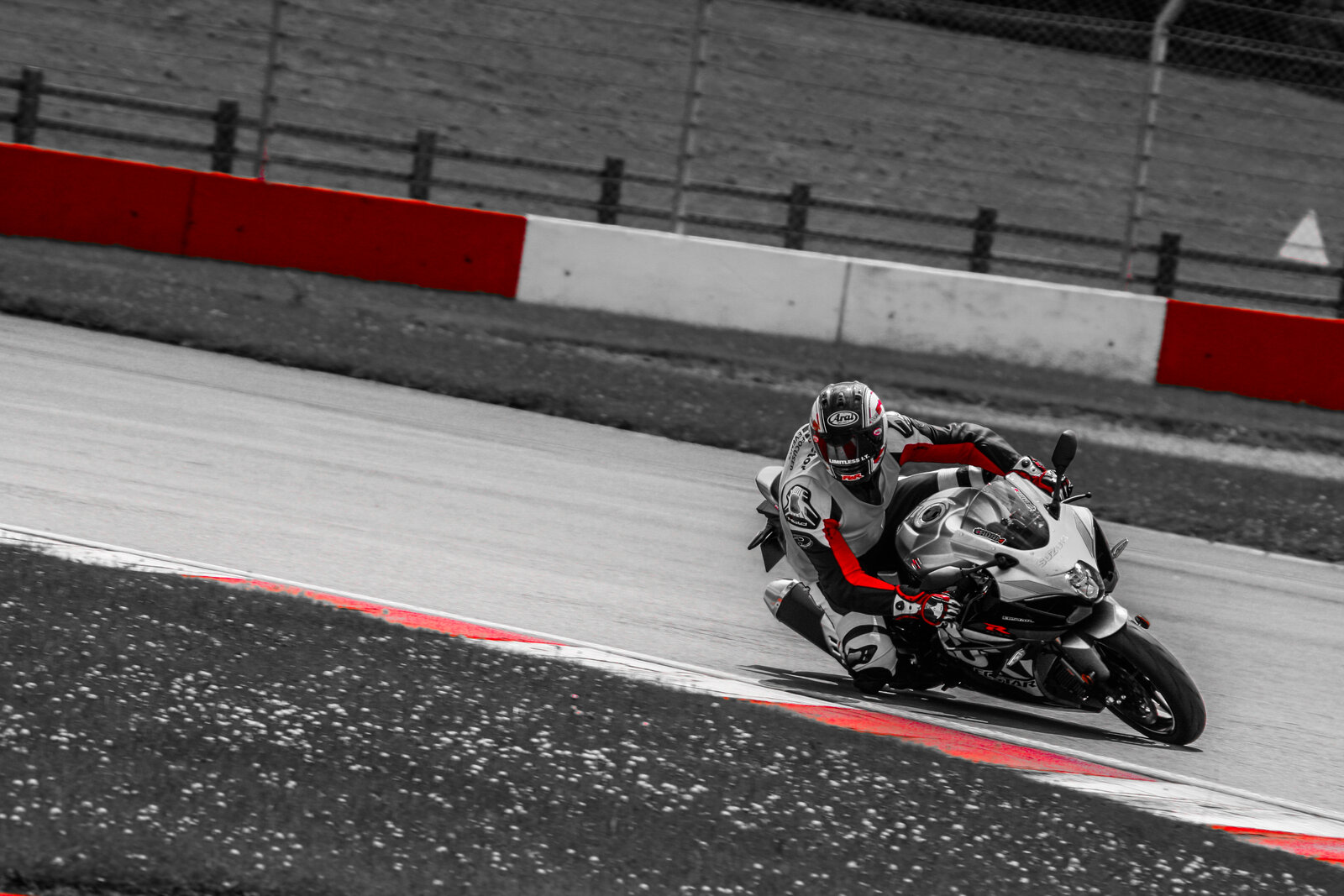

  1. Tyres nicely scrubbed there sir :upyeah::motorcycleduc:
  2. Sound slike a good follow on thread form this to me :upyeah:
  3. I didn't think a fella your age could get his knee to bend that far! :joy::joy::joy:
    Looking good matey :upyeah:
  4. Yes please.
    You look very Craferesque in the pictures. :D
  5. Bit of a funny set up mate. Drop him an email!
  6. still learning the bike mate and not got 'the feeling' from it yet so I'm a bit wooden on it still :)
  7. I meant the pointing I wasn't criticising body position. I'm always crossed up in all my pictures.
  8. Bloody aching yesterday and today as a result. Like you say, getting old (disgracefully).
