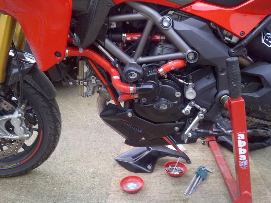

  5. Paul if wont come ride with me will you at least post a pic of the new pipes :biggrin:

    Here is the photo you are looking for. Note you can't see any pipes from the off side.

  17. Have to say, those red hoses look trick, my letter arrived last week so I may swap the hoses out while the bike is ""empty" as it were.

    really nice those tubes....I like it! Was going to suggest we go out today.....but it's peeing down, and I did promise not to take you through the waters again! Am away for the next two weekends, but let's think in terms of the first Sunday in march! Perhaps by then spring would have started to kick in:tongue:
