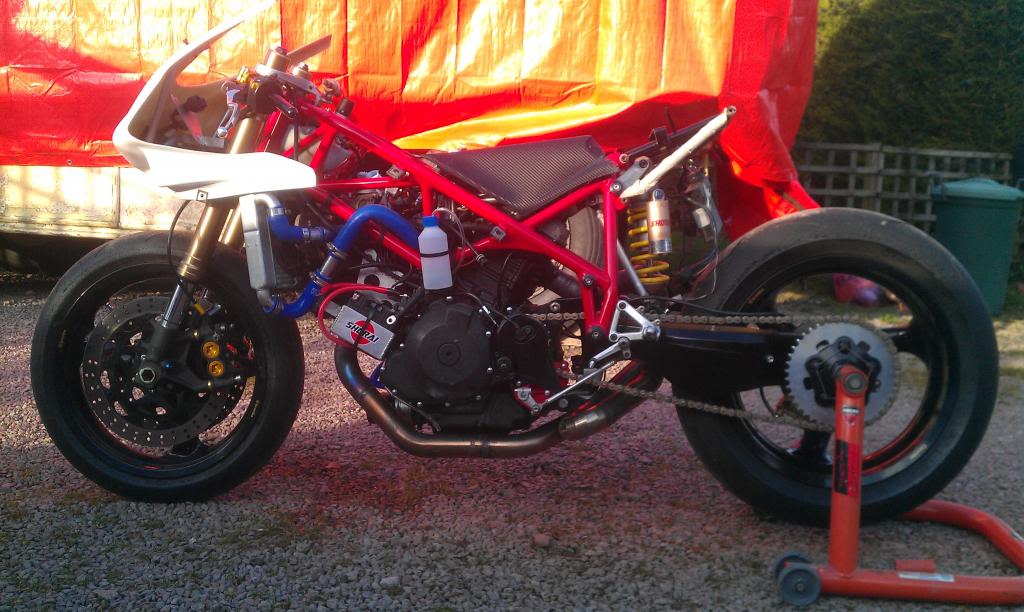

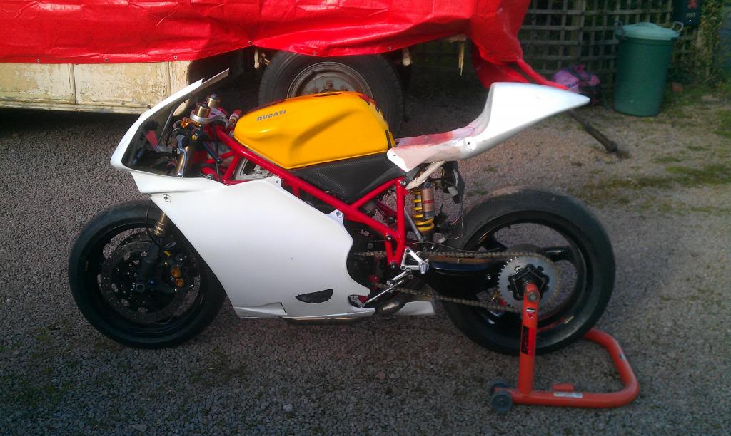

  17. Bit of an update, got the radial callipers fitted, airbox finished and most of the body work is complete.
    Next job is to secure the ECU and fit the side stand.
    Had a insurance quote today, with everything declared came in at £201. Happy days.
    finished airbox, and what a pain in the ass it was aswell.
