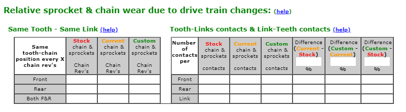

    In an ideal world you want your sprocket teeth to land on a different link every revolution. You can use https://www.gearingcommander.com/ to work out how often this happens. This is the section you need, read the "help" parts.
