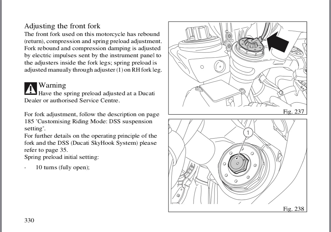

  9. firstly I must apologize to anyone i may have upset with my comments. I have had an in depth conversation with Ducati this morning. They tell me that anyone who buys a Pikes peak manual Ohlins to go to a specialist to get the bike set up for them as it makes a huge difference. I.E riding style, weight etc. Ducati specifically say that the Skyhook is not required any adjustment apart from the electronic settings in the menu. Also if anyone wants to up the preload then that is fine. Only that if you set the preload at the front the bike will automatically rise at the rear. The company does a yearly ride out in Italy around mountain passes with all sorts of riders including some very experienced guys. Not once have they ever altered the front preload. If they want the bike firmer they do it in the menu. In there words, if you have turned your front preload in by 5 turns we recommend turning it back out to just 1 or 2 turns. They also state that the only thing the right preload does is raise the bike & some riders may prefer this. If a person is on the large side then they say sw to 2 rider mode. Or experiment with menu. I know some of you guys say yours is better now & that is great for you. I feel much better since the doctor gave me a smartie for a headache. Placebo effect & all that. To set up suspension properly look on youtube & see all the measurements they do STATIC SAG etc etc. Not needed with Skyhook. Ducati,s words not mine.

    I've had a suspension company do the static sag measurements and once they applied the pre-load based on those values (5 turns front, 16 rear) I had a sweet handling bike. Strangely the best guess by Skyhook was completely different and did not compensate for the factory half a turn on the front and less than average handling. I'm not knocking skyhook, now that the manual Setting of front and rear preload is right, the active damping is superb. That is what I expect because skyhook only deals with active control of compression and rebound, loads of stuff on the net by Ducati on this, even states it in the user manual, page 35. Until I see something from Ducati's chief Engineer that skyhook means you don't need to mess with ANYTHING on the suspension I'll take the traditional route.
    But..... the bottom line is, if you are happy with the handling of your bike by whovever/whatever method that's what counts :upyeah::beer:
  15. Honestly lads, do what ever you feel is correct, the bikes have a manual adjustment for a reason and it ain't ride height. What's pre-load usually for? Skyhook can only adjust compression and rebound, so you still need to set pre-load. But again, do as you wish and enjoy.

  17. And you set the rear preload so why not the front? Don't get it.
