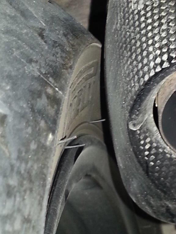

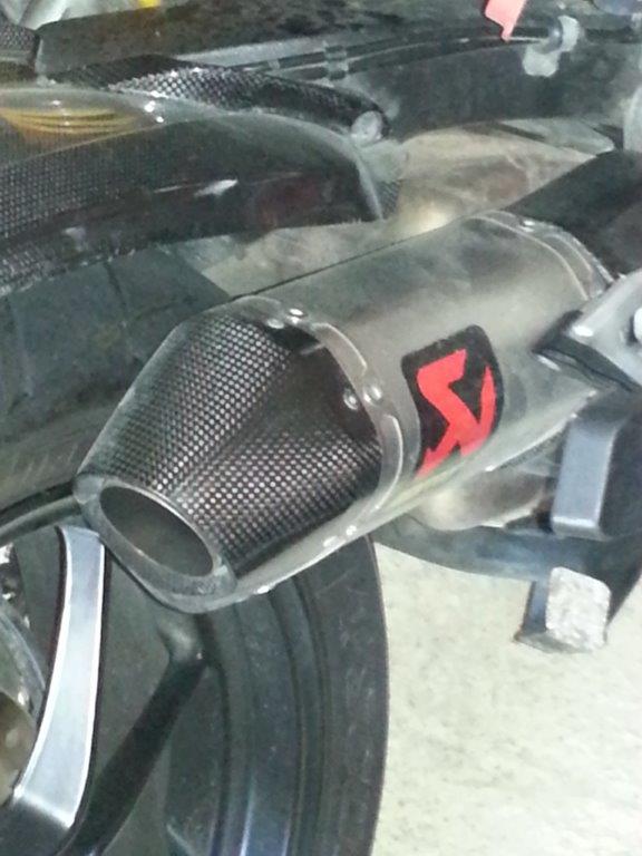

    Does anyone know how wide the silencer can be without fouling the tyre/pannier guide?
    Not a lot ! Clearance for the pannier is better. Andy
  7. Yep, stock Scorpion and no damage to the tyre or the can evident so far. It's the only can Akrapovic currently do for the Multi and without a measuring stick 3.5 inches ish. Mine has never looked like the picture in the fitting instructions and when I had a 50 profile Angel fitted there was no chance the can would fit. Spoken a lot with Craig and Phil at Moto Rapido and they say a number of the after market cans they have tried to fit for customers are a bit hit and miss. I'm waiting for SC Project to announce their offering for the Multi in September or I just might try a Quat D which some on here rave about. Andy
