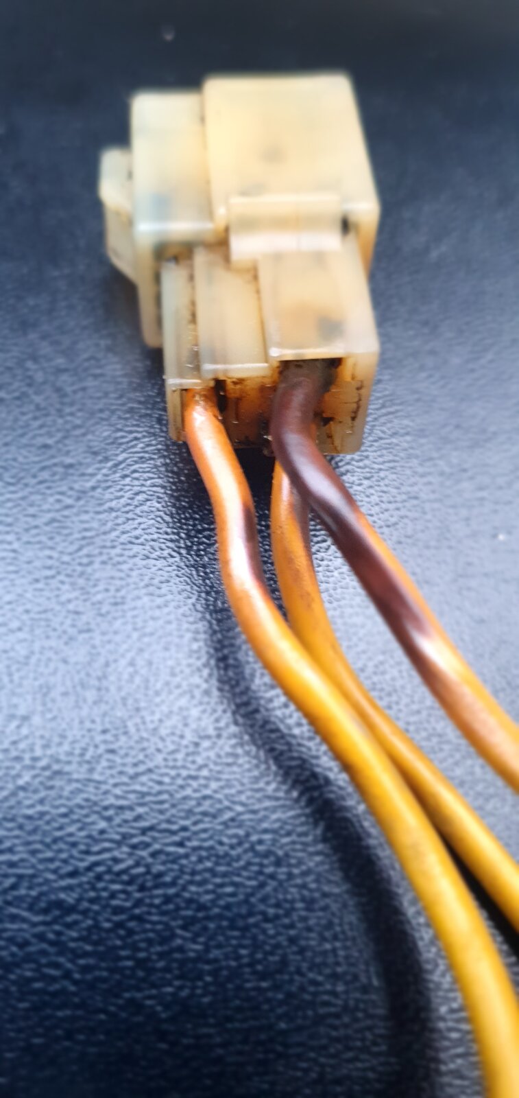

  1. Well after that energetic intro I’m feeling disappointed now with the bike.
    Hopefully once you get her sorted she will redeem herself

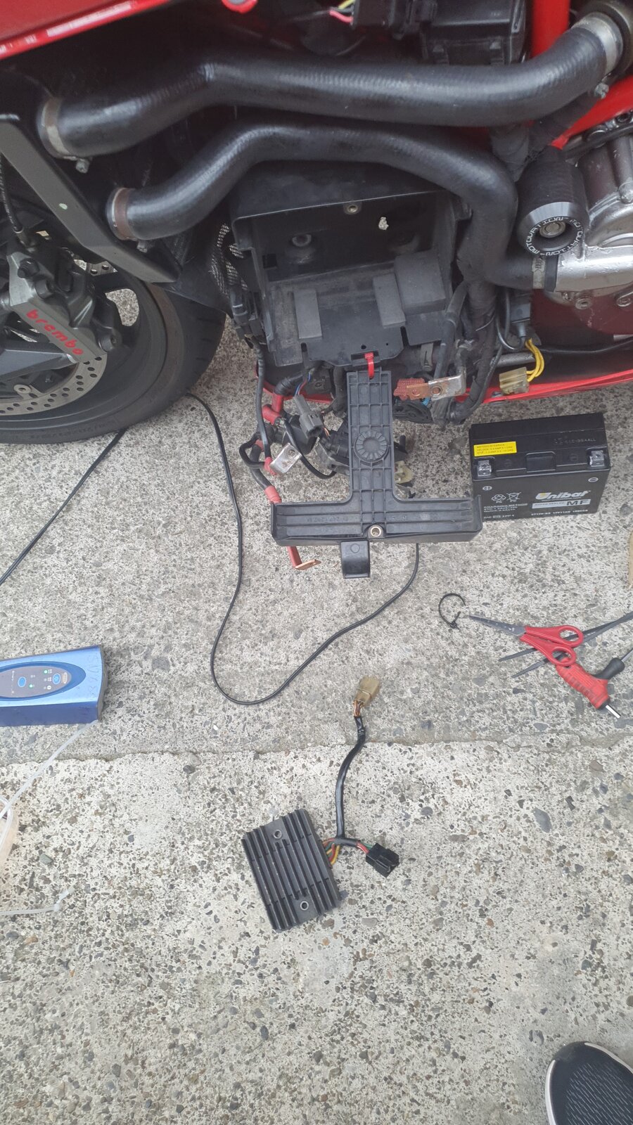

  2. Well it appears it may have been the reg rectifier, I have thrown on a used oem one, we will give that a go today.
    Will head out with the gf on her fireblade for some grub, hopefully the bike plays ball and restarts when it needs to
    I had used it Friday night but by Sunday the battery was kerplunk. This is before fitting reg rec last night
  3. I need to order a new uprated REG rec, it's not all 100% , the battery ( lead acid) needs to warm up it seems , as you with a cold lithium battery . But at least it's starting and somehwat holding a charge .

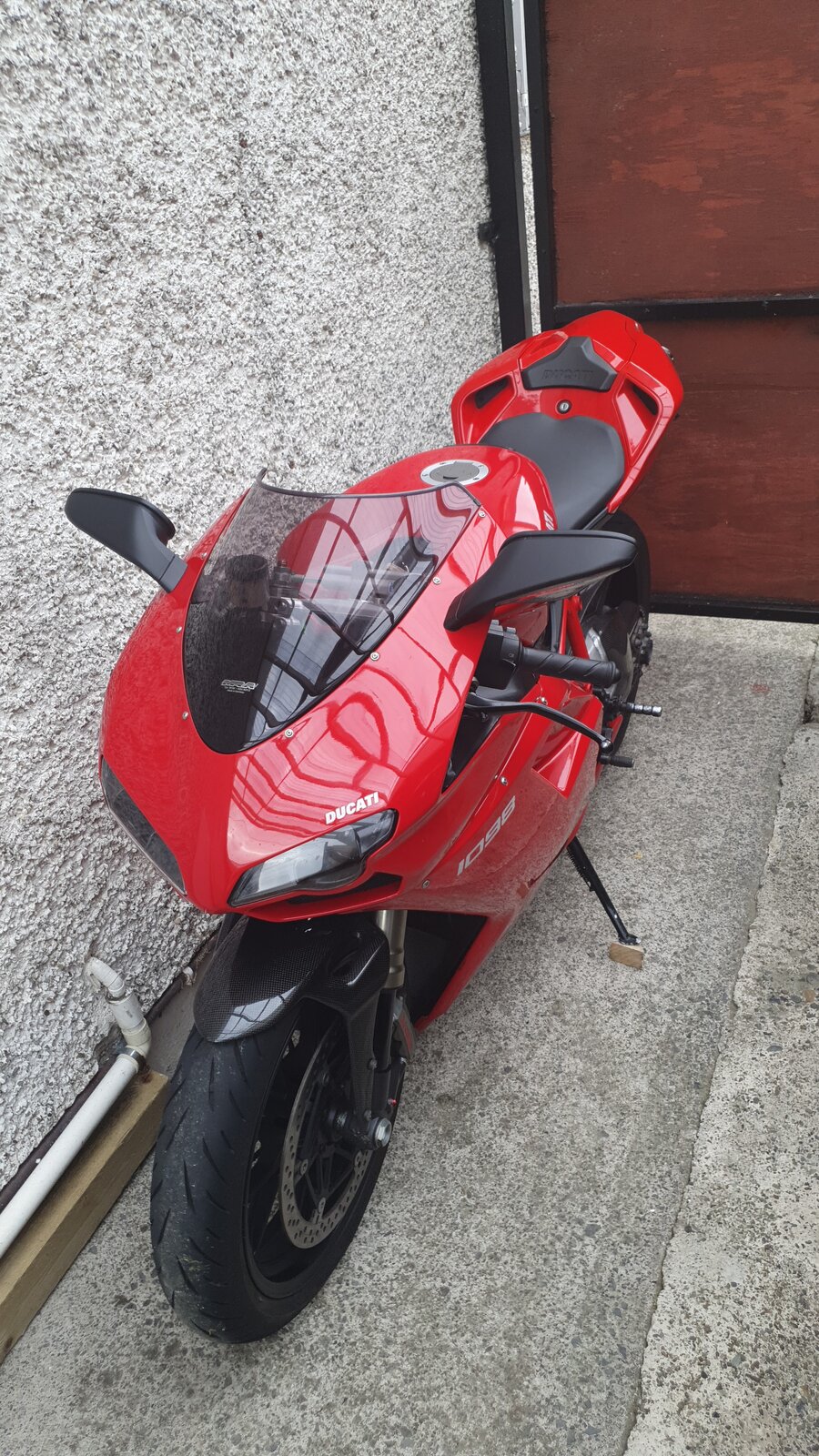

  5. Had a call from a buddy yesterday who is a dab hand at electrics, he used to make wiring looms for Monstermob Ducati and Alstare Suzuki
    anyway , he has directed me to try 4 things
    bypass starter solenoid , go direct from battery to starter motor, see if it spins, go direct from battery to engine or frame from negative terminal , see if its a bad earth, take of starter solonoid check terminals for corrosion (valet ) and lastly connect bike/ battery up to a non started car battery
    he reckons again, its the battery .

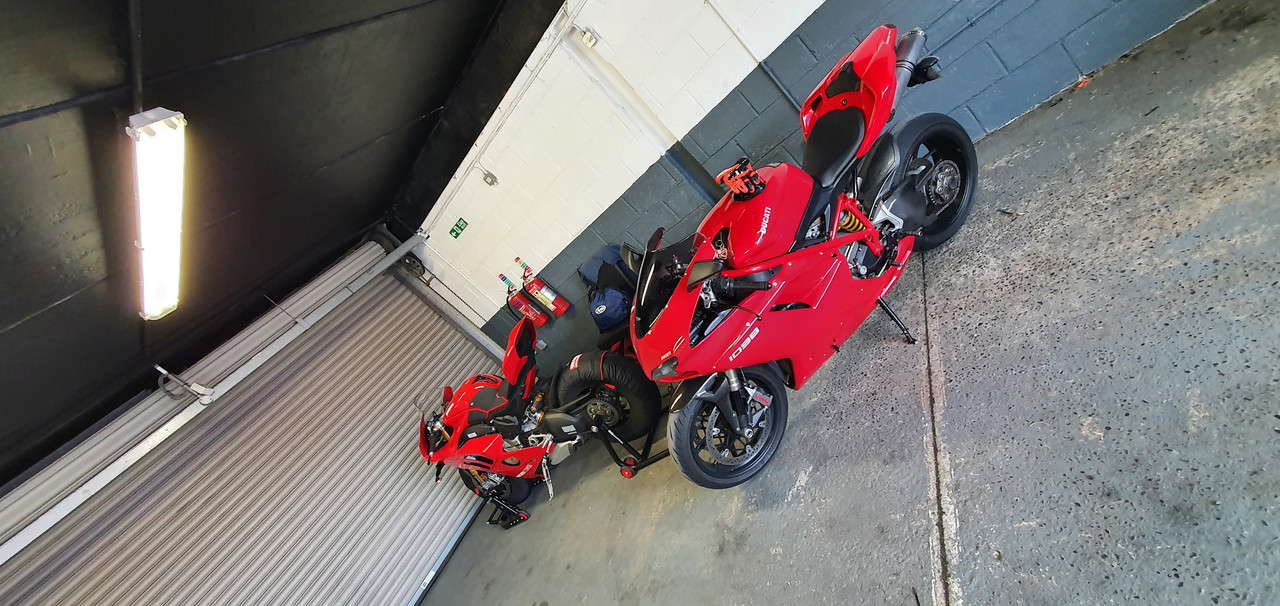

  14. Oil leak point if seepage weepage found .
    One bolt on alternator cover threaded.
    Will try one or two longer bolts, see if there is a bit of thread in the depths, make up the difference with washers.
    Otherwise it's sealant and dreams until after mugello
