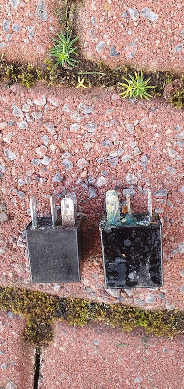

  2. So with no idea what was wrong with the bike i just thought right this is electrical again, bike would start, not start turn over, try turn, cough splutter , i decided to look at all connections, all earths, anything and everything.
    For the most part everything plug wise was clean , the earths were clean and connected also , bike would struggle, vrrrt vrrt vrrr, leave it, it would start, try again, nowt, extremely infuriating, so i really went at it , removing battery box and finding two hidden relays that were manky, could this be the issue? no it wasn't.
    [​IMG] [​IMG]
    in frustration i went and bought a new battery even though the one onboard was less than a year old, there was no draw on it as such but i was clutching at straws, i did find the starter solenoid the live into it, the brass connector was swimming about internally/ externally , could this be my issue ?
    The bike started , tried it a few times, grand ride it up to the drop off point and hope for the best

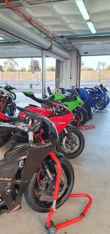

  5. Set up and we get ready for the day, bike on stands, warmers on, fueled .
    Try the bike, see if it starts it doesn't, it does, it doesn't it does...gahhhhhh
    1st session is coming up, bike starts, let it warm up, check pressures head out. I'm a happy boy

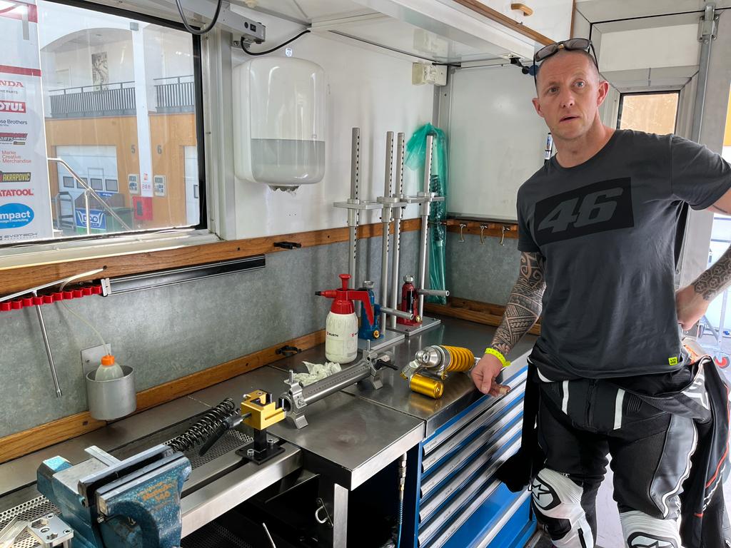

    When i came back into the bits i told Bobby my findings, the Motocraft team came over to have a look at his bike
    There was zero rebound in the front forks and the compression was maxed out, the guys worked on this . The Brakes were almost fully worn on one side and contaminated , the lads tried a swap of calipers from a bike that had broke down but it didn't work so a full clean of his system, pads fluids and discs and they were vastly improved.
    The rear shock was fucked, luckily there was an Ohlinsservice truck in the paddock there for the Pro teams, and Bobby went and asked could they assist, as they were doing sweet fuck all ( their words) they told him to bring it on down and they serviced it for him FOC, within 30 mins shock was out, serviced and back in.

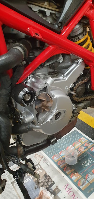

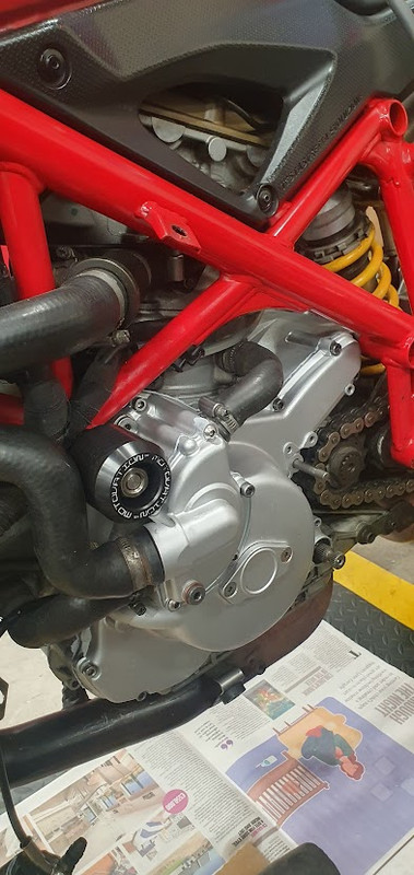

  9. Back to Dublin and time to figure out whats up with the Ducati
    Kind of knew it was the Starter and the starter solenoid to be honest as on the starter motor side the brass screw that comes out of the starter was swinging around like a hula hula girl, pretty sure thats not meant to do that so we will start there but also on the starter solenoid side one of the brass screws was also moving about in the original, the replacment we put on in monteblanco i found the wire on one spade connector was actually not clamped home correctly, the bike was dead out in Spain, perhaps this connection was not connected out there and that was part of the issue.
    I got offered the use of a space in a private workshop where i could work on the bike myself instead of having to send it off to the local ducati specialist, its not a job i could have done on the driveway .
    The casing on the ducati is sealed with sealant as opposed to a gasket , theer isa specific tool you can use to help pry the case off the block , I didn't have this so i set at it with stanley blades, slowly working the blade around the sealent and between the faces and after a while, success , it came off.
    The casing itself was painted at some point in its past by Stevie wonder, i decided it could not go back on the bike as it was, that i would send it for powdercoat , One of the chaps that owns the workshop said to me why don't i use the blasting cabinet down the back of the workshop, i didn't realise they had one. Fantastic , and after it was blasted, use the spray booth. The place is heaven.
    [​IMG] [​IMG]
    The starter out, the brass peg that sticks out and the reason why, the plasitic or bakolite I'm informed inside that holds it in place is broken and bits of it went down the sides of the casing, stopping the component from spinning hence the sometimes would work sometimes wouldn't
    [​IMG] [​IMG]
    Before and after below, water pump case to be done
    [​IMG] [​IMG]
    [​IMG] [​IMG]

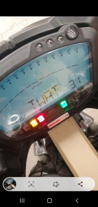

    All back together and i turn the key on the ignition, all seems well but i do have an engine management light on the dash, toggle through the onboard diagnostic on the dash and i get the error T.WAT 3.1 , the bike knows who owns it anyway
    a quick search and a twat error is something aalong the lines of a negative and a positive have touched somewhere along the way , i still have to resolve this issue but i touch the starter button and the bike fires immediatley, it never ever done that before so perhaps the bakolite being trapped has been an issue for a while .
