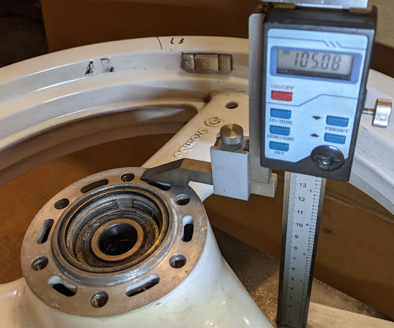

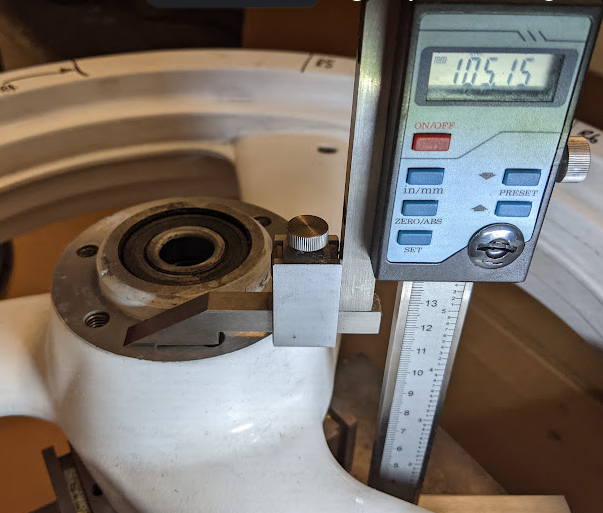

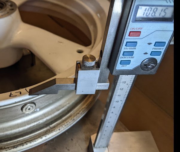

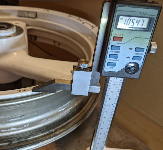

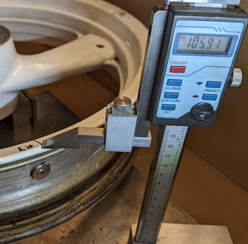

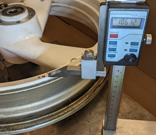

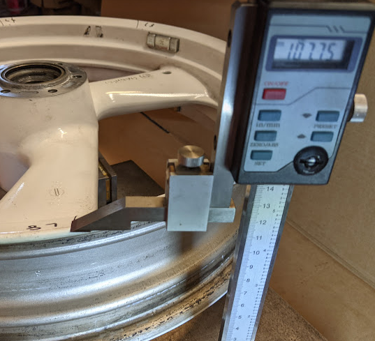

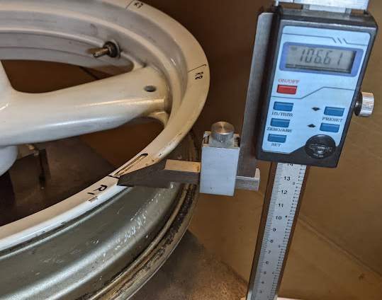

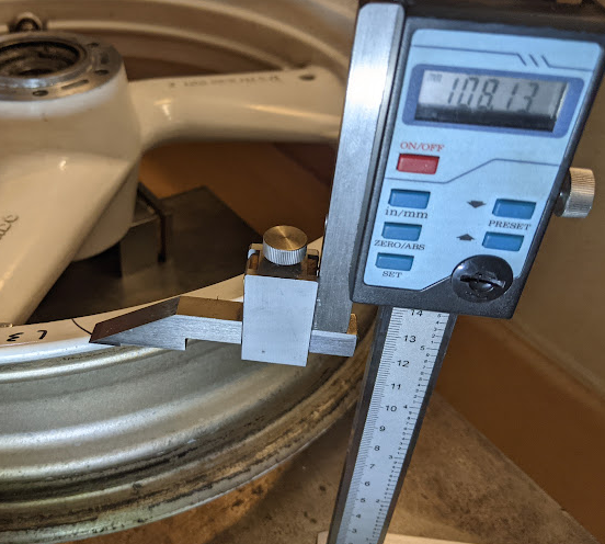

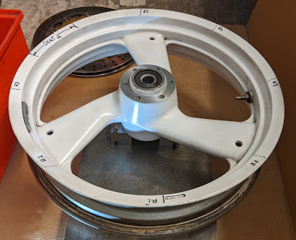

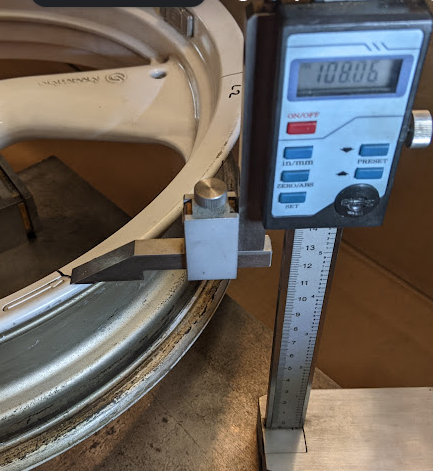

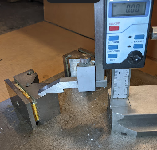

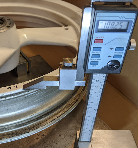

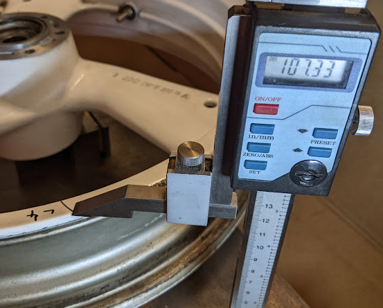

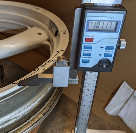

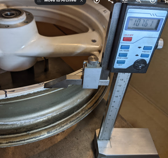

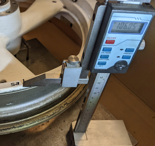

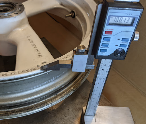

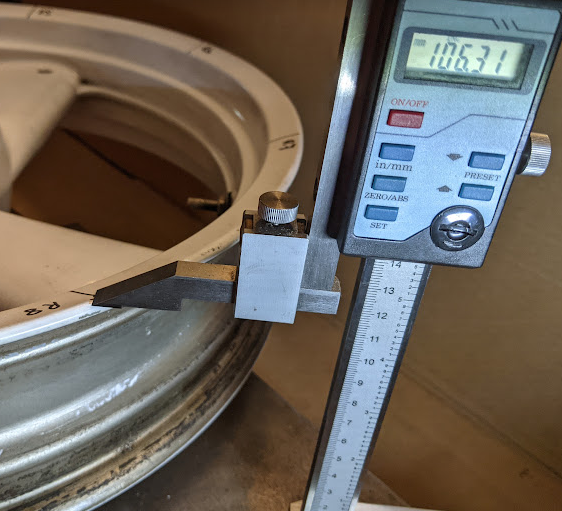

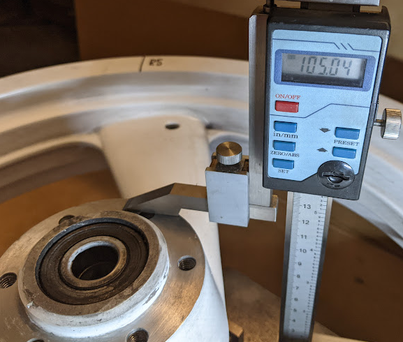

  1. "The wheel is interesting and I think one other thing might be worth doing.
    Once again put the wheel disc mounting face on blocks, clock off the block and measure the opposite side.
    Height wise you should be coming in at about 110mm but the important thing is that the measurement is consistent on all points measured."
    width of hub, across the disc mounting faces is 105mm.

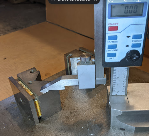

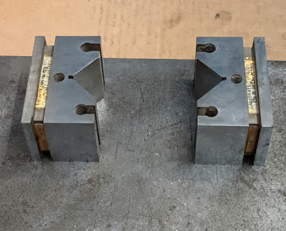

    (zero height gauge, on one of the vee blocks. vee blocks are out of calibration, though they were a matched pair.)

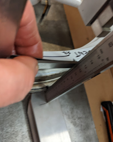

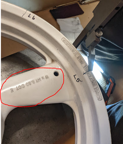

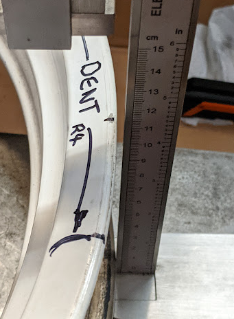

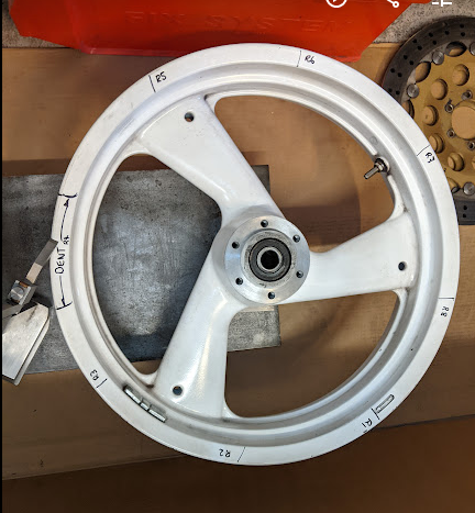

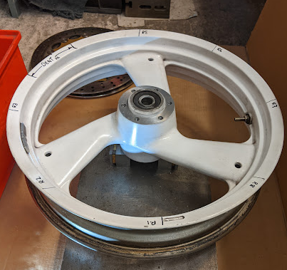

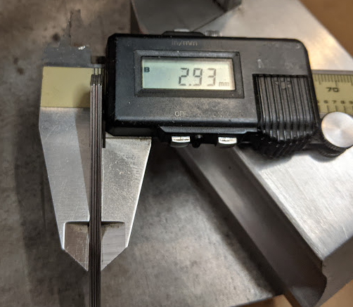

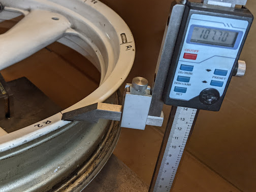

  2. measuring the front wheel (photos)
    (does 900 have same front wheel, as the 750?)
    #22 sniffipn, May 30, 2023

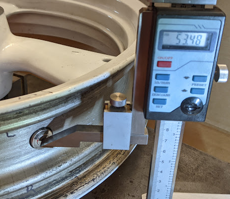

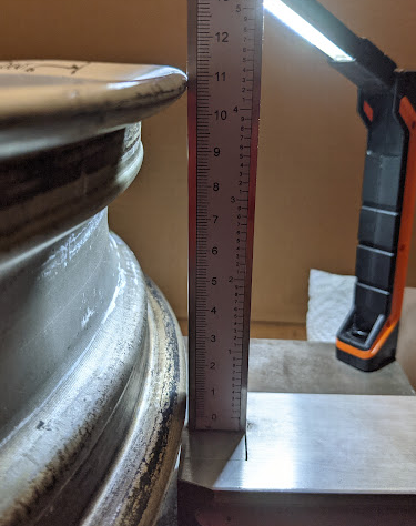

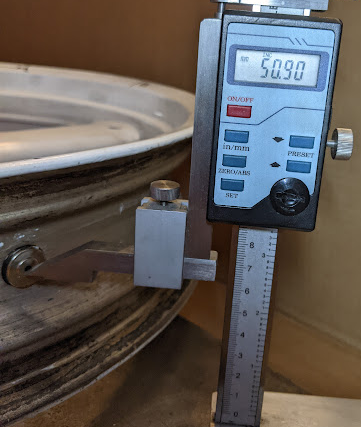

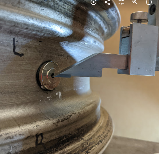

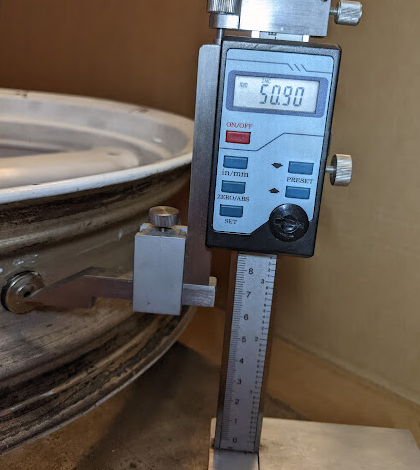

  3. measuring the wheel - tyre valve
    "you will probably find that the tire valve sits at the wheel centreline, so another point if reference for you to take a height measurement from."
    (thinking about it now, i could/should have measured using a rod (or made/found a ball stylus) in the valve bore - or removed the valve before measuring.)
    (looks to be below centerline of hole, though maybe not 2.5mm (difference in measurements, side to side) away. if i remember, i'll check again before tyre goes back on.)

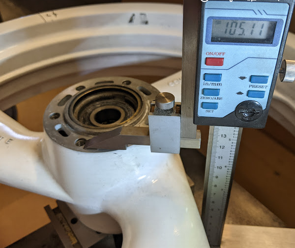

    (impression that RHS, has taken more of a knock than the left)
    away from the damaged area, very little apparent radial difference
