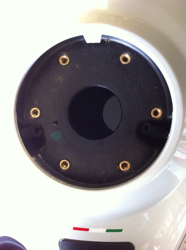

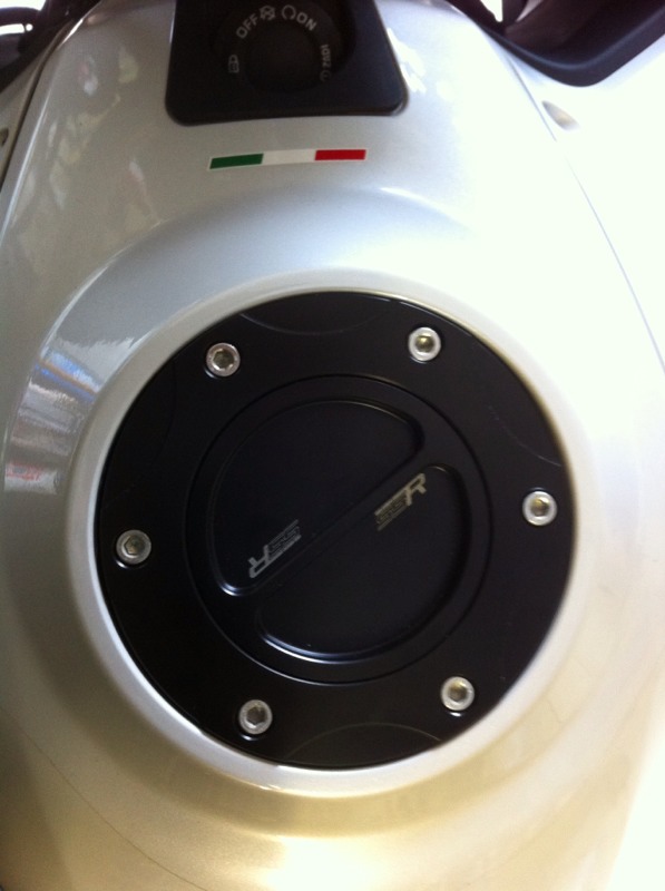

  18. Finally got around to fitting the Race Fuel cap today. The cap is black so ordered some replacement bolts from ProBolt, turns out they are the wrong ones . The thread and head size were completely wrong, not even close.
    Anyhoo, relatively easy fit. Took the original fuel cap off and managed to pop off the left and right overflow hoses no problem. Fed the one hose that is on the new cap into the right hand hose and fitted a cable tie to the other so it didn't drop down.
    I fitted the original bolts and was surprisingly happy with the contrasting colour. Phots below. The first is with the original cap removed and the second is with the new cap fitted. And for those who it matters to...I know it isn't straight and I'm ok with it

  19. That looks great with the white tank, you have any problems fitting? Hope my instructions were clear and you didnt drop yer best screwdriver in the tank!!! :smile:
