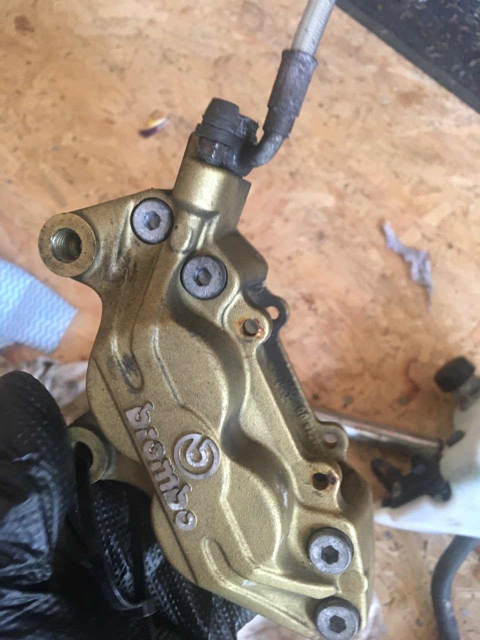

    If by ‘cylinder’ you mean this (see photo) that’s a caliper and yes there are 2 of them if you have dual disks

  2. bike is 2003, i've edited my post incase you didn't refresh your page, i hope i explained myself properly now. my brake caliper looks exactly like yours,
  3. That piston can come out but it looks like it’s missing the rubber o-ring seal. Do you have a better photo? If the seal is missing it won’t work, it will leak brake fluid.

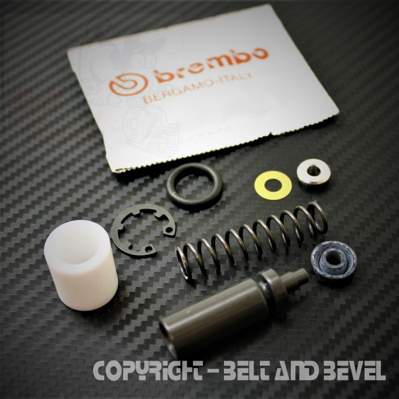

  18. [​IMG]
    so i found this picture online, it seems what i'm missing is that snap on ring on the top left correct?
    i shouldn't be able to just take the piston out? correct me if i'm mistaking
