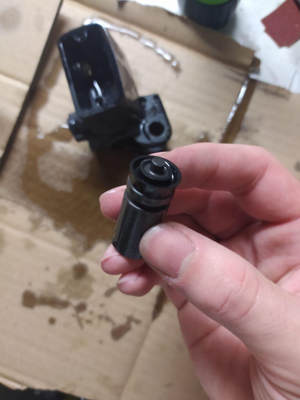

  6. this is what i ended up with, it seems i have everything except the ring that holds the piston in place (so in theory it should still work as the piston stay's in place even without it...
  7. actually there is everything, even the metal ring that hold everything in place, so everything is there.... gonna take it apart and put it back in.

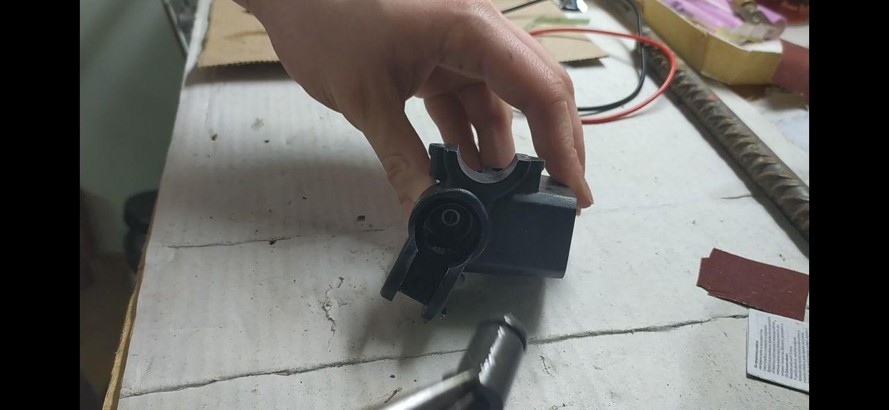

    also, this little rubber seal, which way is it supposed to be facing? i wanna make sure everything is right

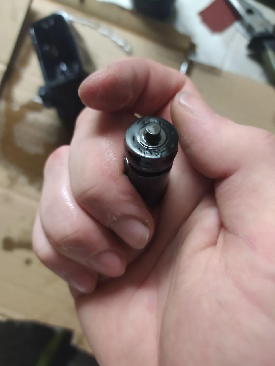

  12. Los, if I remember the video correctly I believe you have the rubber seal on the right way in the second photo but not the first. HOWEVER, in the first photo the rubber seal looks damaged, it looks as though there are holes in it.
    If that is indeed the case then it’s no wonder you can’t bleed the brakes. Each time you squeeze the lever the pressure can’t increase because the brake fluid escapes through the holes in the seal rather than compress within the brake lines. This would also explain why you’ve seen brake fluid leaking from the master cylinder. Don’t bother about bleeding the brake lines of air until you’ve fixed the issue with the master cylinder and it’s working as it should.
    If you can’t find a service kit then try and find a complete master cylinder & reservoir, there’s bound to be some on eBay. However, note the service kit will be common across a lot of different bikes with that master cylinder so do some research and try another model bike eg M750, M900.
    Im glad you’ve found the circlip because it’s that which holds everything in place and is necessary.

  13. the clip doesn't hold the piston inside tho, it only hold the rubber seal and the white plastic "thing"
    anyways i think i fixed it, no idea how, but i guess 10 hours of trying did the trick, took the master cylinder apart and put it back together.

  14. Do you have a photo of the circlip? Does it look exactly the same as the one in the photo of the kit you posted above? It really should hold the piston in.

  16. the picture of the kit i posted is a different kit, mine looks different i can't find ths model
  17. thank you!!! looks like i'm missing the last rubber cap! oh well well, i doesn't seem necessary as long as i'll be careful cleaning it once in a while, gonna take a test ride today and see if i fixed it
  18. Los, I've just edited my post #52 as the rubber valve is correct in the second photo NOT the first as I initially wrote, my error:(. Apologies for any confusiono_O. I'm assuming you have it on the right way now otherwise it wouldn't be working as you say it now is.:upyeah:
