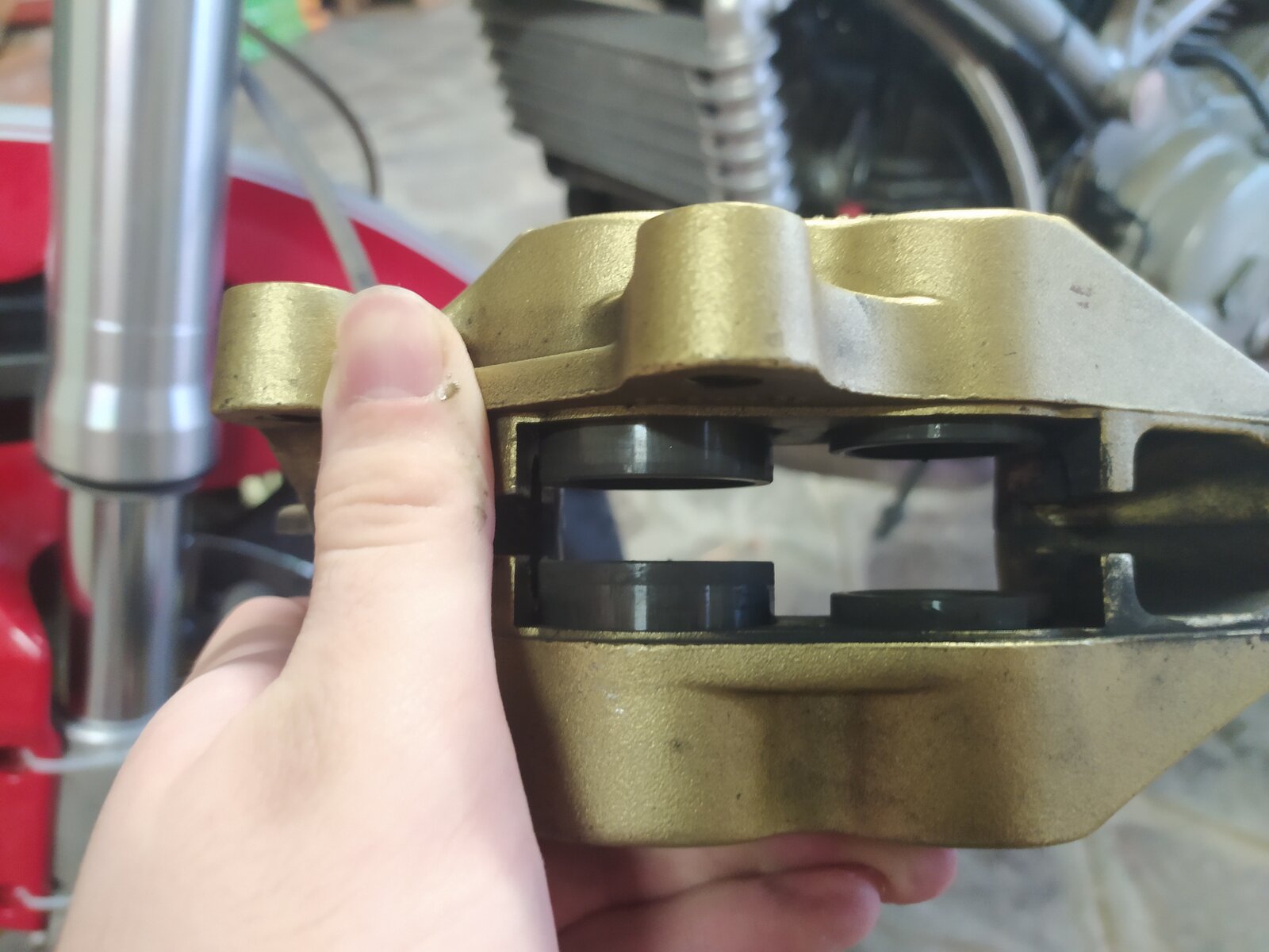

  4. Uhm so, I. Noticed the oil is already kinda dirty, which is odd because the other day it was coming out clear from the bleeders, so the entire system should have clean oil in it.
    I'm cleaning the caliper pistons to see if that's what's causing the dragging, are all 4 of the pistons supposed to work together? The 2 on the lower side don't move

  11. All 4 pistons should move Los, those 2 look seized.
    Also if you have one disk heating up more than the other then the pads are rubbing against it which also indicates seized pistons in the callipers.
    It looks like the callipers need stripping and cleaning.

  12. That's odd, they are sized on both calipers, but there appears to be no corrosion or anything. And I can push them back with my fingers quite easily, well, might rebuild them looks easy
    The issue with the rubbing is that I think there is something bend, maybe the disc, because it only rubs when both brakes are on, when only one is on its fine
  13. Do you think they are sized or could it also be not enough pressure in the system? If I stop one piston the others come out. Does this mean they are sized or can it also mean there is not enoguh pressure?
    I can rebuild the caliper it's quite easy, but I don't wanna do a messy job unless I'm sure it's the issue.
    BTW this also means I got scammed, the shithead whom I bought the bike from never mentioned the problem. And I found a bunch of other problems after I bought the bike that he didn't mention, would make a lawsuit on him but sadly its been 5 months. I saw they are sized 4 months ago, but I didnt realize they all had to move.
  14. When the calliper is off the disk I would expect to see all 4 move when the brake lever is squeezed. They may not be completely seized, may be just a bit stiff, but the calliper does look like it could do with a thorough clean.

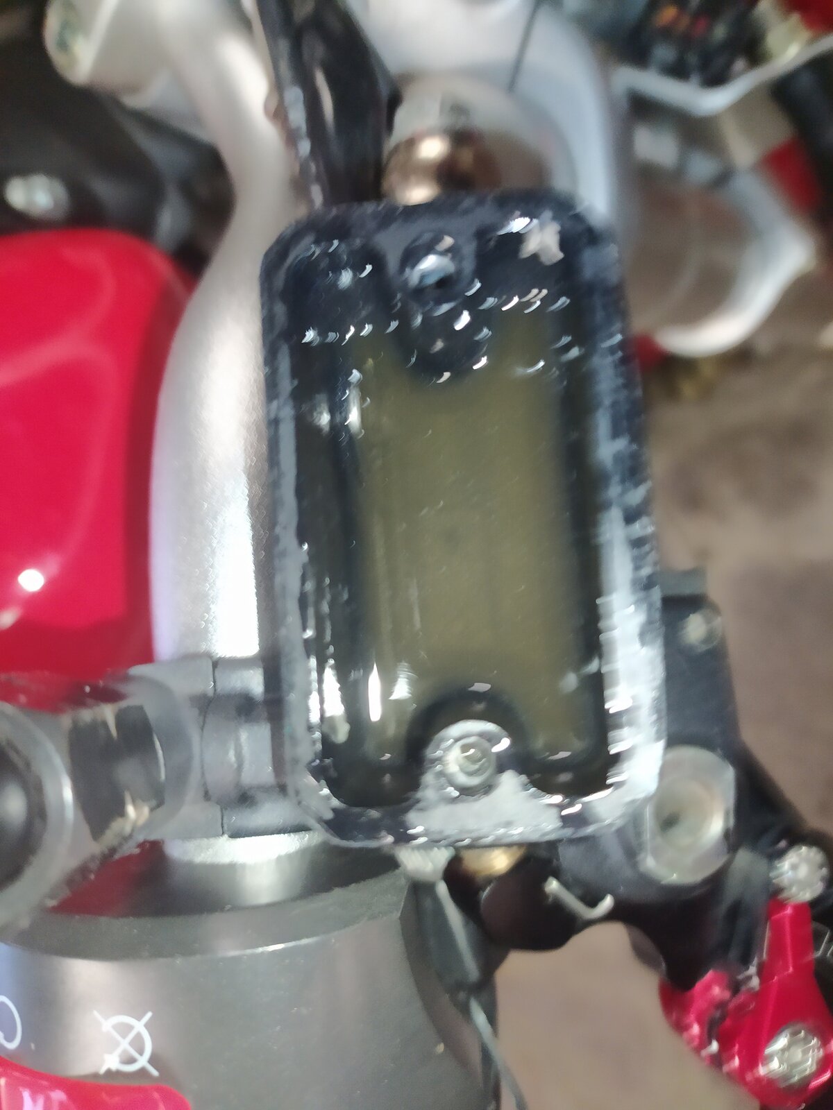

  15. where did you find the rebuild kits? i can't find the right one anywhere
  16. It wasn't my write so I don't know where he got them. What size is your master cylinder? There should be a number on the bottom somewhere containing the number 13, 14, 15 or 16 indicating the diameter of the cylinder. 16mm are not generally available but the outer dust seal from a PS15 will fit a PS16.
  17. well, i took both calipers all apart and cleaned them, cleaned the pistons nicely and put everything back, i seem to have f
    it says 15-16, what does that mean?
  18. Hmm. No idea to be honest but as far as I'm aware all the gold master cylinders fitted to twin disc Ducatis are 16mm

  20. Ah! but it's not a gold master, it's the black coffin type. Most probably the same as my 907ie. I'll check.
