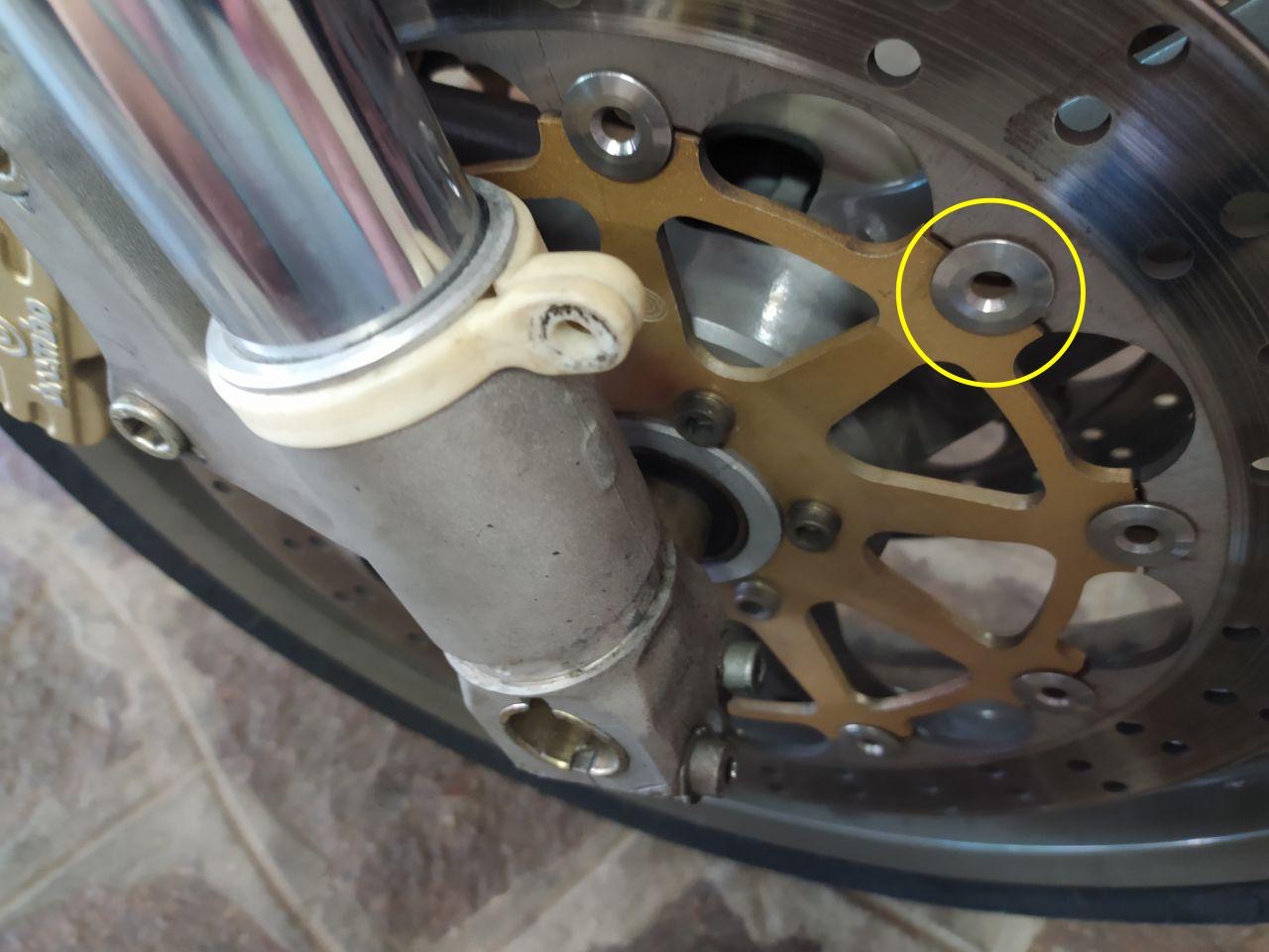

  3. Just to add another complication, are the discs on this model supposed to be fixed or semi-floating?
    If semi-floating and seized, they will need to be freed before they will work properly.
    Also, KTM dealers are a much better source for Brembo brake parts than Ducati dealers, as KTM, allegedly, were willing to agree to a disclaimer and Ducati were not.
  4. no idea what discs this has, the right disc is still heating up slightly, but there is nothing wrong with the calipers so idk.
  5. y'all know where i can find a replacement bleed valve? this one is starting to strip
  6. Are the discs solidly mounted on the carriers or are there stainless buttons that allow some movement so the discs can align themselves with the callipers?
    The buttons have a tendency to seize up over time with brake dust.
    If seized, they can be freed up with something like kitchen spray, that is neither oily or corrosive but will dissolve the muck.
    A nut and bolt through the buttons will allow you to turn them as you spray.
  7. these are fixed correct?
  8. Old Rider was referring to the bobbins (circled) often times they can seize due to a combination of brake dust and corrosion.

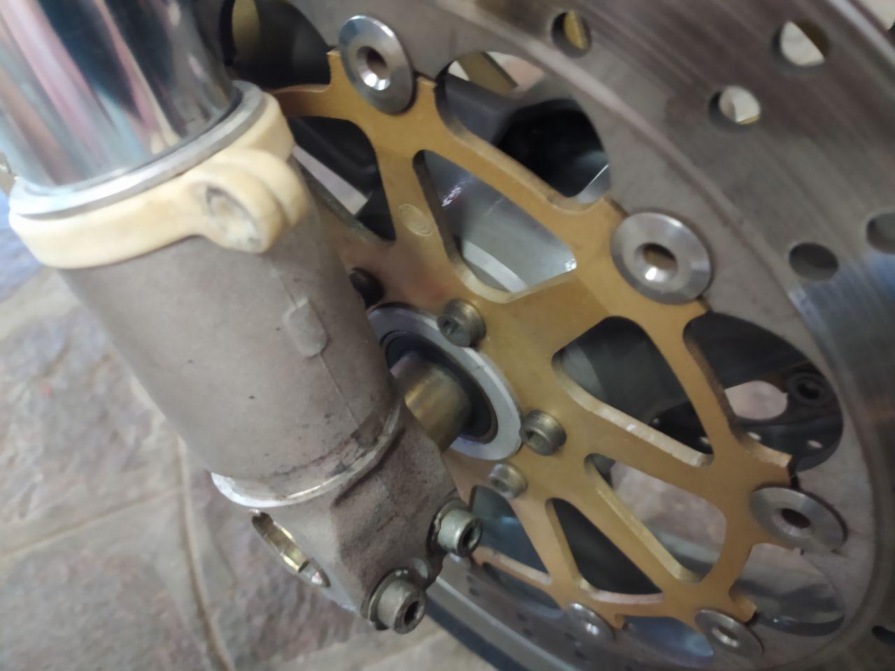

  9. so are these supposed to have some play in them=?
  10. You may want to check out this vid
    Or this one
  11. Yes, they are not 'fixed'; they are 'floating', meaning that they should have a small amount of play in them - to allow them to 'float'...

  14. i guess it's as good as it gets, i reverse bleed the brakes, so it should be good! thanks for everything. i cleaned the discs so they can move more freerly, i will see on the next ride.
  15. Yes.
    I kept cleaning mine until they were free enough to give an audible click when moved.
    Hopefully, when freed, your disc will no longer get so hot.
  16. honestly i did everything, and it still heats up the disc. i guess it's the way it's supposed to be.
    the semi floating disc is free
