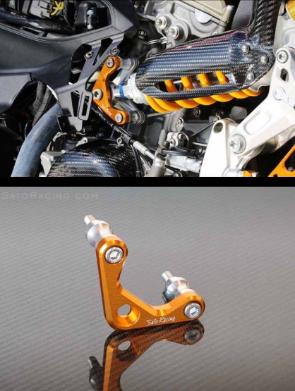

    The rear linkage is a conventional shackle/twin shear arrangement for all 3 links but the front linkage is in single shear and so I hope any sideways (left/right while sat on bike) movement, particularly angular, of the damper during use has been carefully examined during design. The Sato mod makes perfect sense (as long as it is rigid/sturdy enough) as it effectively upgrades the front damper fixing to twin shear. image.jpeg

    I'm going to have to bite the bullet and buy a Sato bracket or get rid, if I'm going to ride the roads I do, there's no other option.I hope the 1299 is better designed or there's gonna be trouble at #Ducati !

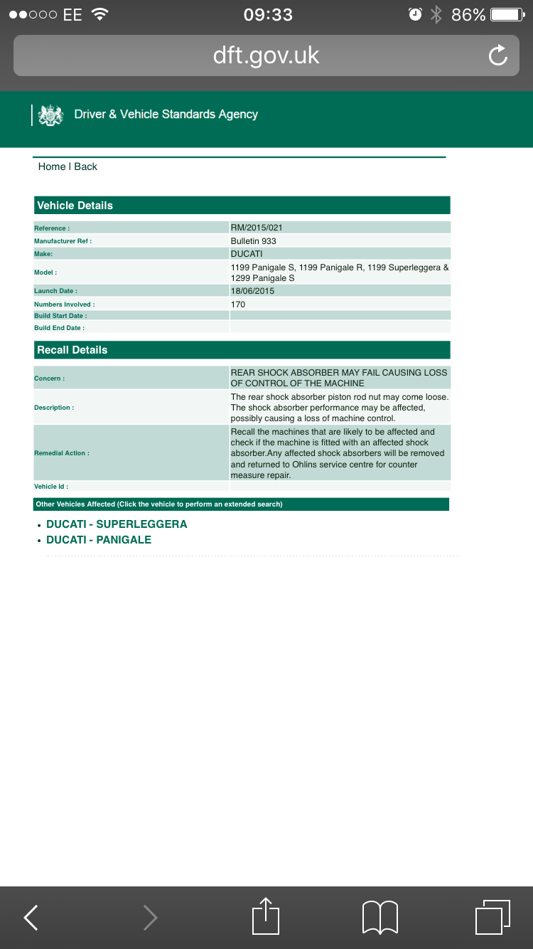

  11. this ones most worrying, theres no build dates or frame numbers!
    RM/2015/021 DUCATI 1199 Panigale S, 1199 Panigale R, 1199 Superleggera & 1299 Panigale S rear shock absorber may fail causing loss of control of the machine
  12. That is the Ohlins shock itself. I know mine has already been sent back to Ohlins and stripped/checked.

    Surely Ducati could easily cnc 1000's of the sato style support brackets for pennies?
    My question then would be whether the sato style support bracket would actually safely fix the likely occurrence of a suspension failure?
    If so I wouldn't buy a panigale without one personally and it'd be the first thing I'd fit

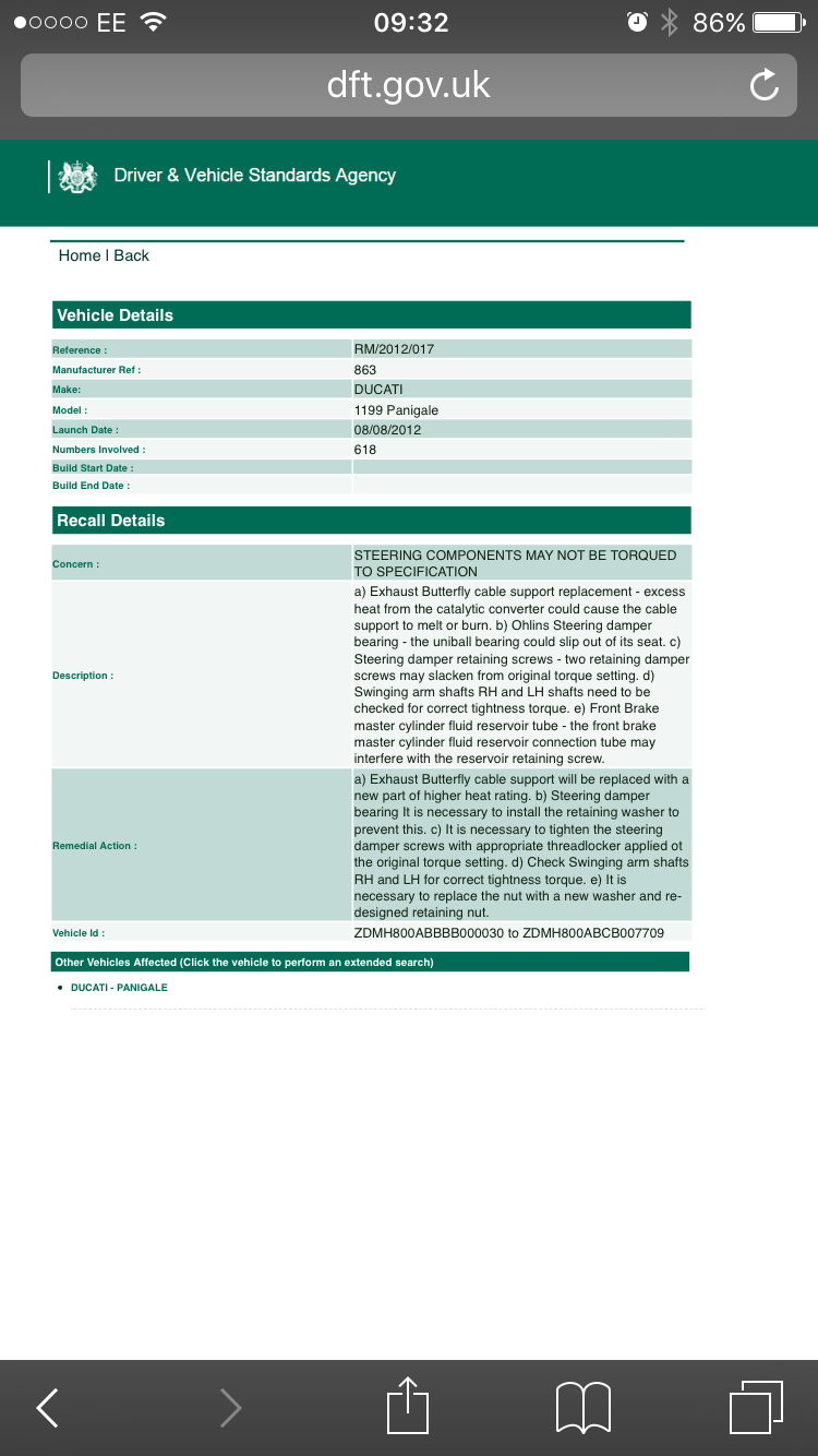

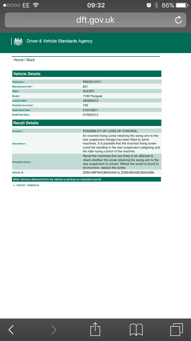

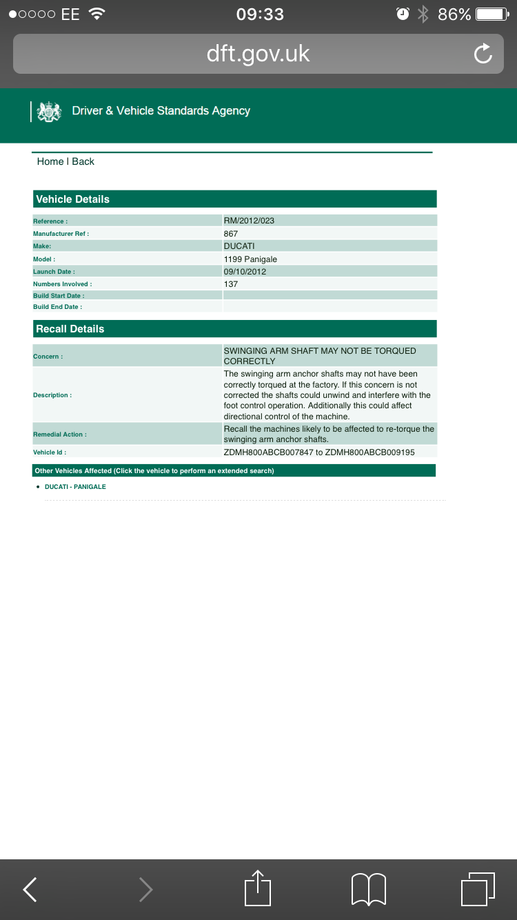

    Here's the DVSA current status:-
    DVSA - Vehicle Recalls
    #54 Chris, Oct 22, 2016
  15. Im not sure any of those cover the bolt failures that have happened....
    This is bolt (screw?) to swing arm:
    All sorts of odd little niggles that should have been picked up by now and corrected:
    This is swing arm pivot by the sound of it:
    This is the rear Ohlins shock problem:
  16. +1 for getting an official response, I hadn't thought too much about it until I took my shock out to get it reworked and really looked at the bolt. It's only held in at a relatively low torque figure also due to where it goes into.
    For those that are worried, if we could put together a group buy for Sato brackets I would be interested, however I can't believe no one else is interested in making one... I would feel more comfortable with the load spread across 3 points for sure
