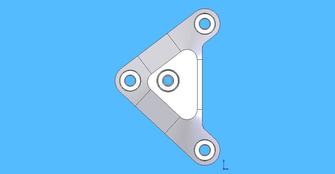

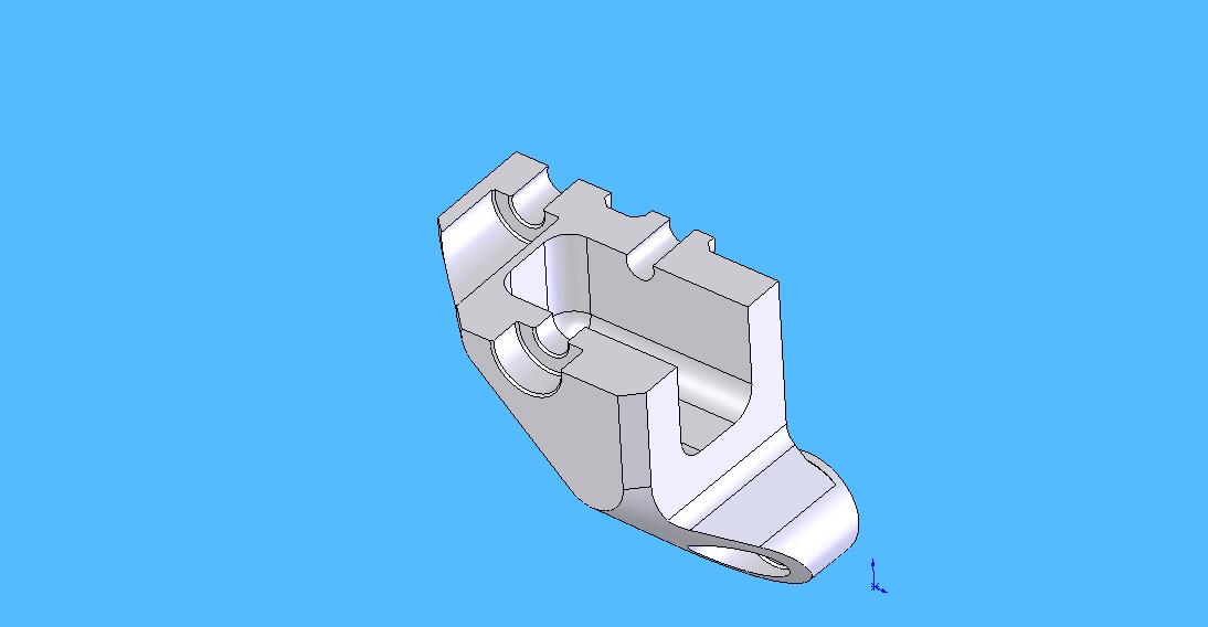

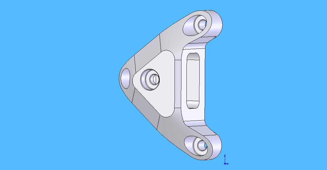

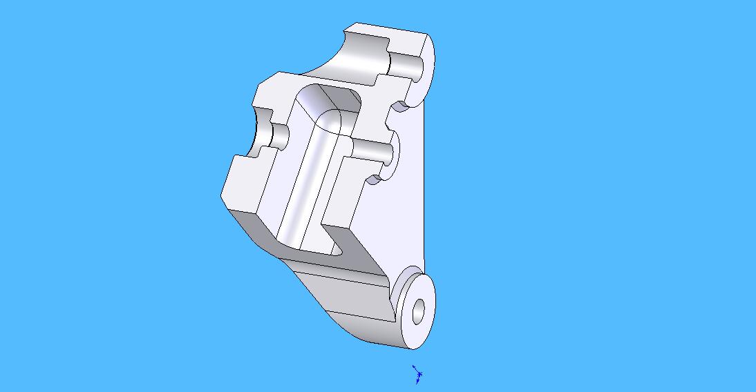

    Here's my effort for you Damo, it would replace the existing triangulated plate, probably wouldn't have to be as chunky as I've modelled it. One piece with the end of the shock inside a pocket, don't have accurate dimensions as it's just taken from photos, the only obvious problem is standard the shock end currently gets in the way of the forward fixing point, so the rod end would have to move back, on the Ohlins it looks like the end is adjustable but I don't know by how much if not enough it could be combined with a shorter tie rod.

  2. :upyeah:
    Hats off to you Tobytyke, I'm far from an engineer, but the fact you've even got as far as modelling up a solution in a short space of time is frankly brilliant.
    Hopefully someone more qualified than me can help with the solution to the shock end.

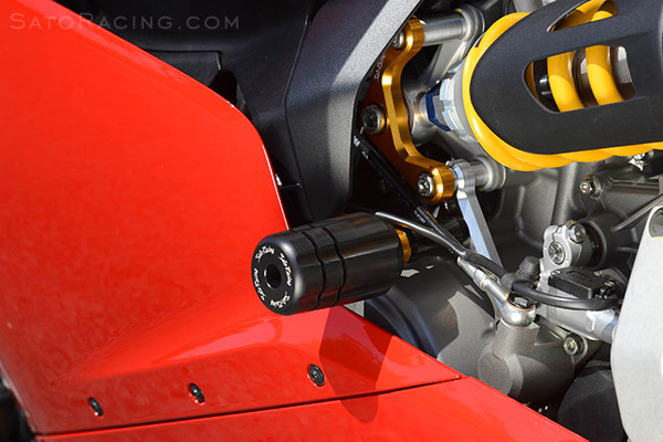

  3. Fair play, that looks great! Definitely agree that the Sato one is horrid in Gold, weirdly the make other parts in black but not this.
  4. It is mostly hidden behind one of those odd little panels, and at least matches the Ohlins shade of gold on the shock.
  5. Bloody hell Jolley, that'd mean I'd have to upgrade either the 959 or 1299 base just to match..... We need a black or silver one just to keep neutral
  6. Just get the S!
    You could easily paint it because it won't really wear or get any abuse where it is.

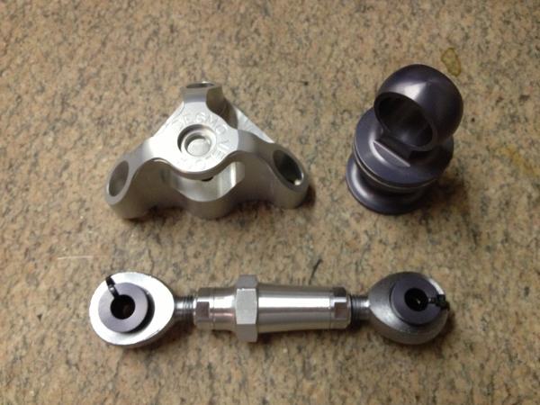

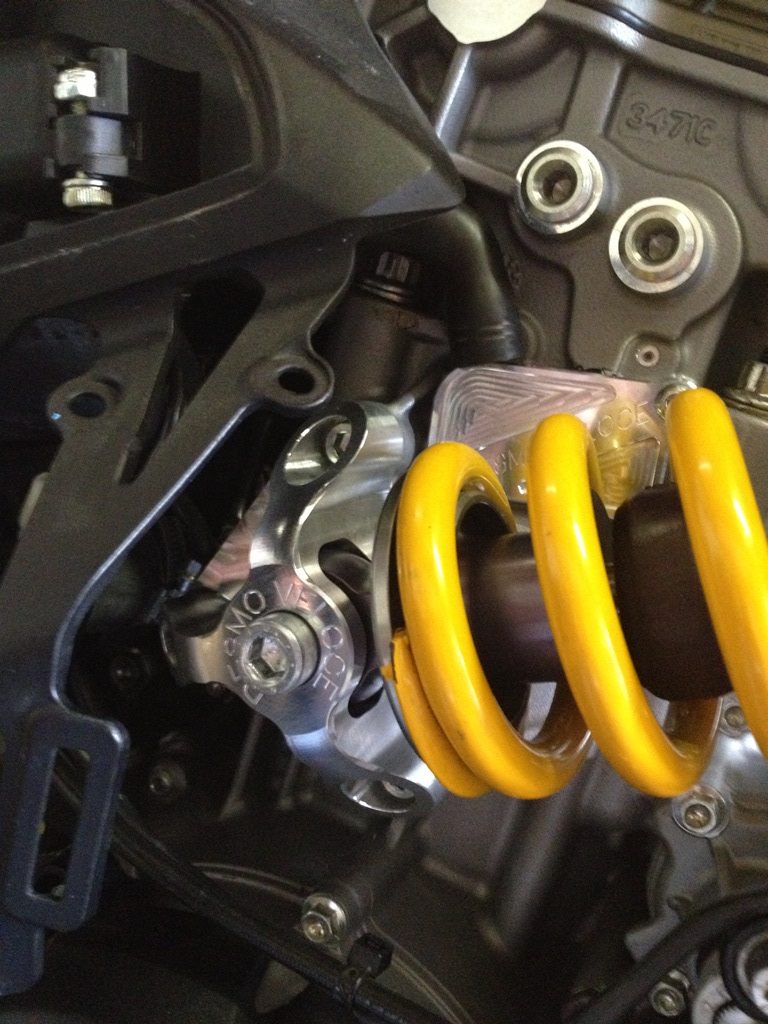

  8. There are several options already out there - here's an alternative to the Sato version from Desmo Veloce :-
  9. Cheers Chris, just had a look at that and I think it's more for additional tweaks aimed at racing as opposed to simply reinforcement.
    899 959 1199 1299 PANIGALE BILLET RACING SUSPENSION KIT – Desmo Veloce

    as I said already, you have lost me now as the fact that the Desmo Veloce aftermarket replacement upgrades the original front fixing from single shear to twin shear clearly demonstrates that this modification is not merely an "additional tweak" If I had one of these set-ups on a bike I would be fitting this or similar in a heartbeat, and it's most certainly another option to consider.
    Tried contacting them yesterday without success but from the website -
    It's for all Panigales and clearly states this.
    The 28mm movement is a separate mod and doesn't affect the front damper mounting.
