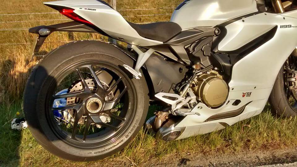

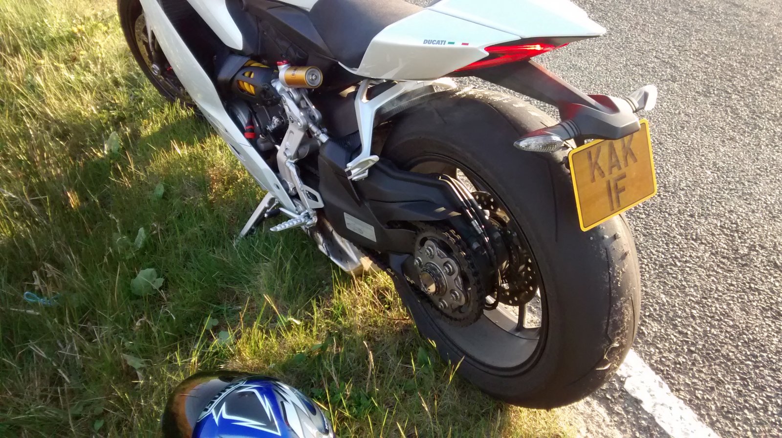

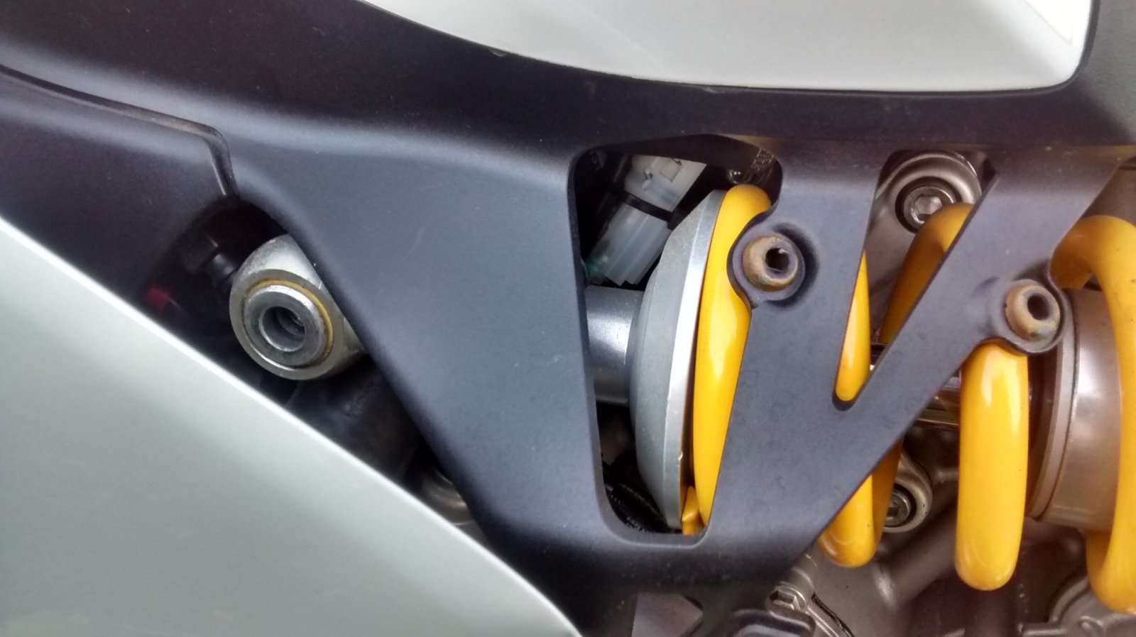

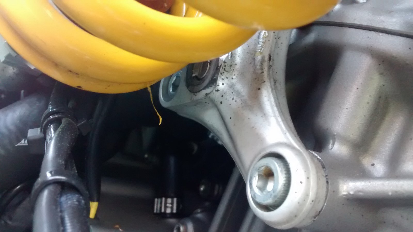

  8. That is a poor design from the outset imho, for what it would cost to support the bolt on both sides it should have been done from the outset.
    I honestly can't name another bike with a single sided shock support?, I would buy that Sito bracket as peace of mind if nothing else.

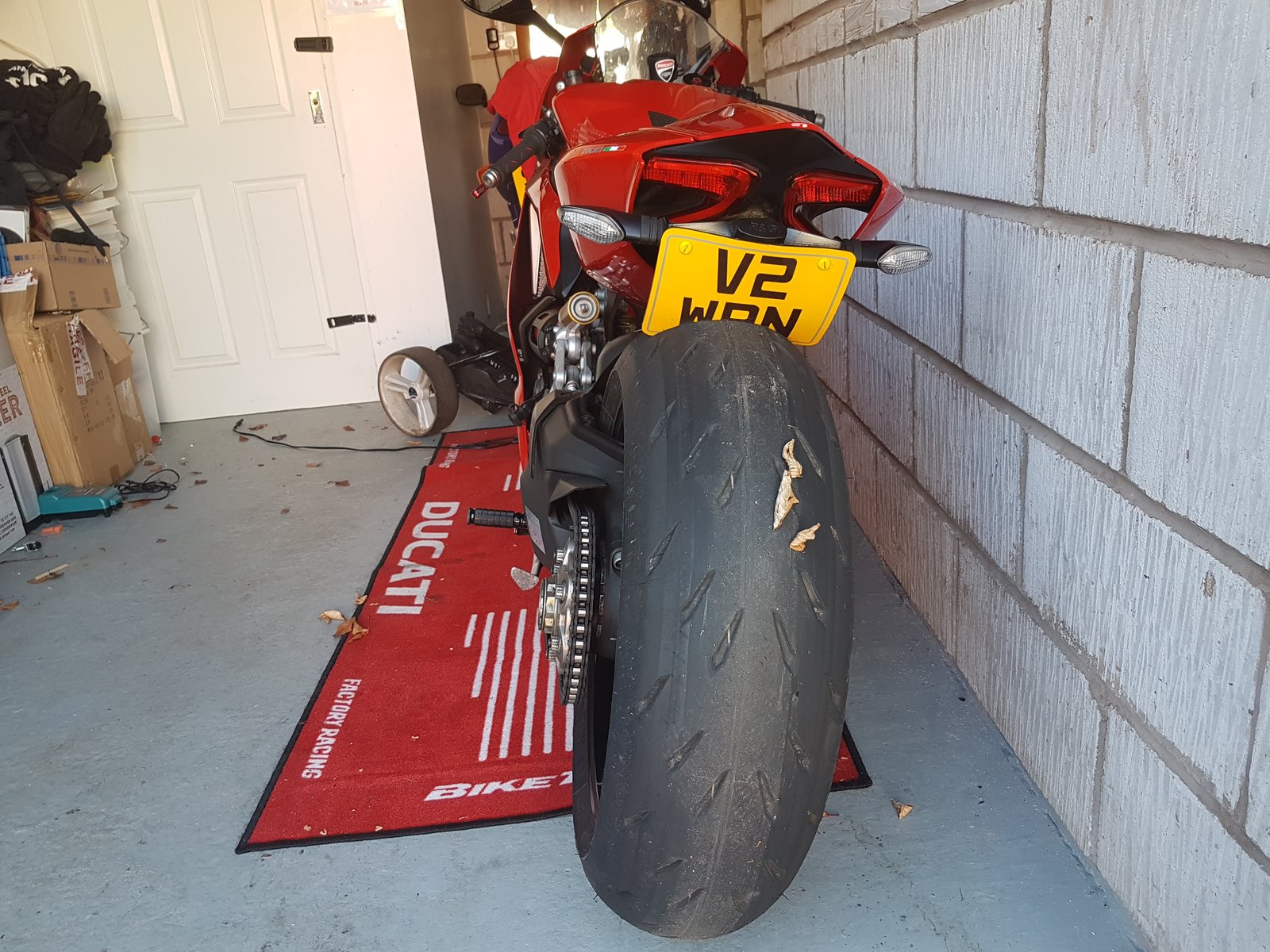

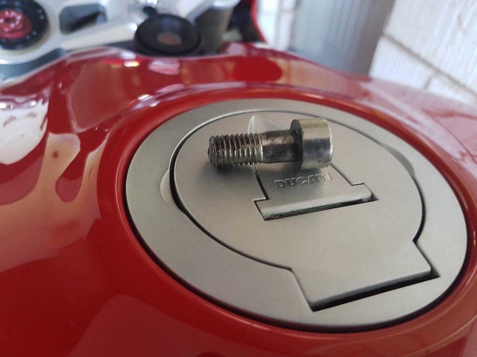

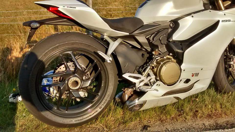

  9. Hi just wandering if you had any joy with ducati I had same thing happen yesterday on an island. Lucky boy to be honest. Bike is 1199 63 plate only done 4900 miles. Can not believe this has not been put out there on web more prominently.

  13. Unbelievable that this is still happening, ducati should have been forced to solve this problem on every single bike, people have died because of this, I really don't get it that they don't solve this, makes me very angry! @Tim Maccabee
  14. It needs putting out there so people can make an Informed choice if it puts dought in their frameless technology and hurts sales then they will do something. This will not be swept under the carpet. I will do a video for YouTube and warn people of dangers. It is dangerous enough out there anyway without your bike trying to kill you. May expect problems with cheap Chinese bike not a so called premium product.
