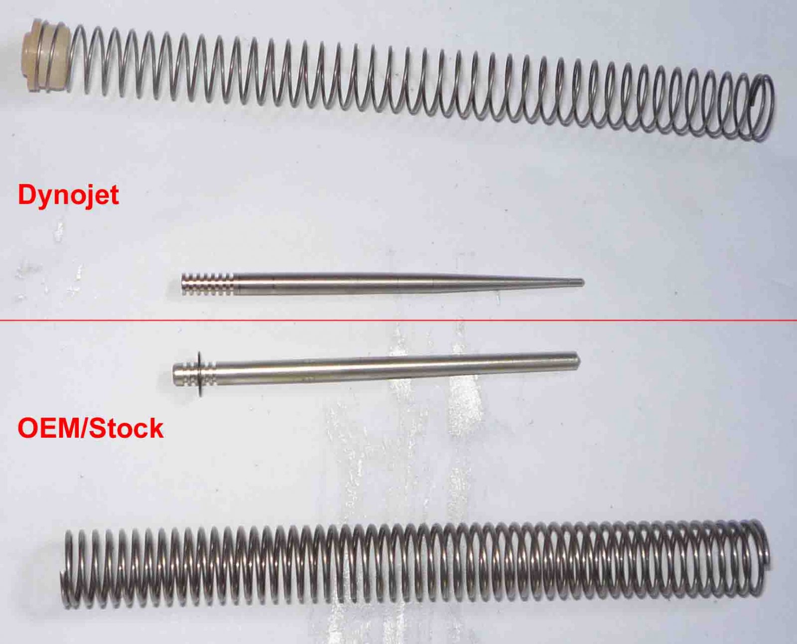

  11. I've recently read that the jet kit came with its own springs, these springs differ in tension from the original springs and
    I recently found some info about the dynojet kit, it came with its own slider springs which are weaker than the originals, this helps with throttle response. Apparently these springs cause the engine to pop on the overrun. Putting the normal springs in stops this.
    Something to try, or set it up properly with the current springs and have better throttle response.

  13. This might help.........
    Mine doesn't pop on the over-run.............try a few tweaks with the pilot screws......
