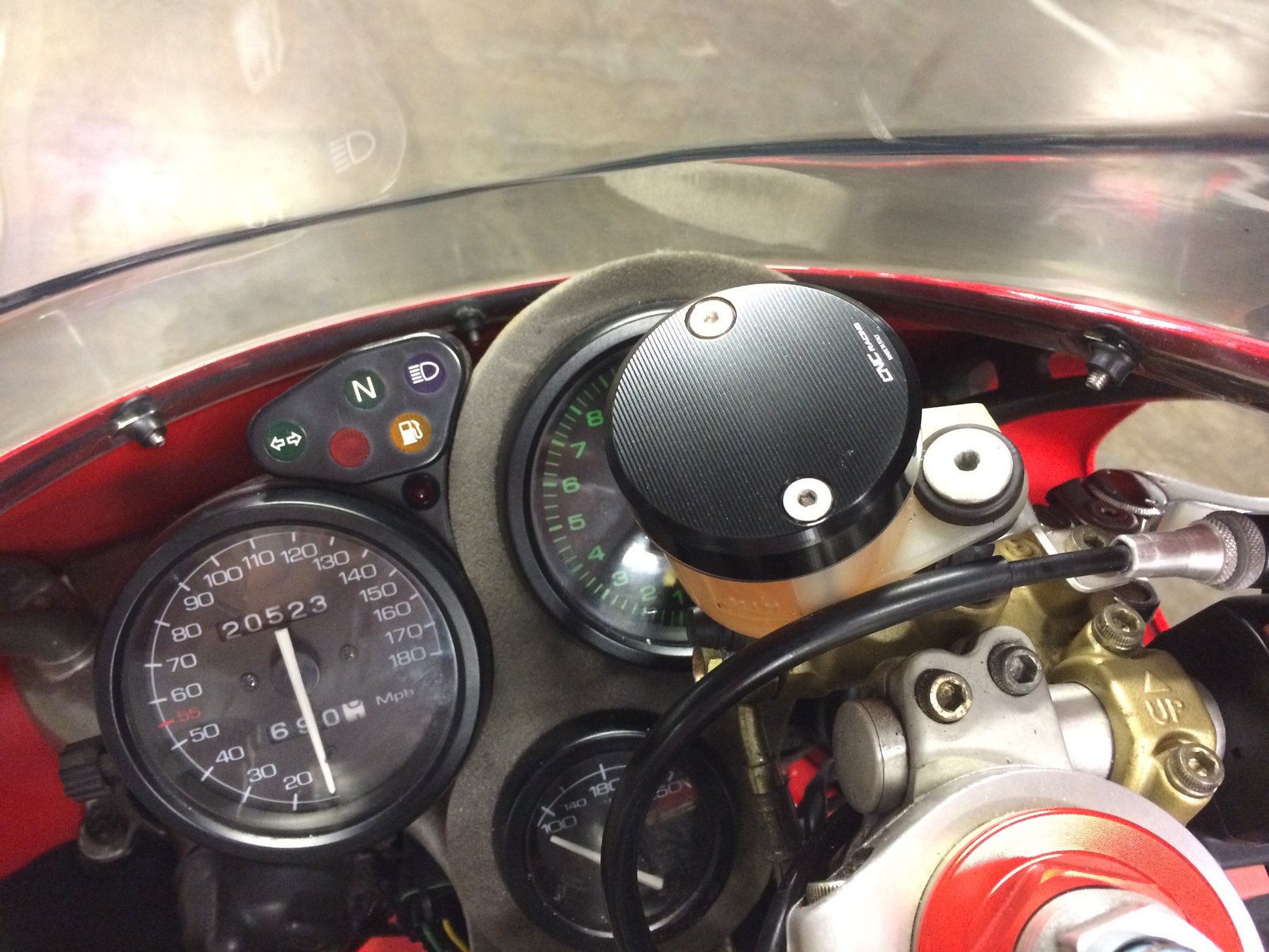

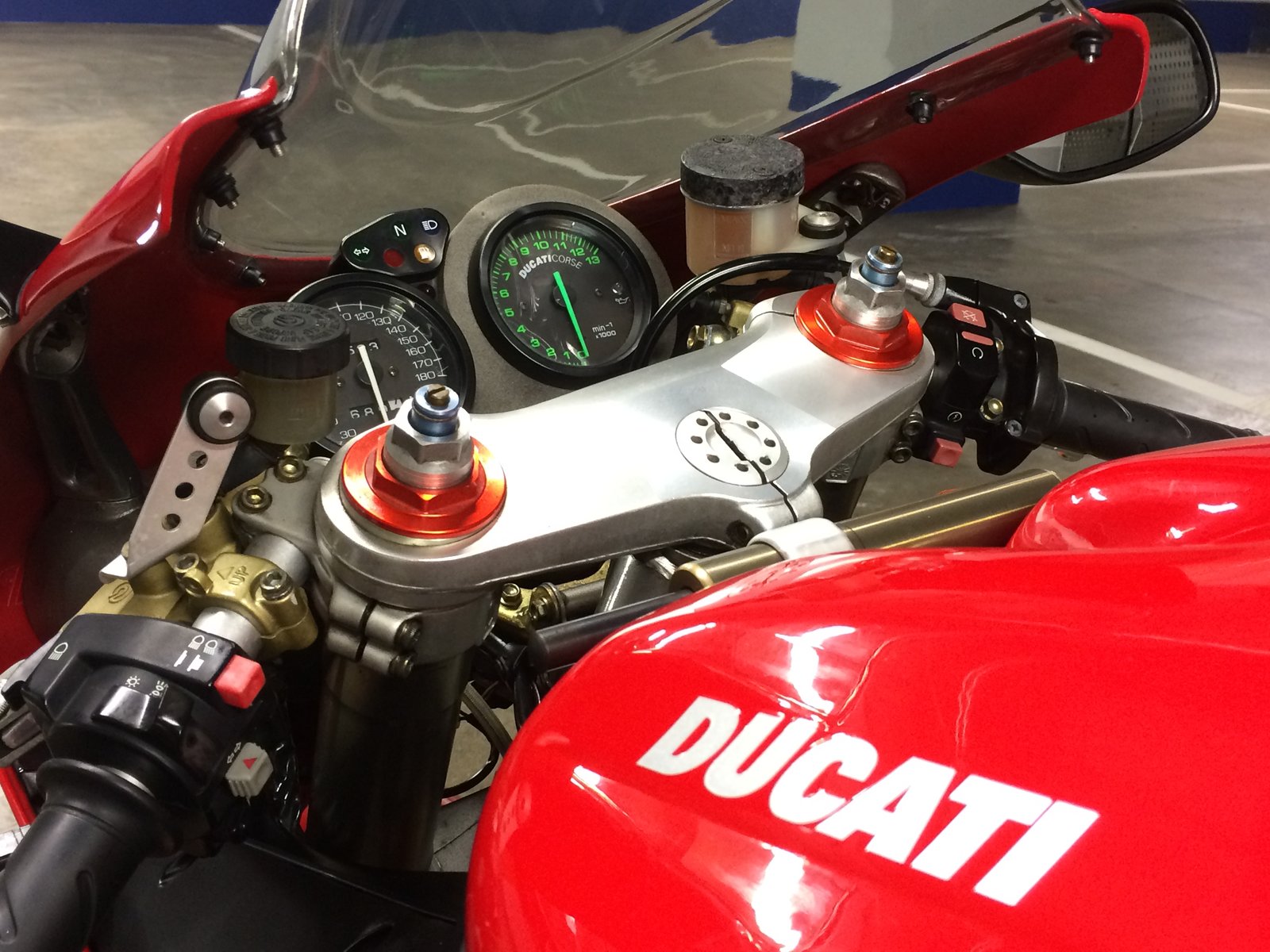

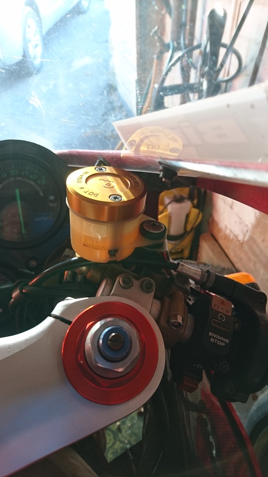

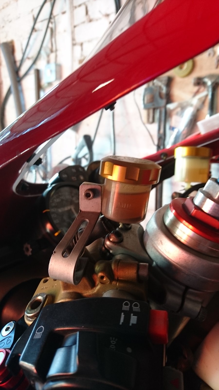

  3. The clutch reservoir on mine has a slight rub on front screen , is it fitted correctly?
    If you have any pics be great to compare , maybe the bracket just needs fettling
  4. You appear to have a different bracket to my 1998 model, DSC_0273.JPG DSC_0272.JPG
    My clutch reservoir has plenty of clearance, the front brake is a bit close though.
    Steve
  5. Just had a look on my '98 916 and the support bracket on mine is the same as Birdies, your one however is the same as my 998 which is MY 2002. So you have a later part fitted but I don't think this is the problem. I would first of all slacken the clamp and move the lever along the bar closer to the switch block. If it still fouls the screen then I would suspect a slightly bent fairing support or a bent handle bar. Neither will necessarily be easy to see but as the reservoir is quite close to the screen anyway it does not take much to make it touch.
  6. Thanks , was able to move in the Reservoir

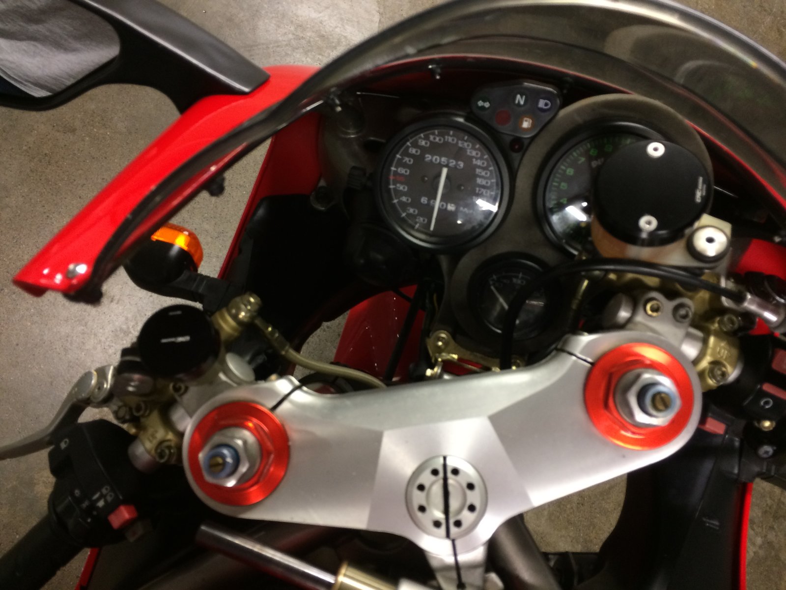

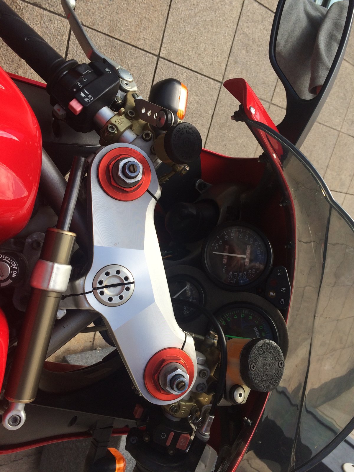

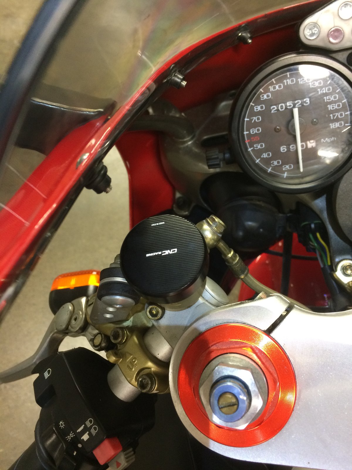

  10. Carlo, you have non standard screen bolts which extend far deeper than the original ones (which are brass captive screws of similar but much smaller design), they were probably changed when the screen was replaced, also the Dzus fasteners on the fairing were probably changed at the same time as they are not the original design and colour. The fasteners can discolour and it is common to replace them with alternatives similar to yours. Both your reservoirs and brackets are the originals, you may need to check that the clamp is set correctly, IIRC there is only one place it will go to align with a locating pin
  11. Denzil, you are spot on ,was looking at it again today and I had taken it out of the location pin , put it back and it is close to the screen again , it is not the bolts interfering but the faring , will remove it to lean the lights , maybe it is not fitted 100%
    I purchased CNC racing Clutch reservoir caps , the Logo is facing completely the wrong way , I tired the same cap on the brembo 15cc reservoir on my mates bike (Aprila) , the logo fits the correct direction , a bit strange

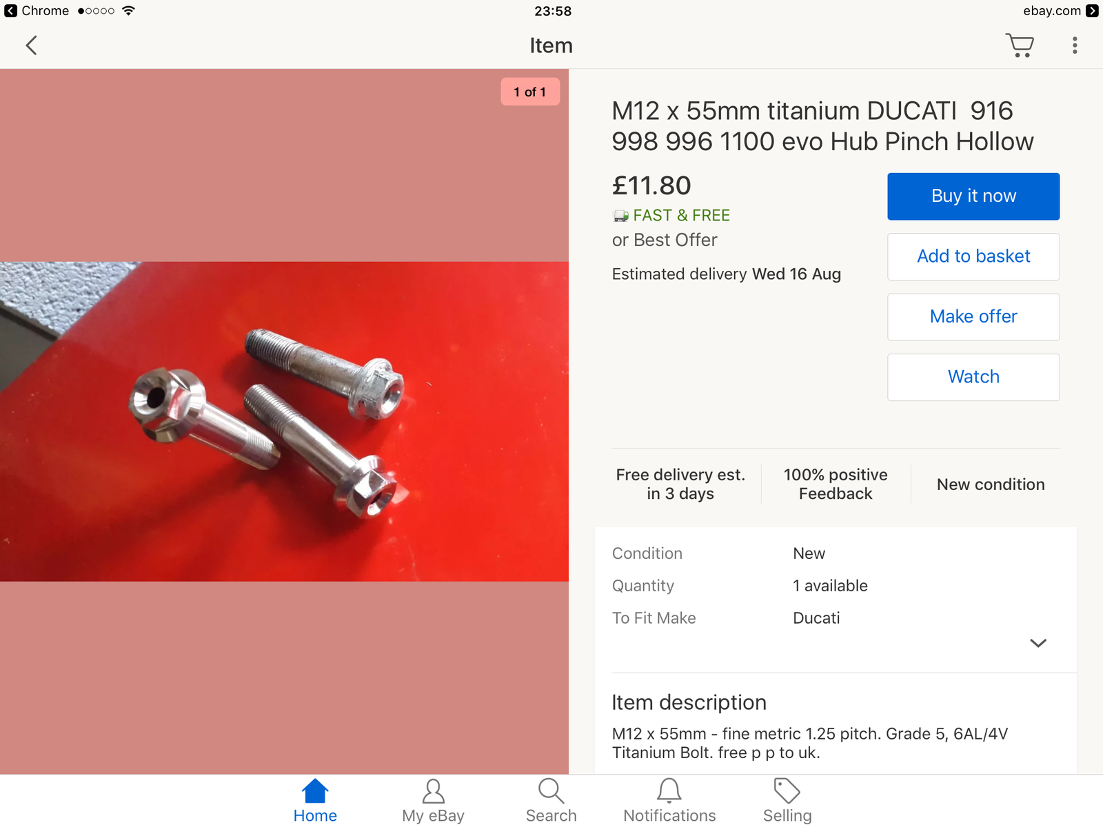

  12. Did anybody come across the pinch bolts for rear swing arm (rear axel ), cannot see anything on Probolt site
    Even if anybody knows the pitch , diameter and length
  13. Thanks Steve
  14. Carlo, the swing arm eccentric clamp bolts are M12x1.25mm, you will need to measure the bolt shaft length for the actual length. When you tighten them up the torque setting is 31Nm (23 ft lbs) and you do them 1-2-1 from the sprocket side although I always torque them up in stages anyway. The threads should be lightly greased otherwise they can bite on the alloy threads of the swingarm and you will get a false torque setting. Personally I would avoid using alternative bolt materials for safety critical parts (brakes/forks/wheels/swingarm) as the ti ones don't have the same properties as the OEM steel ones. Also some of the bolts supplied by Ducati as replacements are surprisingly inexpensive so it is always worth calling a decent Ducati spares supplier to check prices. Craig Richardson at Moto Rapido is always really helpful and very quick to dispatch the items with most of them arriving next day for me.
