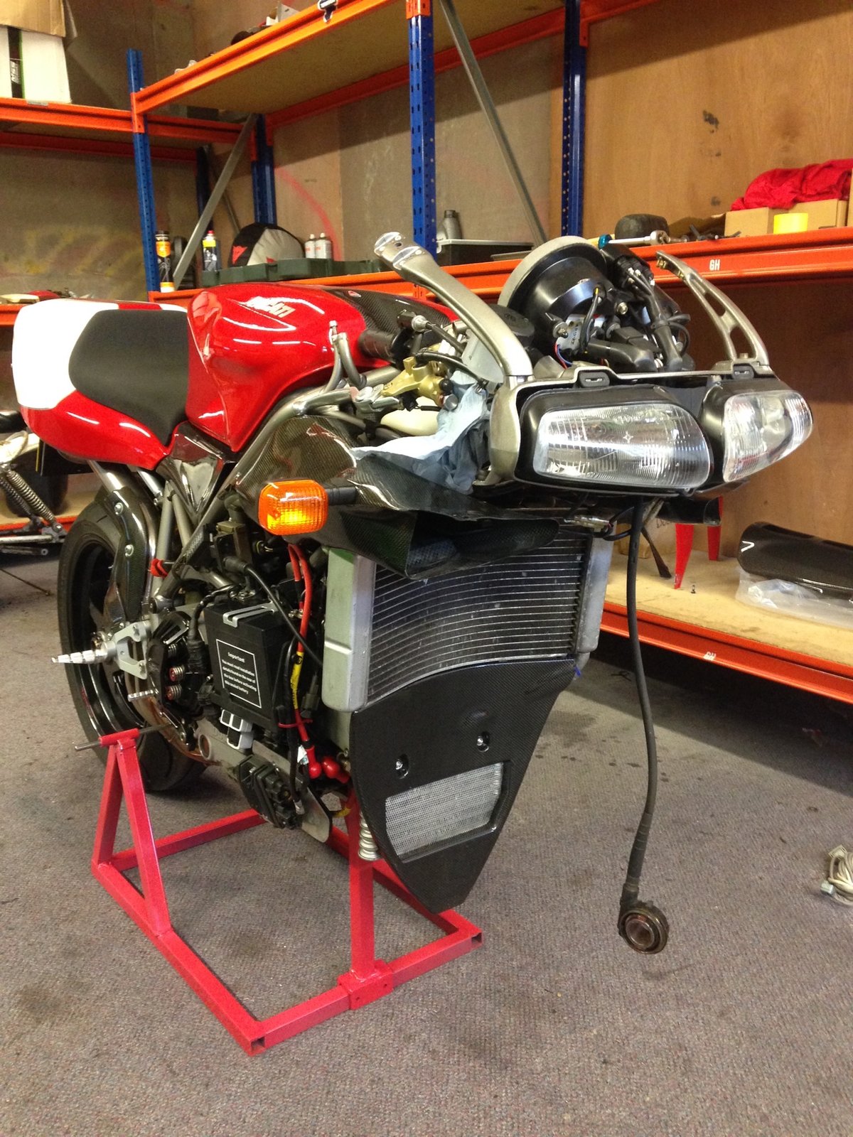

  10. hello Bets,What that frame all about it looks the part where do you buy from?
  11. Re the original posting, the bike has got a 45mm system fitted as standard.

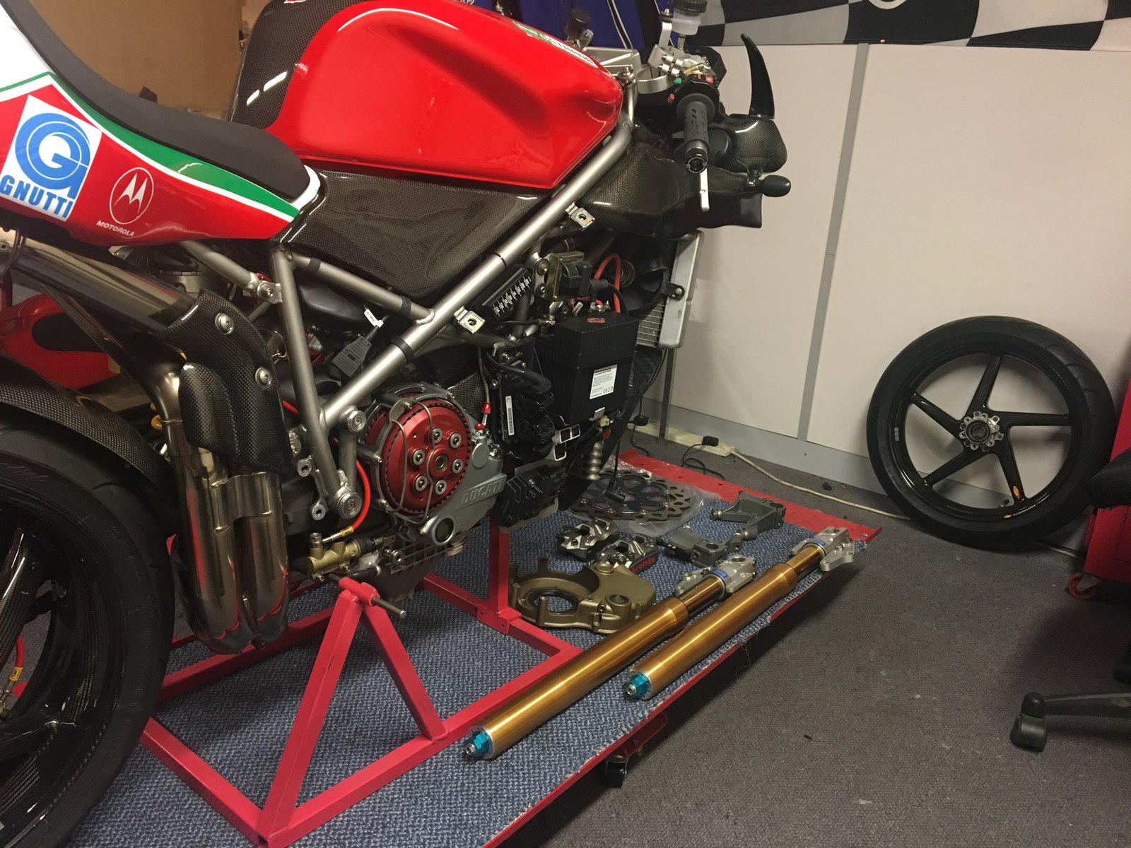

  12. Hi pal. Made it at work. Using it at the mo as changing forks, again! :confused:
  13. very useful item!
  14. Yes, it is. The only downside is you need both front and rear paddock stands to get it on and off. Still only a 2 minute jobby
  15. yes i got front and rear stands i need to pop down to the forge and make one,cheers
  16. No worries pal. Let me know if you need any measurements.
