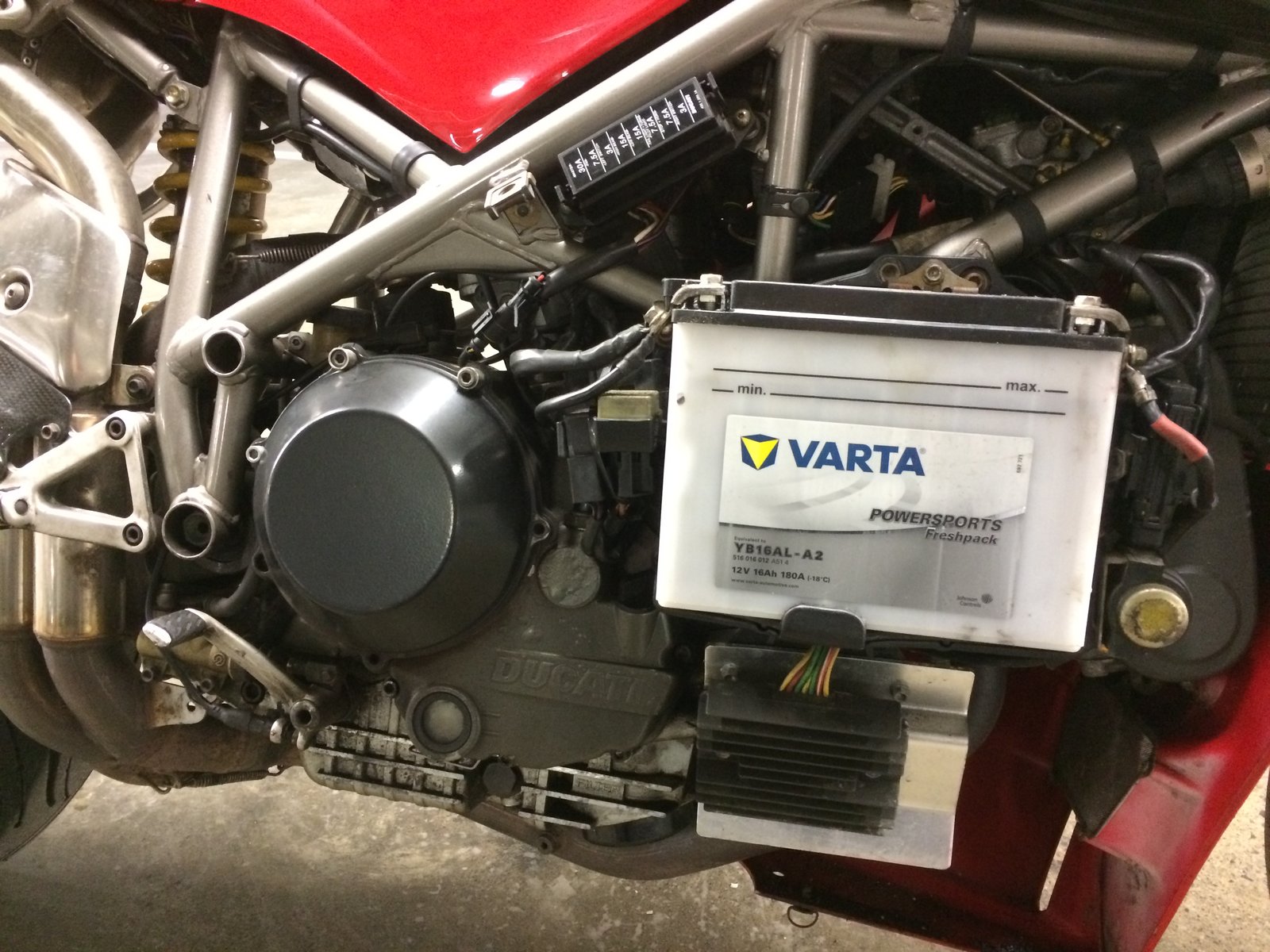

  2. I agree regarding the cables but I would also replace that conventional lead acid battery with a Yuasa AGM type battery as it requires zero maintenance and will give you a lot more oomph for starting.
    I did both these things and my 999 was transformed from a slow and reluctant starter that always threatened to leave me stranded somewhere to an eager instantaneous starter which gives me total confidence whenever I press the button.

  4. Mines a 999, so not the same battery fitment.
    The battery for my bike goes for about 43 squids from Halfords with a Halfords discount card available to Ducati forum subscribers, so would pay for itself with the one purchase.

  5. Thanks , I have a Halfords card! Will take a look
  6. Actually, the same one appears to fit your 748 :)
    Yuasa YT12B-BS Powersport Motorcycle Battery
    £67
    Trade card:
    £43.99 inc.vat £36.66 ex.vat

  8. I will get out the measuring tape , its only a few mm wider but I think I have room on the tray, smaller in all other dimensions
    350 cca, the others have the same CCA , dont see the benefit other than maintenance free
  9. Actually, the dimensions are different, so it may not fit - this is the one recommended for the 748E.
  10. Yuasa YT12B-BS Powersport Motorcycle Battery
    £67
    150x69x130mm for the one fitted to the 999 and the 748E against
    Length 205 mm
    Width 87 mm
    Height inc. terms 162 mm for the big beastie giving 350 CCA
    Yes, looks like you're right. Size for size, AGM wins on CCA but the lead/acid in your bike is larger so both are 210 CCA

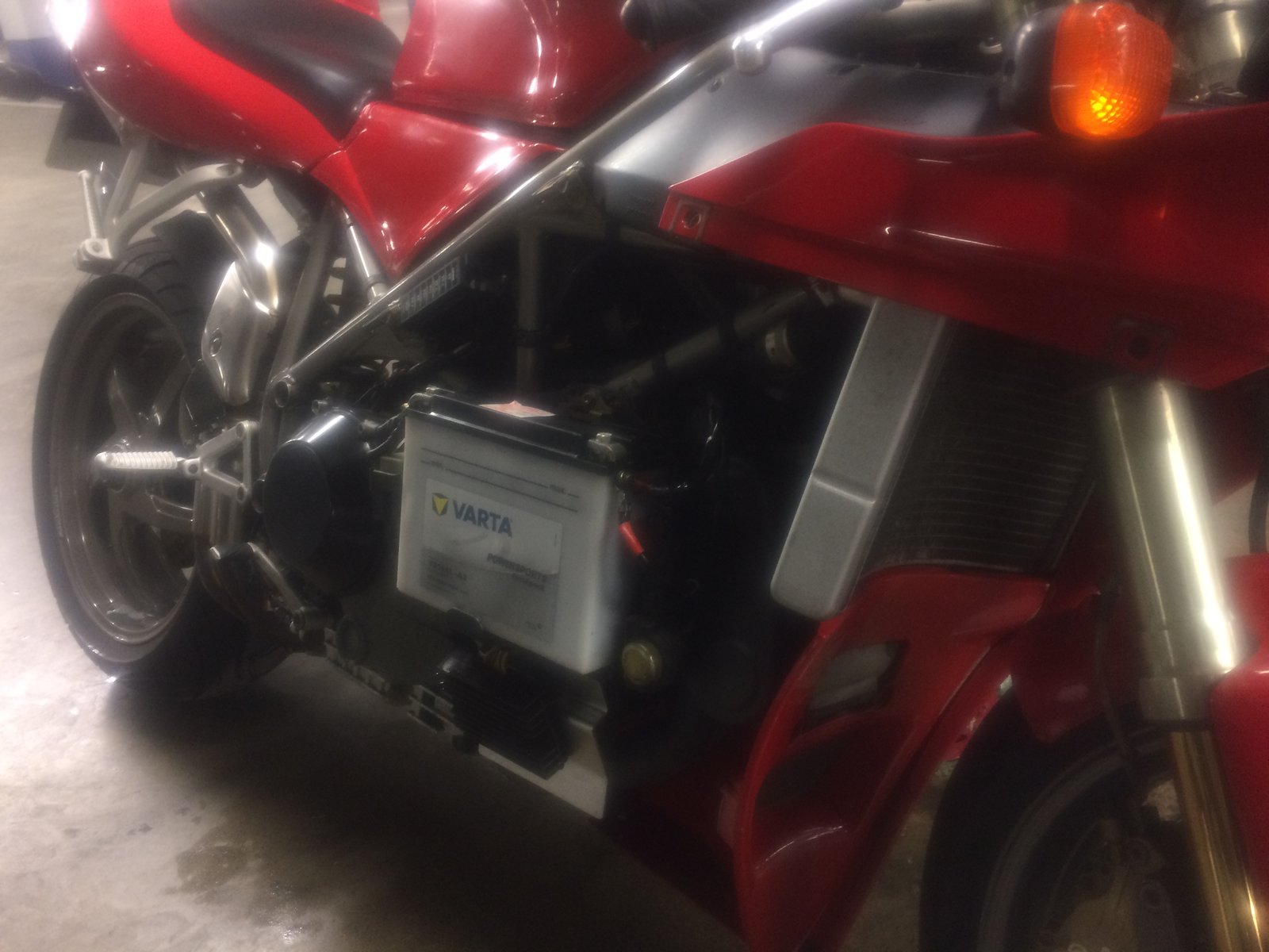

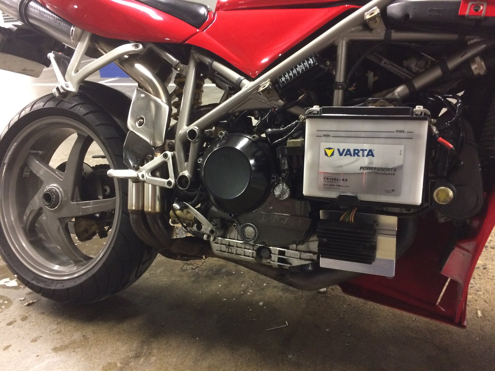

  12. Carlo, you have the older, larger style 916 spec 16AH battery fitted, the YT12B-BX AGM (which was fitted as standard from 01 onwards) will work but only if you have the small battery box insert moulding (part number was 829.1.270.1A) to raise it up to match the wiring. Have a look at the photos on the first page of this thread and the parts books for MY00 and MY01 bikes to see the difference. You need an equivalent to a YB16AL-AH for a straight plug and play. The YT designation is used for the Yuasa AGM batteries which are much better but will require the later battery box insert to work.
    On that vent you need to keep it clear as it is the airflow vent to cool the regulator/rectifier, the most common break down on the bike is a regulator/rectifier failure due to cable resistance on the yellow wires (dodgy/dirty connectors on the yellow ac wires and heat build up)
