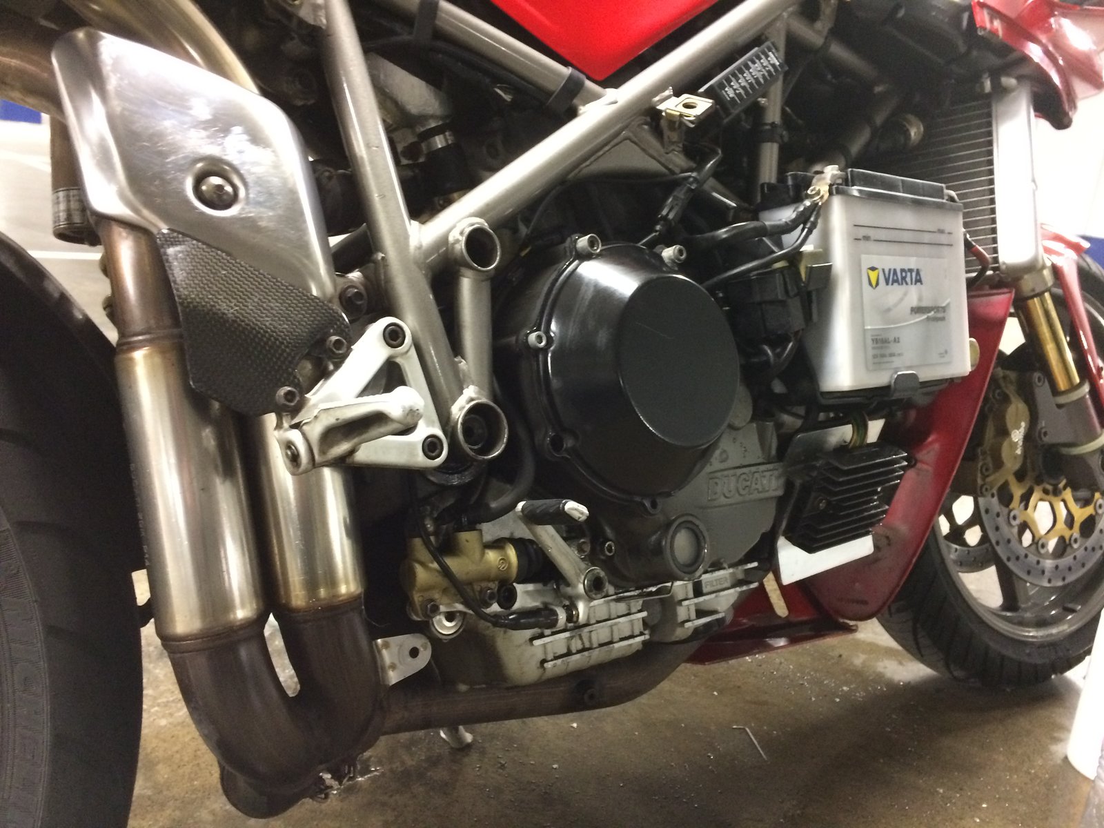

  5. I found some oil on top of the clutch housing , new oil pressure sensor fitted a couple of weeks ago , no sign of a new leak or flicking oil light
    Any common items above the clutch housing, can cause a leak?
    Whats the sensors at the back of the engine casing near the exhaust ?
  6. That sensors the neutral switch
  7. Crankcase breather
  8. Thanks , looks like it has some silver tape around the OE pipe , not too sure if it is a bodge fix or like that from factory
    replace the pipe ? I just cleaned the bloody thing :p
  9. The silver foil is standard fitment, probably a heat shield.
    Steve
  10. Thanks Steve , is this common in terms of I just need to put up with it or clean out the pipe/replace?
    Shes running 15W50 Motul
  11. The crankcase breather can seep oil where it connects to the crankcase, then just check the rubber hose for splits.
    Steve
  12. thanks Steve!
  13. Carlo, mine always has oil film around the breather, nothing to worry about
  14. I cleaned her down with some brake cleaner and took the exhaust off to get it polished
    Will remove the breather and give it a clean, before I go at it , top clip looks very odd
