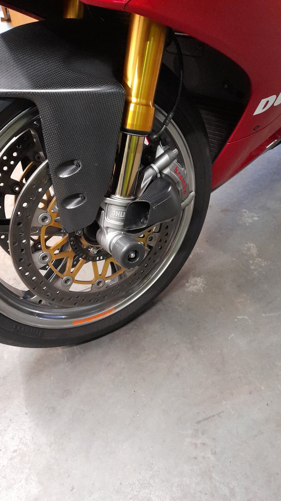

    • Like Like x 7
  4. are they ducati performance parts? I do likey
  5. Yes mate, there the only ones I liked the look of.

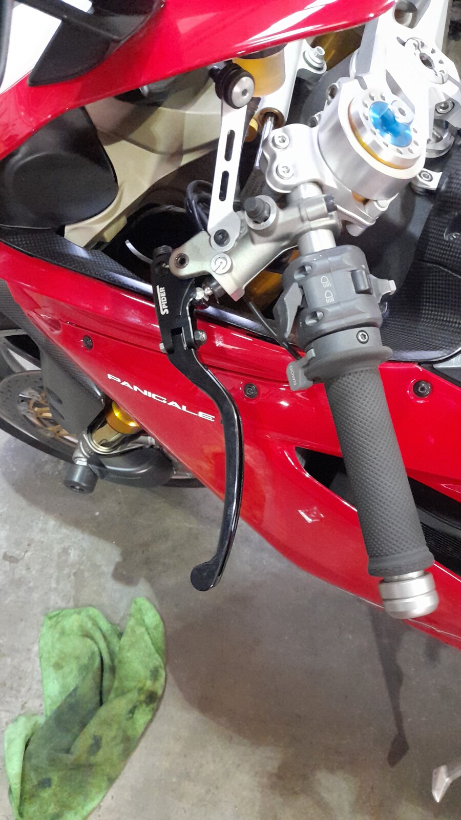

  6. New spider levers on.
  7. Lovely.

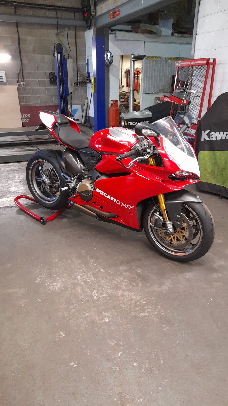

    Get my Pani R back on Friday after 9 months away for a full engine strip and rebuild. Excited.
  8. What was up with it mate??
  9. Going do a post on it sometime. In brief, an authorised dealer misfitted the replacement water pump, which let coolant drain in to the engine oil. Luckily it was only ridden for 3 days post pump replacement in 2019 then parked up for 5 years during covid and while I played on a S1000RR.
  10. Did it do any damage?
  11. Mainly big end shell scoring, which were replaced. Thankfully the crank etc was ok. The oil had turned in to what the mechanic best described as slugs, and bond itself on to all the internals. From the rockers to the gearbox everything needed stripping and cleaning. It was a big bill.
