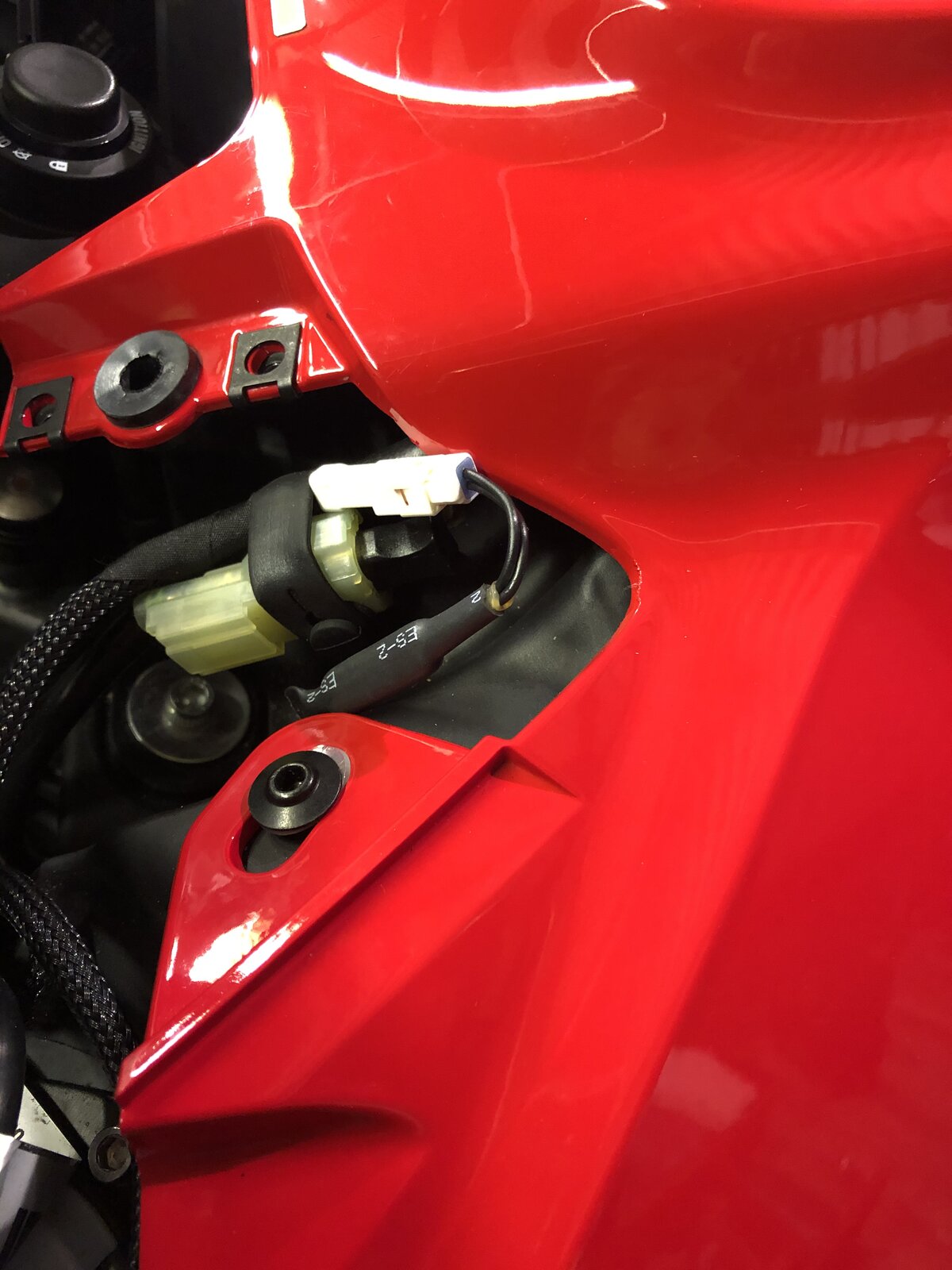

  1. When I looked at mine, the plug etc was near the fuel pipe assy under the left cover you removed. Post pics. It may be that you’re just not seeing it.
  2. Sorry, is that it above and if it is what do I do with it?
  3. Yep, that’s it. Unplug it and solder sat nav wires to it. Job done.
  4. You’ll need to remove from bike. Strip the black outer case off to expose the two wires and then solder together. Insulate either with shrink fit or self amalgamating tape.
  5. If you just put the ‘sealed’ end in hot water it softens and you can pull the wires out ready to solder. Make sure you get the positive and negative right
  6. Thanks all :upyeah: No such thing as a stupid question but how do you know which is live when both wires look black?
  7. Turn bike on and use a Multimeter or 12v bulb and a piece of wire to earth it.
  8. The lead that comes away from the bike doesn’t show + & -, however the part on the wiring loom does. So plug the lead back in and mark the corresponding cable with piece of tape.

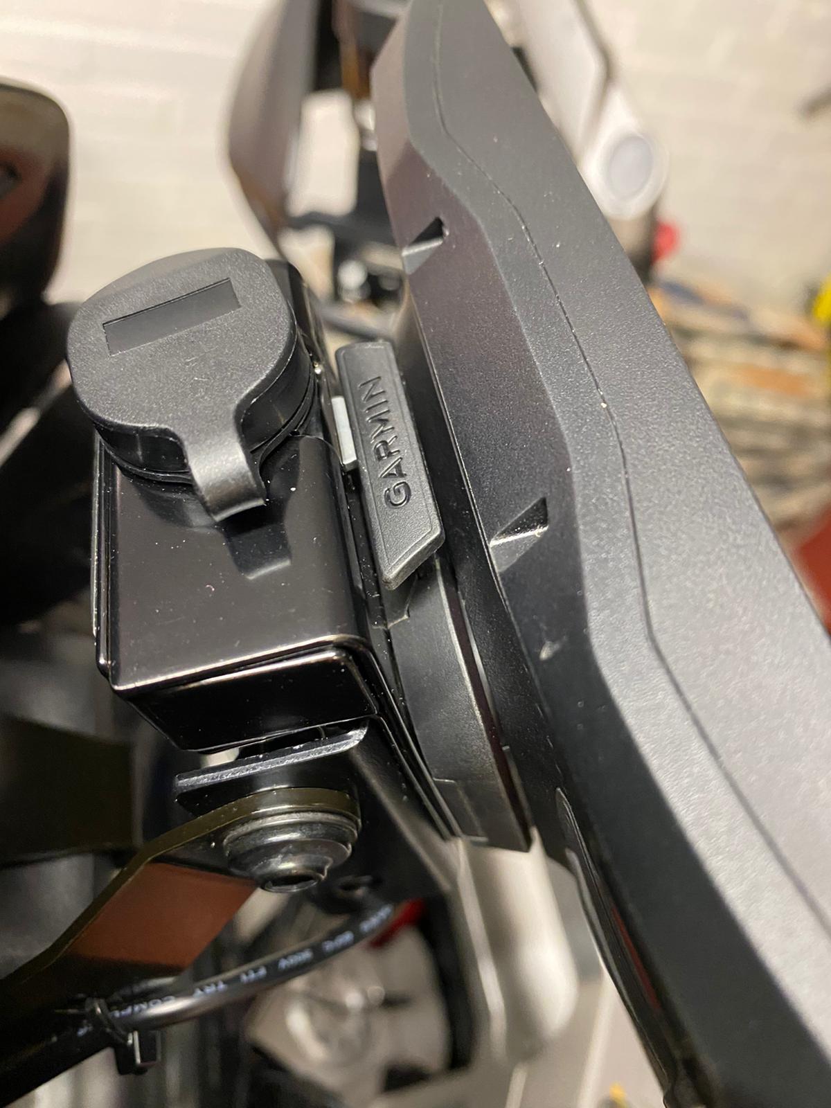

  10. I’ve not read the entire thread, but I fitted a Zumolock yesterday, so don’t have to keep removing it from the bike every time I stop now.
  11. Can you post some pics, was thinking of getting a zumolock to fit to mine
    Thanks
  12. Here you go, this should give an idea...
  13. That looks ok
    Best get myself one
  14. It’s simple, but will keep the nag nice and secure. I looked at the Touratech mount, but it was HUGE!
