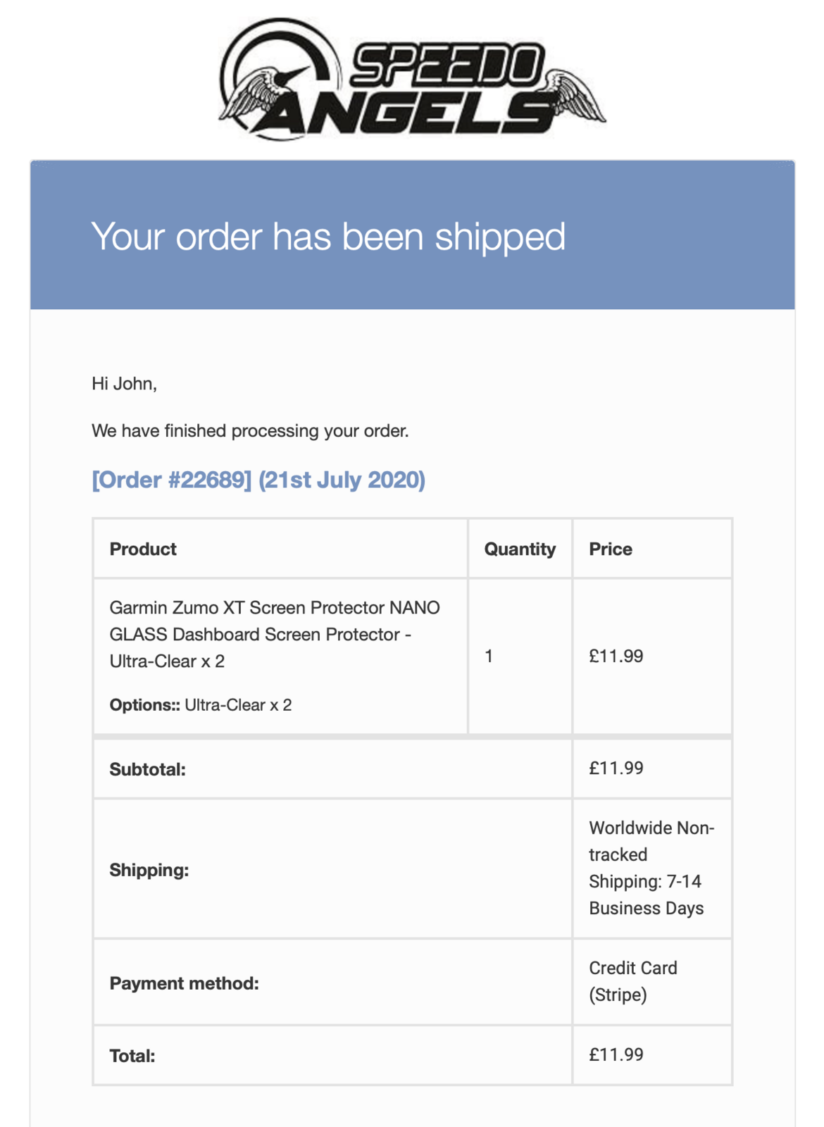

  2. ordered the Speed Angels Nano Glass screen protector for my XT ... have their screen protector on the dash of my 1260s ... it's brilliant. 1.png

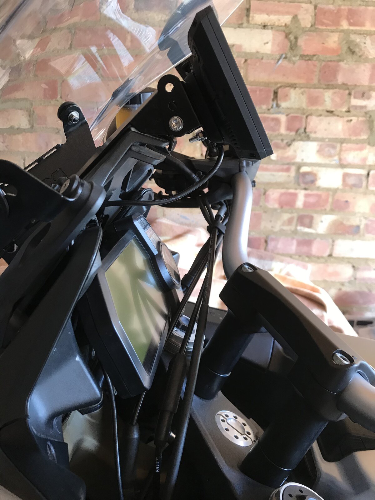

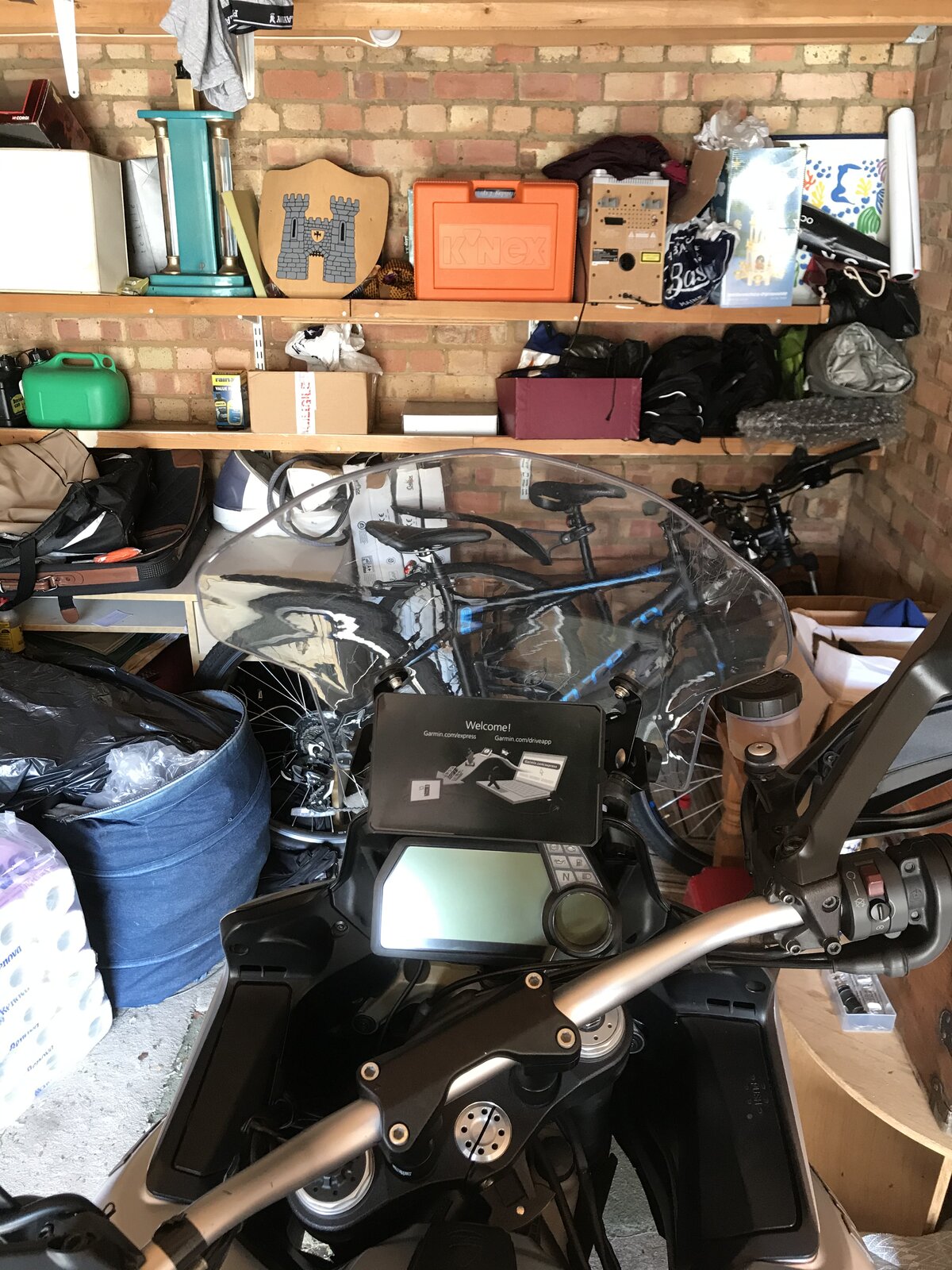

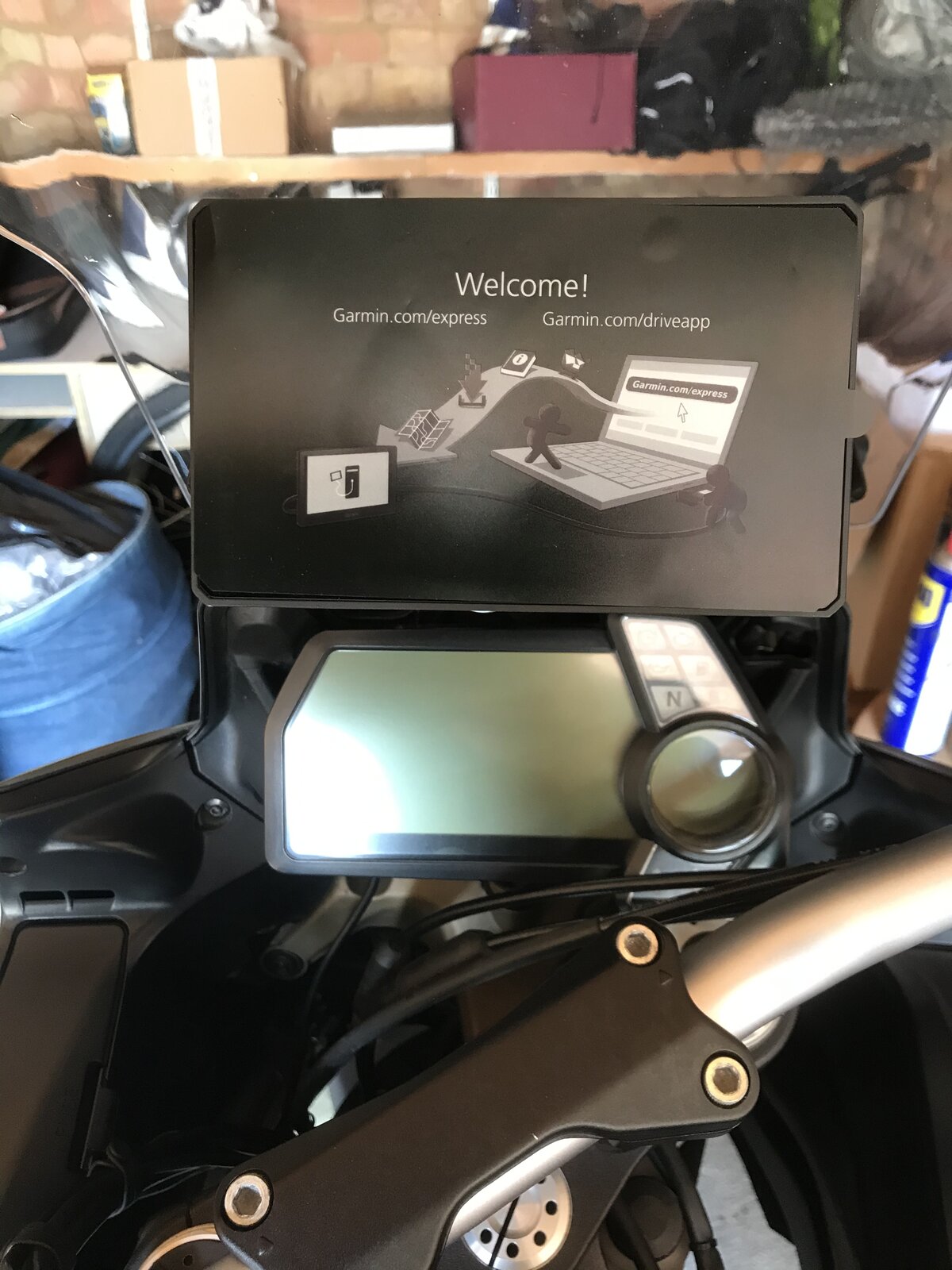

  4. Have look at my opening post there are pics of mine with an Evotech mount.
  5. Thanks for the pictures in picture 1 the sat nav looks quite big is that the case or is it just how the picture was taken
  6. the Zumo XT is BIG! and that's a good thing for these old eyes.
  7. It is only slightly bigger than my 660 in overall size but the screen is larger.
  8. And I think it's the angle/closeness of the camera too. But yes, screen area is bigger relative to the outside dimensions of the XT compared to my 590.

  15. Hi.
    The first photo is taken from in front of my eyes, might give you an idea of the frontal view.

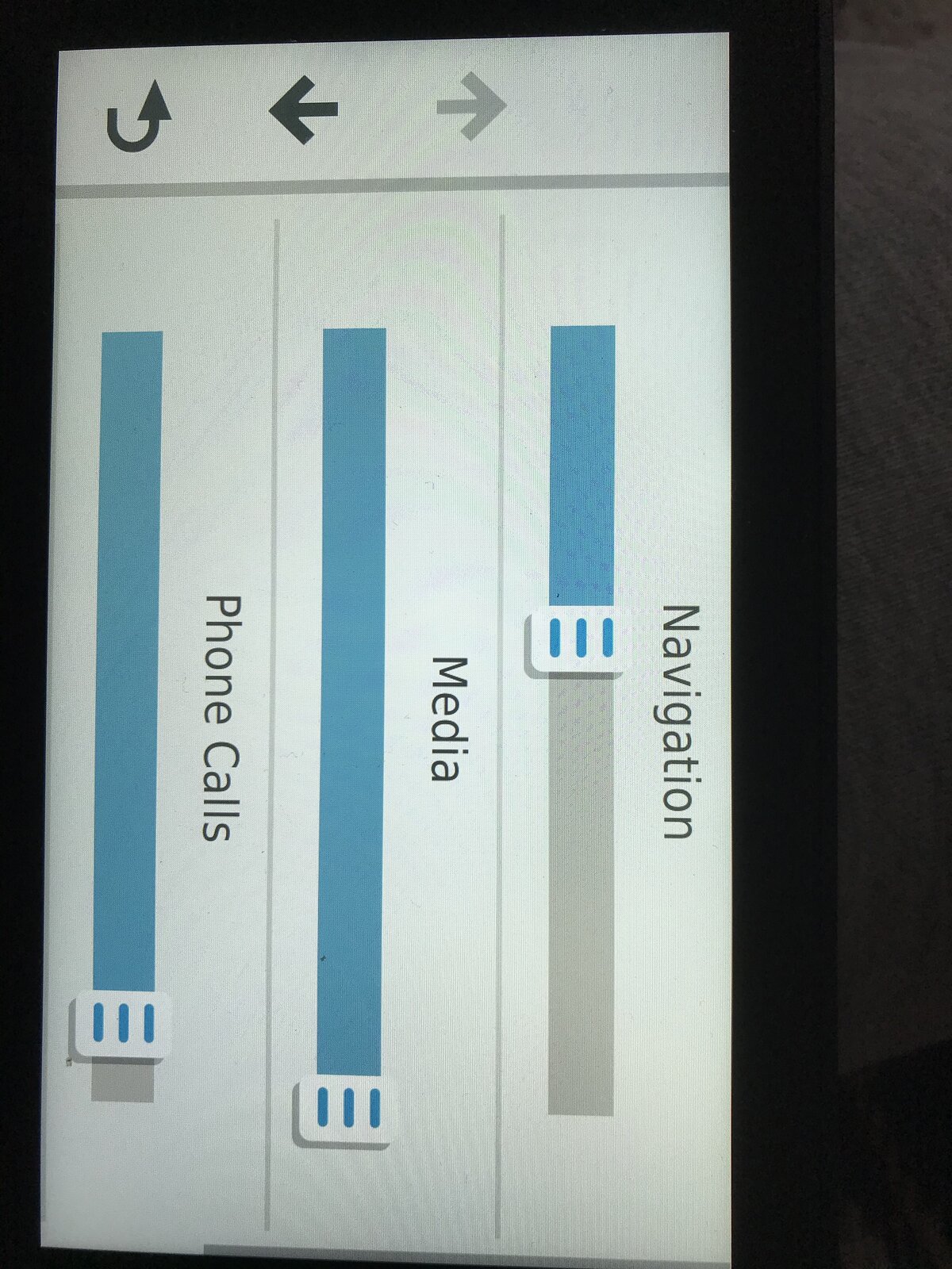

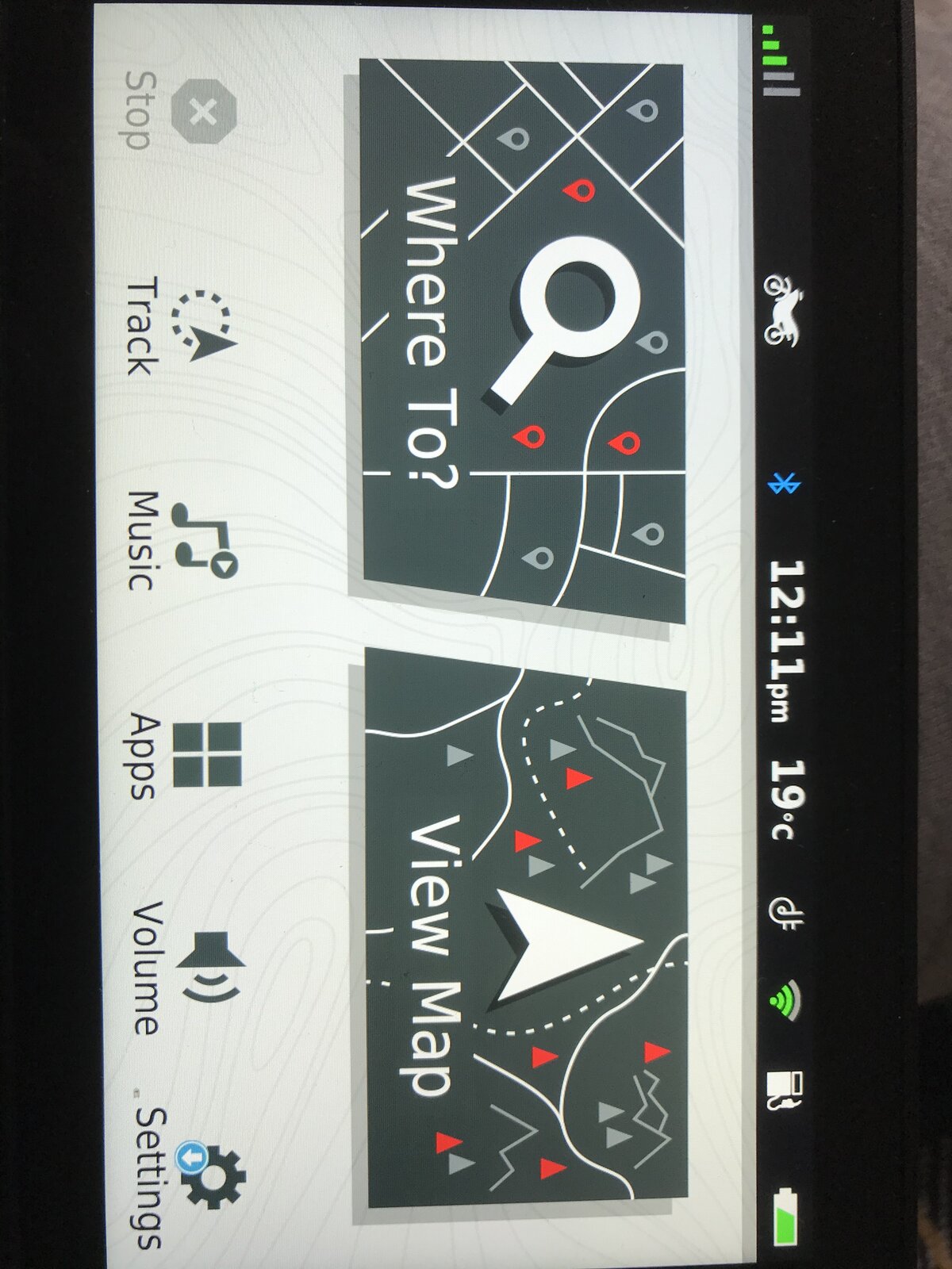

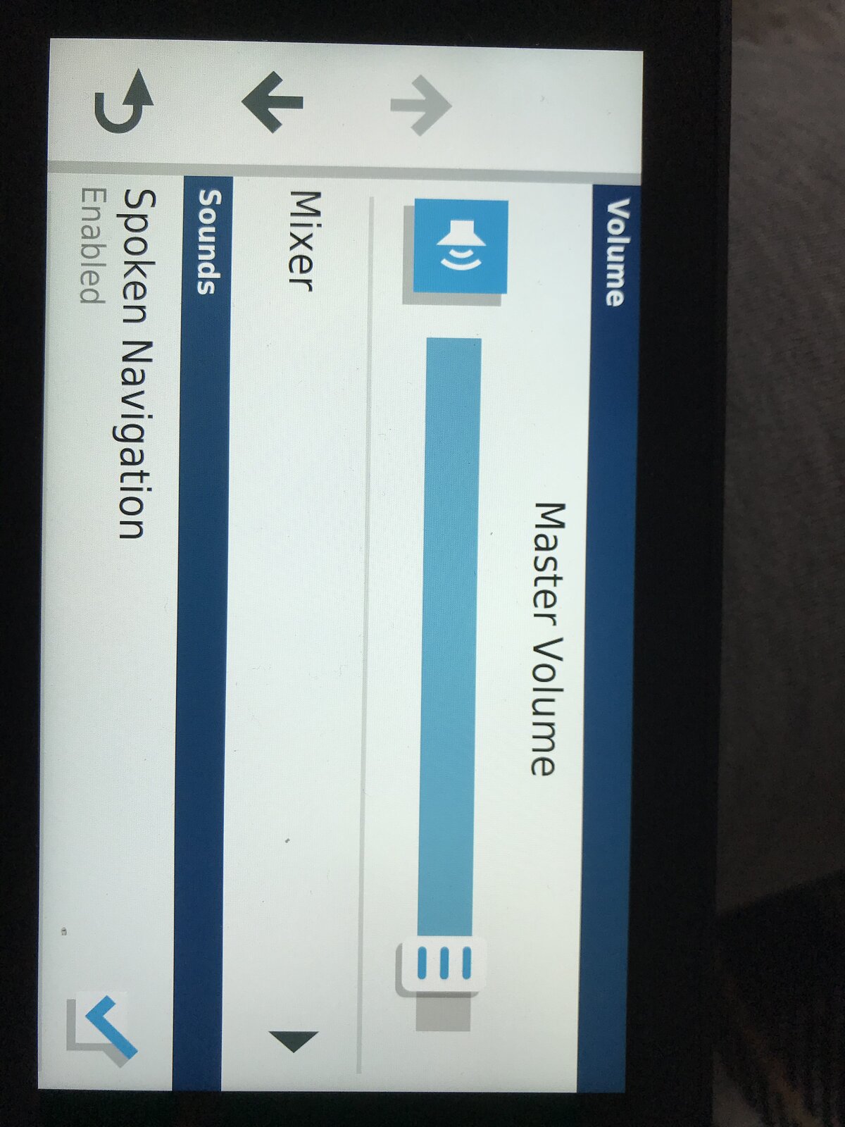

  18. On the XT itself there are multiple choice volume settings for media which for me is music, phone and navigation.
    From the home screen select Volume. Then select mixer and play away.
