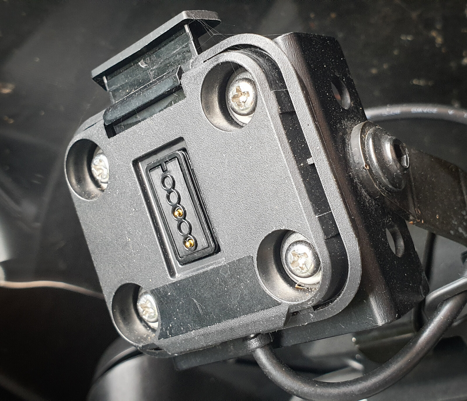

  12. I have looked at this Satnav as the 590 I use has a small screen and used as a rolling map, not always easy to see detail. The only reason I havent made the change yet is I cannot determine how it connects with the mount power supply. Is it a simple two pin feed / return (5V live and neutral) per the 590? Any chance you could post a photograph of the power input point to the Satnav?
  13. Just found the manual on line showing a five pin mount, so needs some cable work to make the change. Easily enough sorted though. Just looking for the easy option!
  14. Bike cradle only has two active pins.
    Car cradle relies on the USB for powering the XT... Not sure what the three other pin pads on the back of the GPS are for...
  15. That's interesting. Thank you. Looks as if it will be compatible with existing two pin system?
