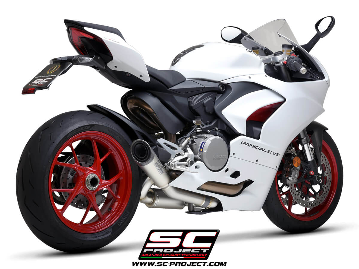

  13. Why the tunnel vision on Akra or Termi???
    Check out the number of bikes across the classes at Grand Prix level that run SC-Project. They are a precision made product and for a V2 only 1400GBP give or take. You want your heads read.
  14. Thanks for the helpful comment.
    For me, Akra was the only one available and the official upmap it comes with I guess is the reason for the huge price.
    Also - re SC Project the only ones of those I've heard have been on a friends MV F3 - and it was hugely loud. I get enough police attention....don't want any more!

  16. I had an SC Project exhaust on my Street Triple for 5+ years and I loved it. Seemed like great quality too.
    I bought mine just before they started sponsoring Honda in MotoGP, after which their prices jumped a bit o_O
