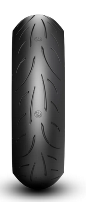

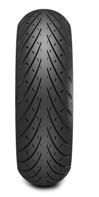

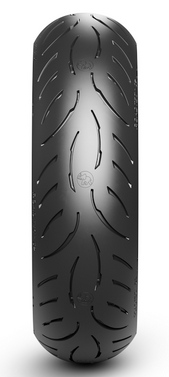

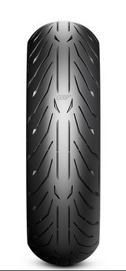

  2. I am quite interested in the profile of tyres to suit riding style - all other things being equal or the same - compounds, silica and all of that technology.
    Difficult to tell from the pictures but the new Roadtec 02 looks to be similar in profile to the Roadtec 01 SE, perhaps a bit sportier - and more rounded compared to the sportier Metzeler M9 RR.
    The Pirelli Angel GT2 looks similar in profile to the Metzeler Roadtecs.

    Roadtec 02
    Roadtec 01 SE
    Pirelli Angel GT 2
    M9 RR

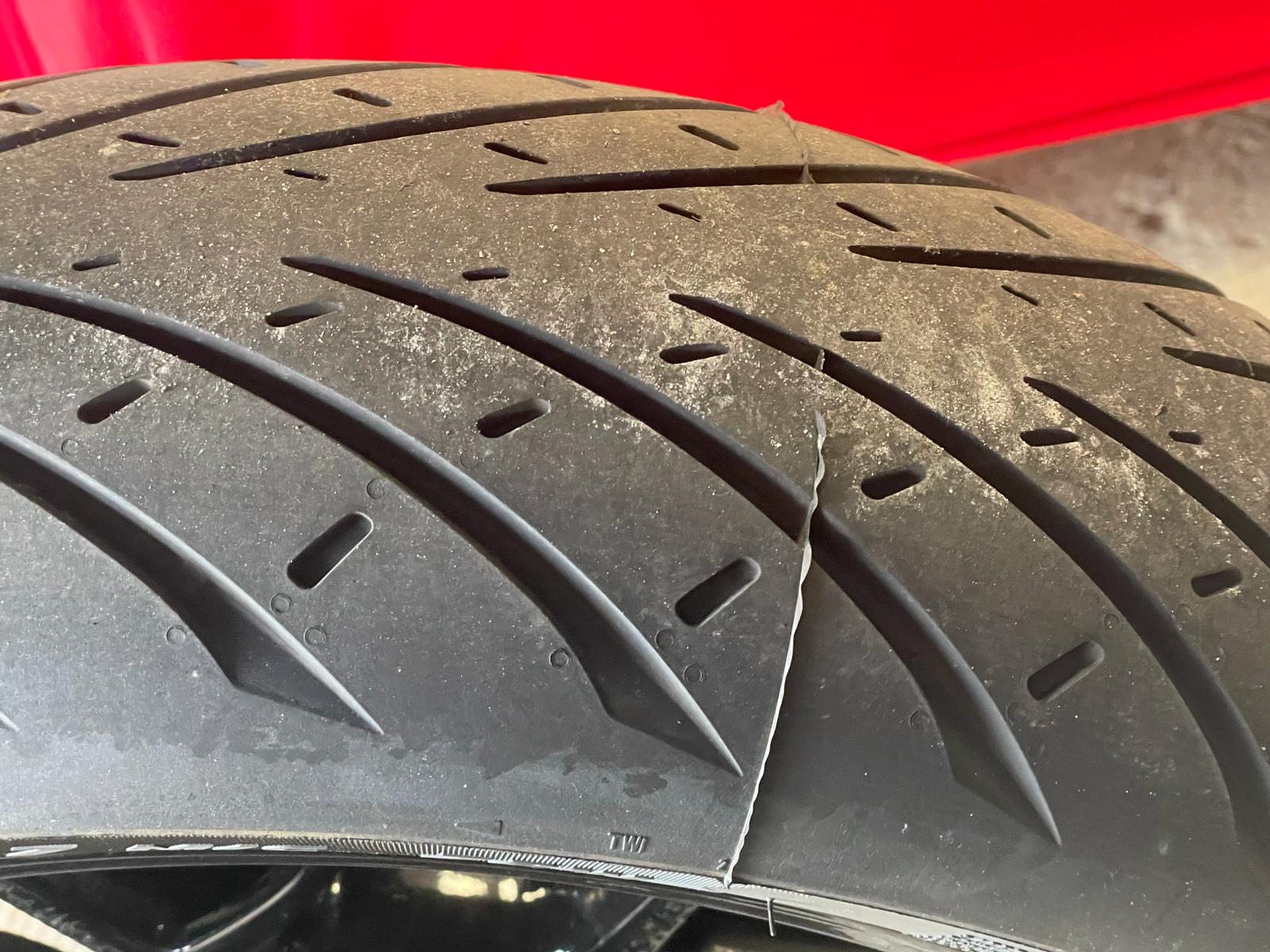

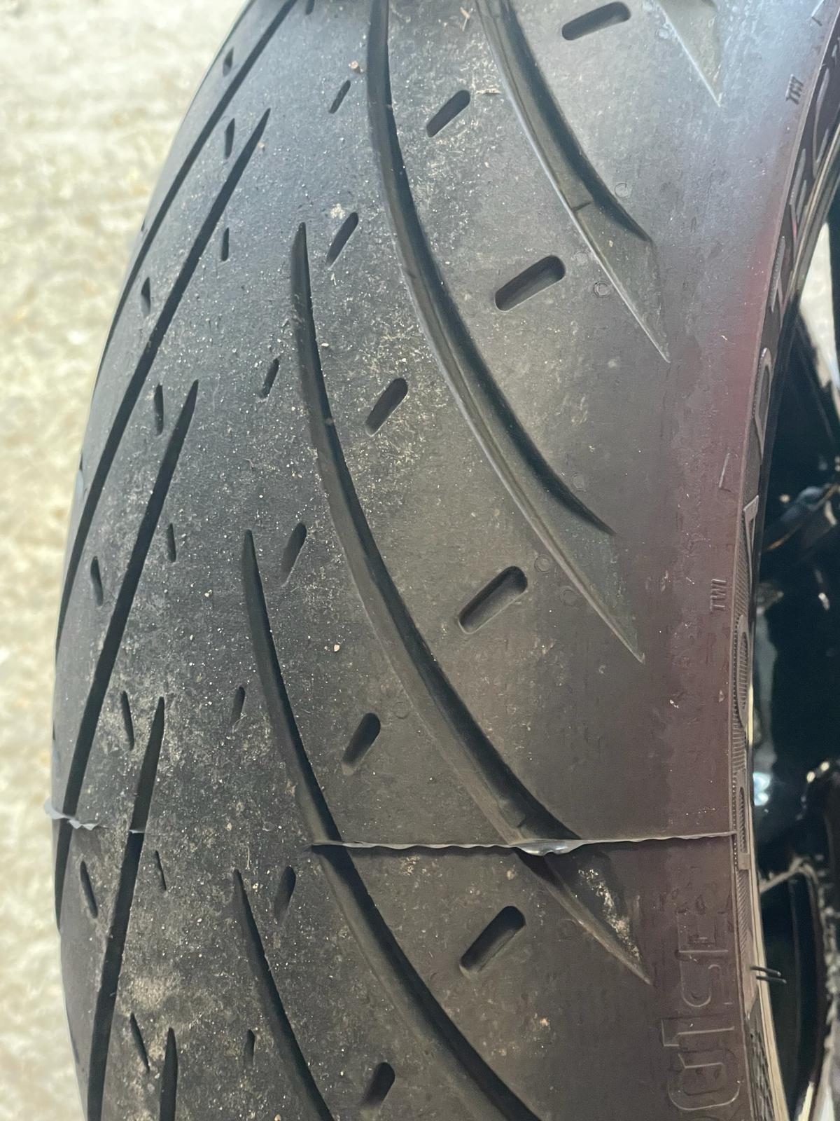

  10. To update this thread, I had the Roadtec 01SE tyres fitted this week. Took the Multi out for a quick 60mile blast today to start scrubbing in the tyres and see what they're like. Have to say, first impression is WOW, what a difference to the stock scorpions. They felt confidence inspiring straight away without them even been scrubbed in yet. Seem to warm up quick and made the Multi feel more agile than with the Scorpions. Only done 60 miles, but well pleased with them so far.
