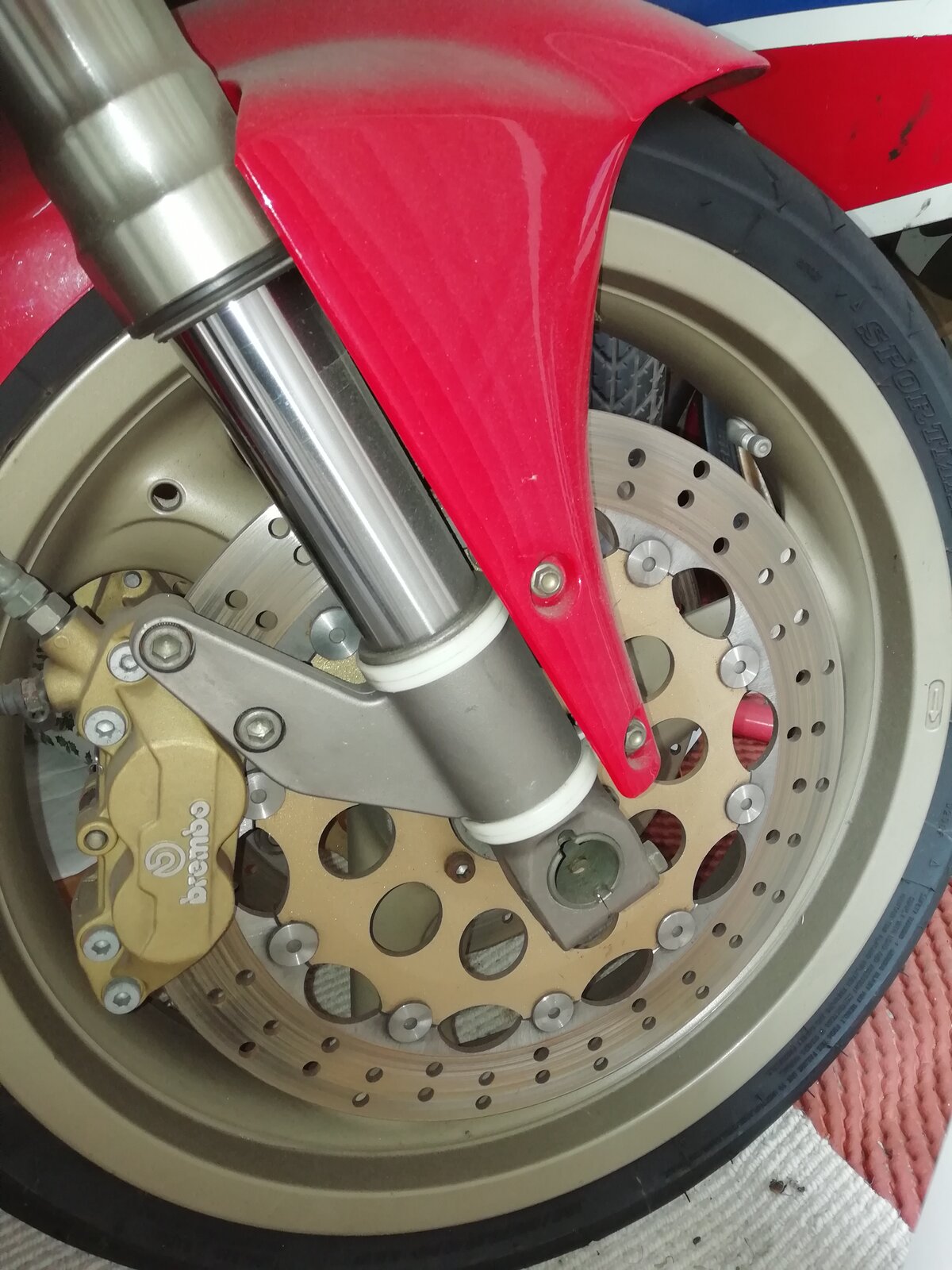

  1. It's the one at bury. Are the brakes wrong?
  2. The sps/sp should have different front discs. Check online pics of them and you will see the difference.
    Maybe it’s just the pessimist in me, but why would a 4K like bike have none original rotors fitted?
    Or as I said I’m no 748sps expert and things changed year to year so someone will probably say that’s fine for the year.. but certainly 96 and 98 on had different rotors cast iron so why not this one..
  3. There getting on a bit now so could have warped disc , my 996 has one so changing them for hpk brembos, but il keep the old ones in case I ever sell it.
  4. Yeah I agree. Why change the brakes. So this could be a sps replica.

  11. One other thing, when did the forks bottoms change for the different callipers?

  12. Yeah well spotted. Looks like it a a had a new front end maybe . That's if it's a sps. Fastline in Preston have one which I've seen. Looks proper but it's a Japanese import which put me off.

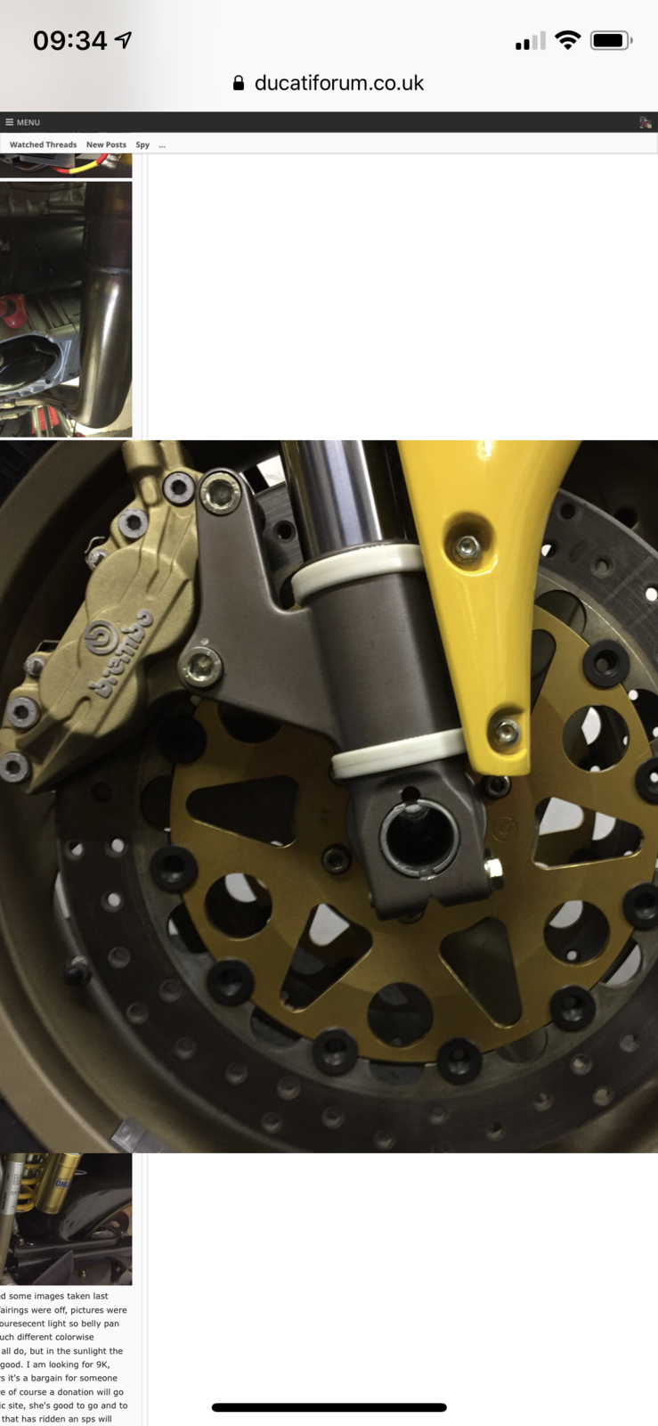

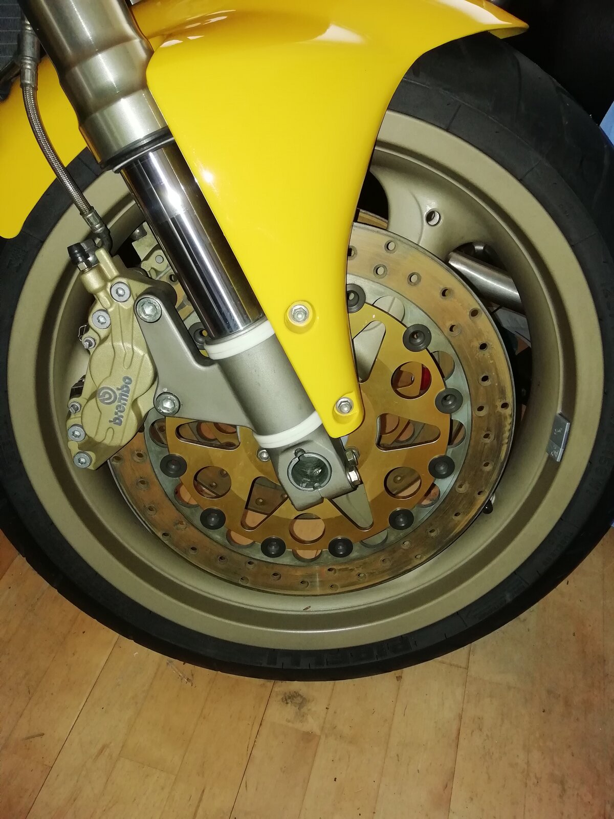

  19. The discs appear to be standard steel discs from the late nineties, I have them on my 1998 reg 916, on SPS they should be sat iron fully floating. I"ll try and sort pics of both types.
    First is a '99 SPS (I've got conf from the factory) and second is a'98 916. You can also see the difference in the calipers mounts. If the front end is wrong then either it's been crashed and replaced or it's not a genuine SPS?
