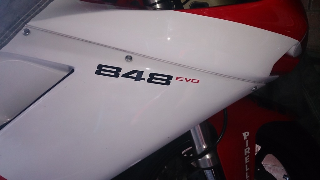

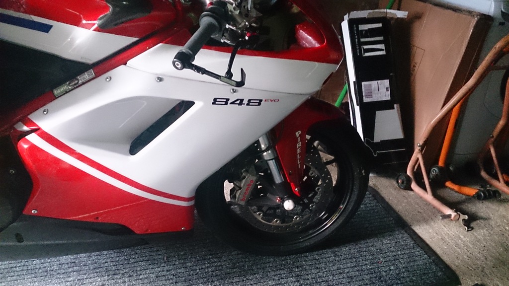

  1. Sneaked a bit of free time as I wasn't happy with the fairing lowers. They were secured with screen bolts and the rubber grommets associated, the bolts were made of Camembert and I wasn't entirely happy. I also got the bracket for the bolt behind the sidestand that secures the fairing lower to the back of the engine.
    So, I picked up some D-Zus fastner backing plates and with a bit of work the lowers were fitted. Sadly, it was also using the crappy screen bolts on the 3 that are the bellypan section and you had to be a 3 year old child to get them off too as you needed a short allen key... Not happy with that either, so a quick bit of drilling on them and they were also installed with 3 dzus fasteners. However these ones are the ring-pull type, so much easier to get off.
    I then had to do a bit of trimming on the fairing as the lower panel rubbed on the gear selector linkage, so that was trimmed neatly and re-painted with touchup paint. Looks good.
    All in all I now have a completely sectional fairing so can be removed piece by piece instead of 1 massive piece here and there, I can remove any section quickly and easily.
    Pretty happy with that actually... Looks good and very functional
  2. Finishing touches :)
