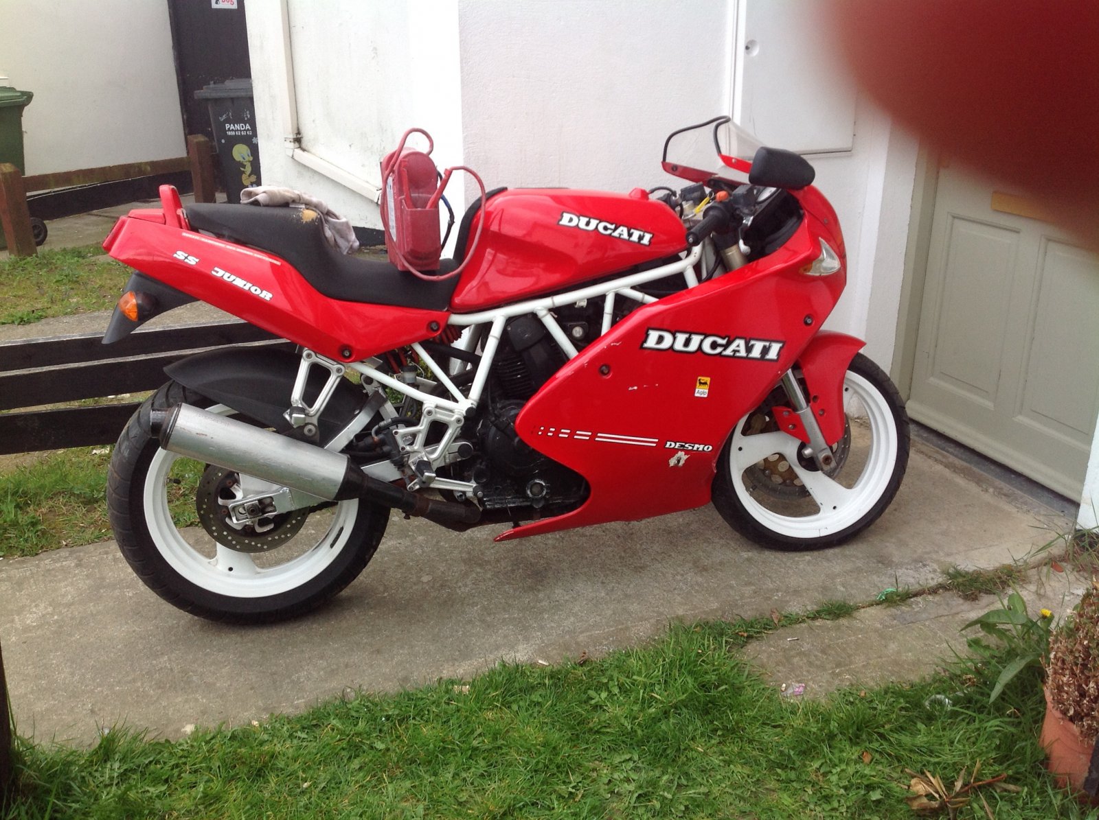

  11. I have a 91 Ducati 400 desmo ss jr for sale, if anyone wants to make offers.. 10,000 miles, mint cond
  12. That's the same as mine, but I got it from Belfast.

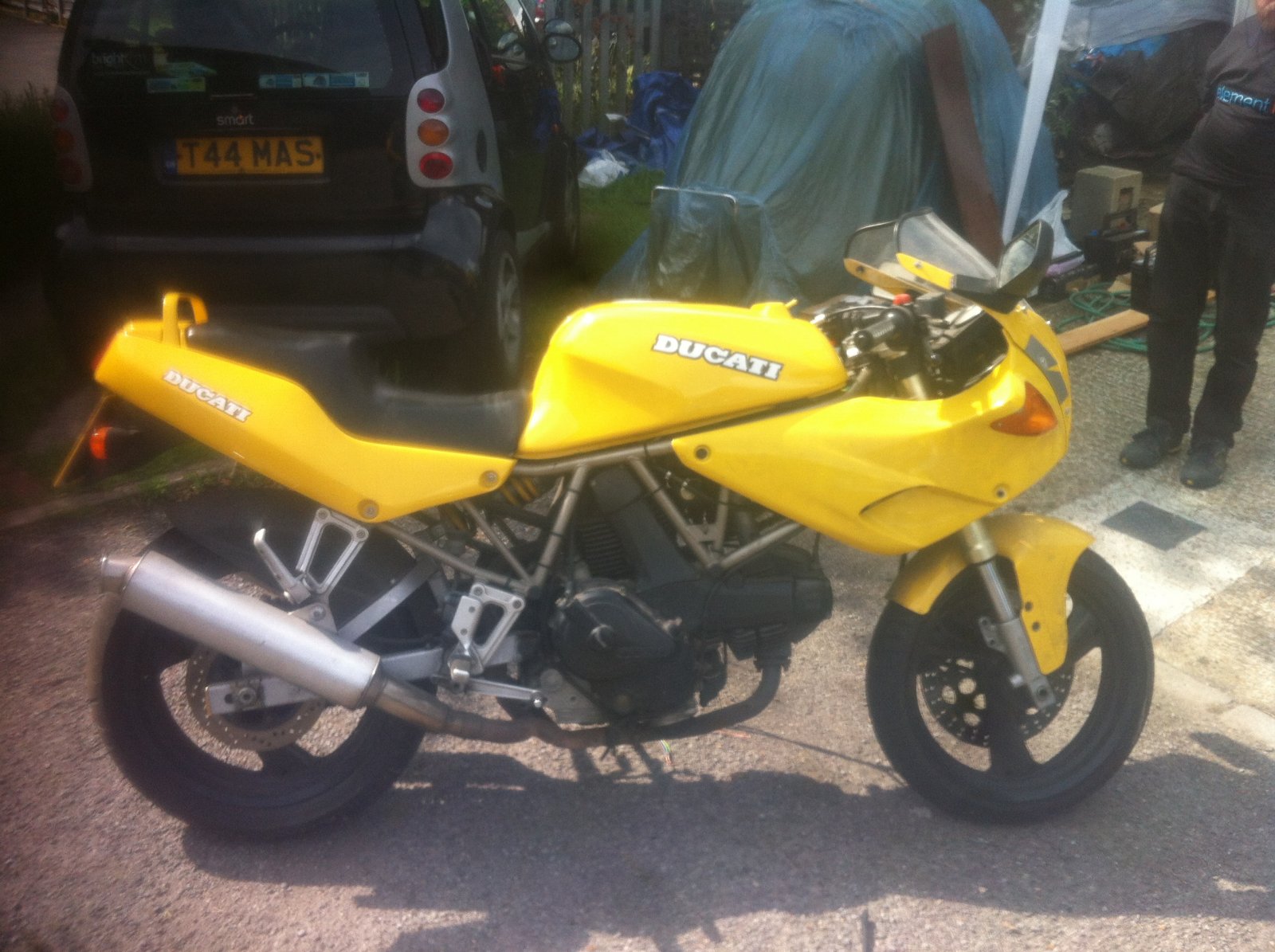

  13. Hi all, sorry to drag up an old thread but thought I'd keep things relevant.
    I have a yellow 400ss that is a partial runner, I believe it has some issues with the carb as it can sometimes cut out whilst riding and won't start again until cooled.
    It also has an issue that if it's warm you have to remove the air filter before it will fire up properly.
    I'm looking for any advice as to what the issue might be but also if anyone is in the market for buying.
  14. Very nice, I have sent you a PM. It was always a big ask to get the little 400 to run on the 38 mm Mikunis - same as it's bigger relatives and overall it does admirably well considering, but there was always a chance that it would suffer from 'rich' related problems if out of adjustment. of course it could be so many things as usual, but in particular with regard to rich running the following: – main needles and jets worn or distorted:choke sticking on on one or both carburettors/float level(s) set too high, could even be that someone has fitted whole carbs or possibly primary/main jets etc destined for bigger engined models as they are more easily available.
