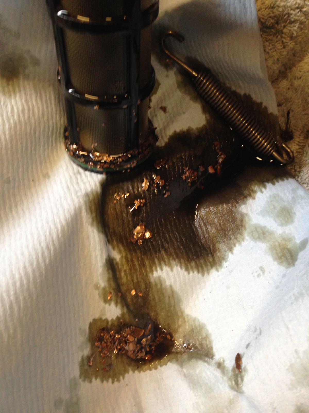

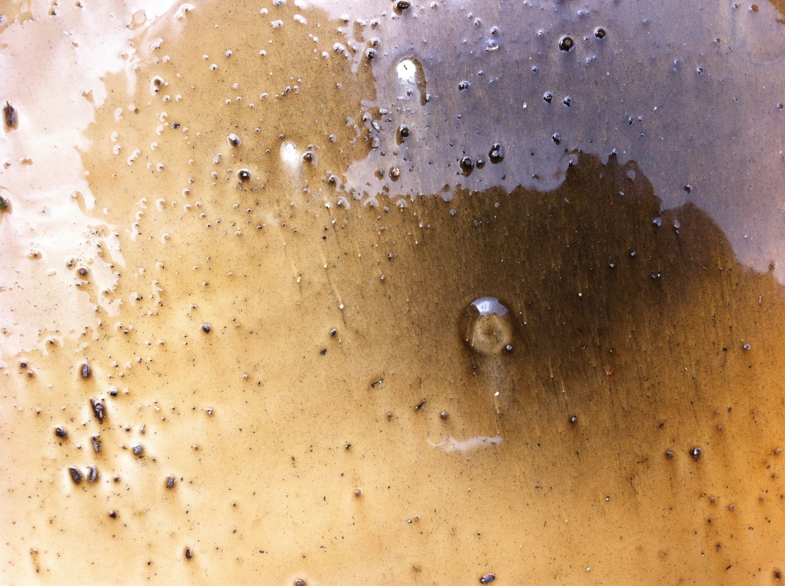

  10. Oil and strainer are out.
    Full of copper/brass big end bearings defiantly had it
    Just hope it hasn't damaged the crank.

  11. Oh dear mate that's not good. I'd prepare for the worst, usually when the shells are that bad the crank will have worn but as you said fingers crossed it can be reground.
  12. Nasty....I had the same on my old bike....:( Fingers crossed the crank is ok.

  19. Always sad to see these types of photos. Fingers crossed that a rebuild is possible with crank etc. Or would a new engine be more economical? I don't know.
  20. Oh the memories.... been there got the t shirt.
    And how did that springy exhaust thing get in there! Weird!!
    Ducati John. Good lad. Or MotoRapido if you fancy upgrading performance.
