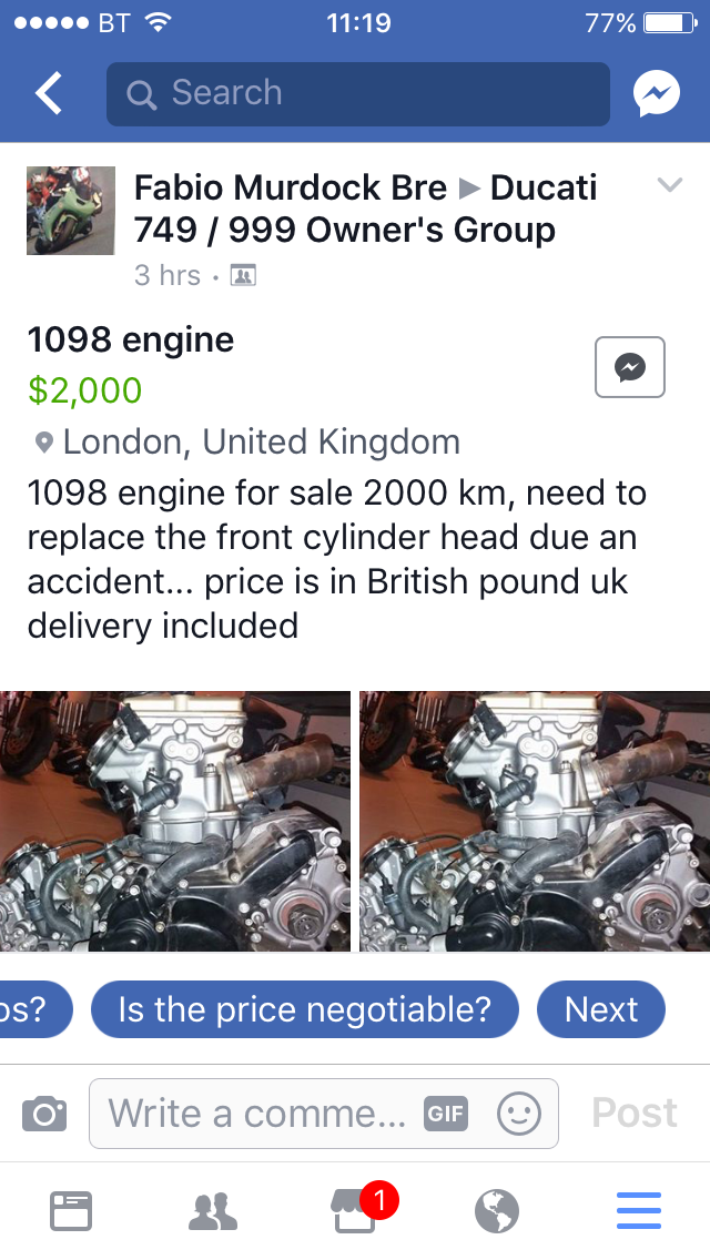

  7. f*ck me, what a chancer! 2k and needs a new head and god knows what the internals are like if its been impacted that much!
