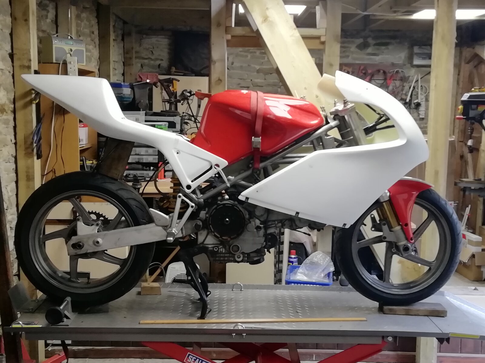

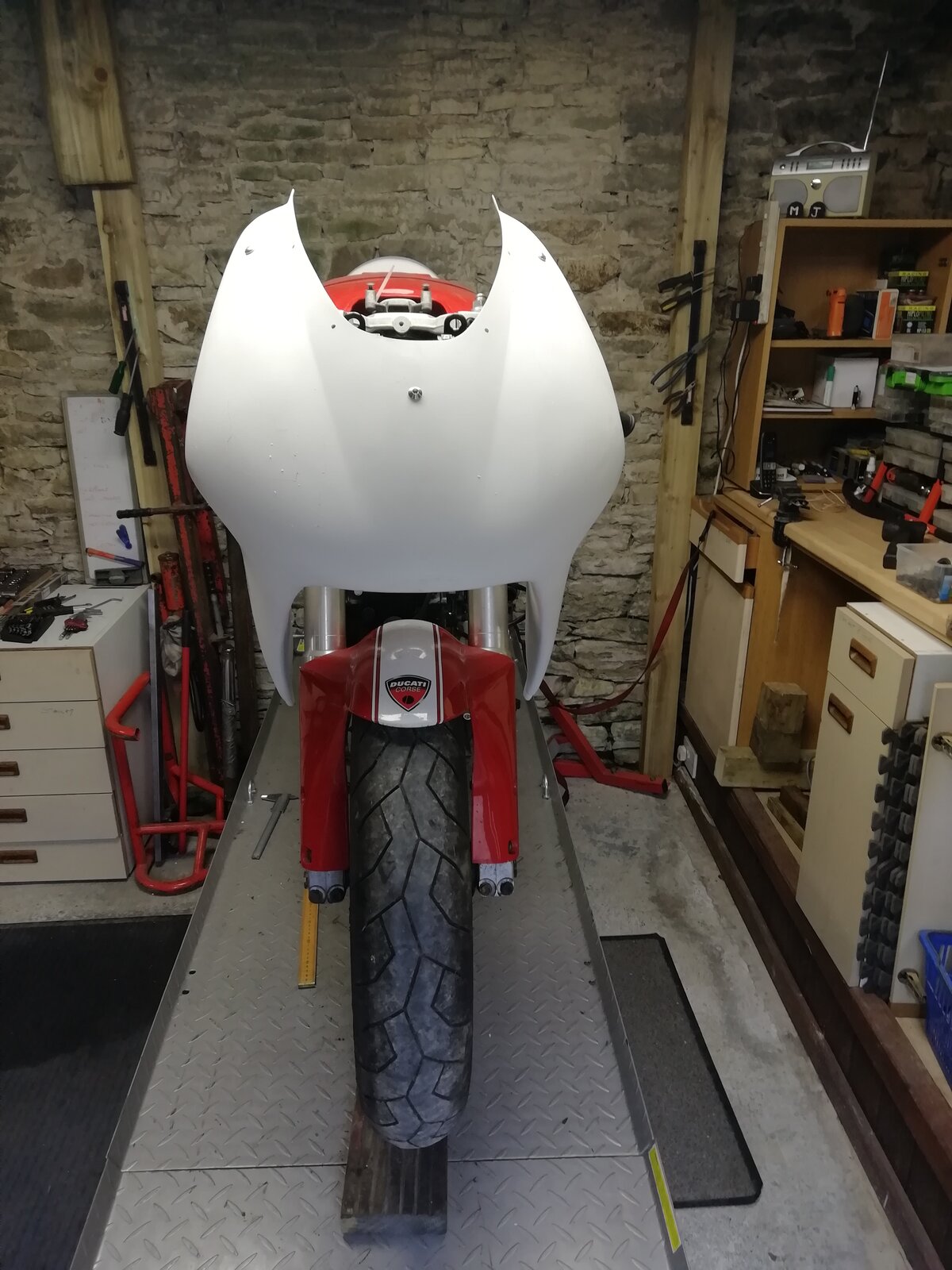

  2. Reservoirs are going to be inboard and master cylinders have plenty of room once the steering lock has been restricted a little.
    The final fixing is done now so fairing is in place.
  3. Touch more progress.
    Seat unit mocked up - nearly. The tank neads a little work to allow the seat unit to move forward another inch or so.
    The original project brief was to use as much of the original bike as possible but make it different. That's why I'm trying to keep the original tank.
    The only reason the foot pegs are there is to check the riding position without putting weight on the seat unit. My thighs are now a little tender!

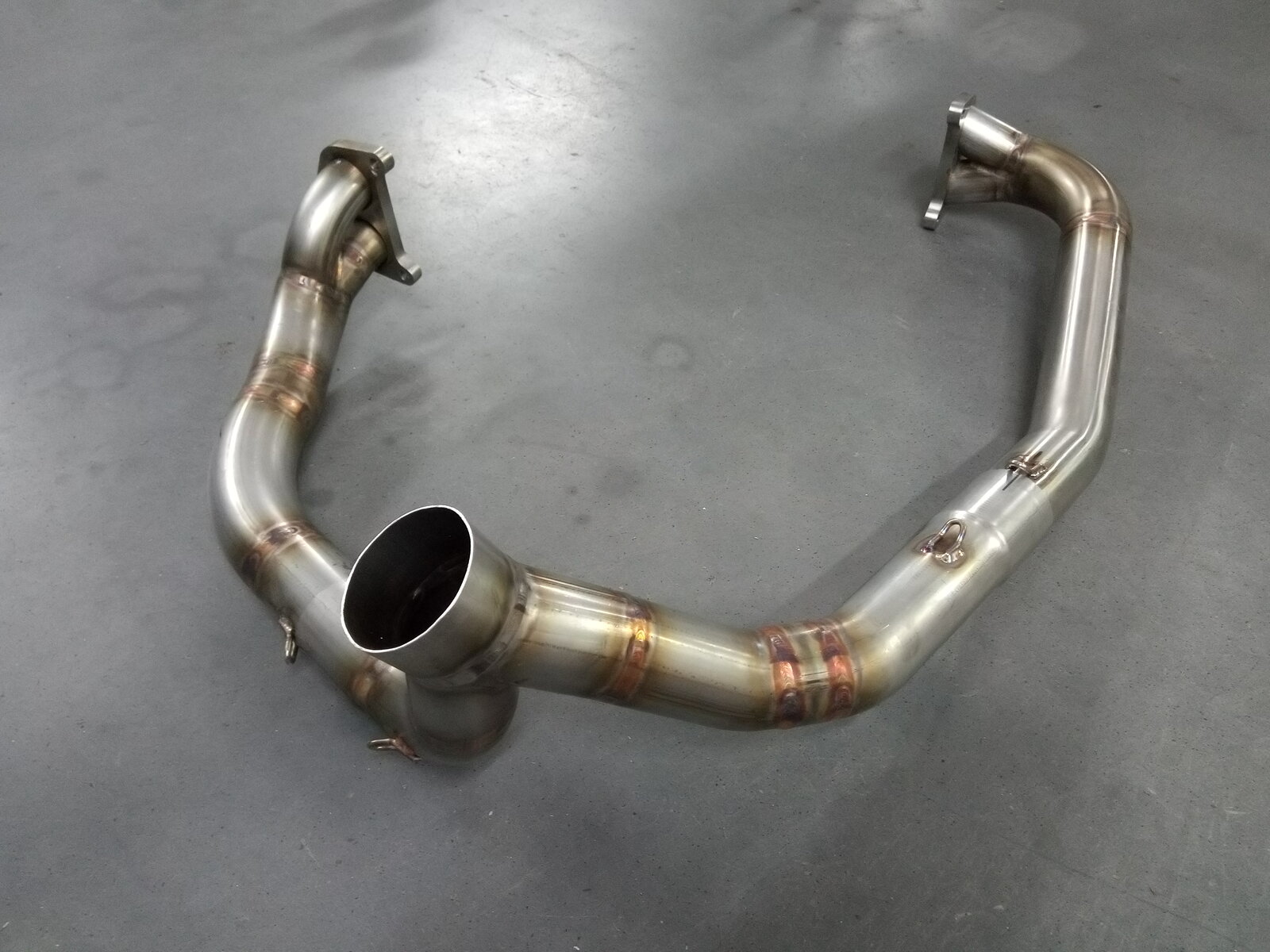

  7. Minor progress update. Headers nearly completed.
    • Like Like x 7
  8. Oooo love a bit of pipe porn!
  9. You sure that’s big enough?
  10. Tell you when we're finished.
  11. The headers looks stunning, nice welded
  12. Where have you been?Missing your photos!!

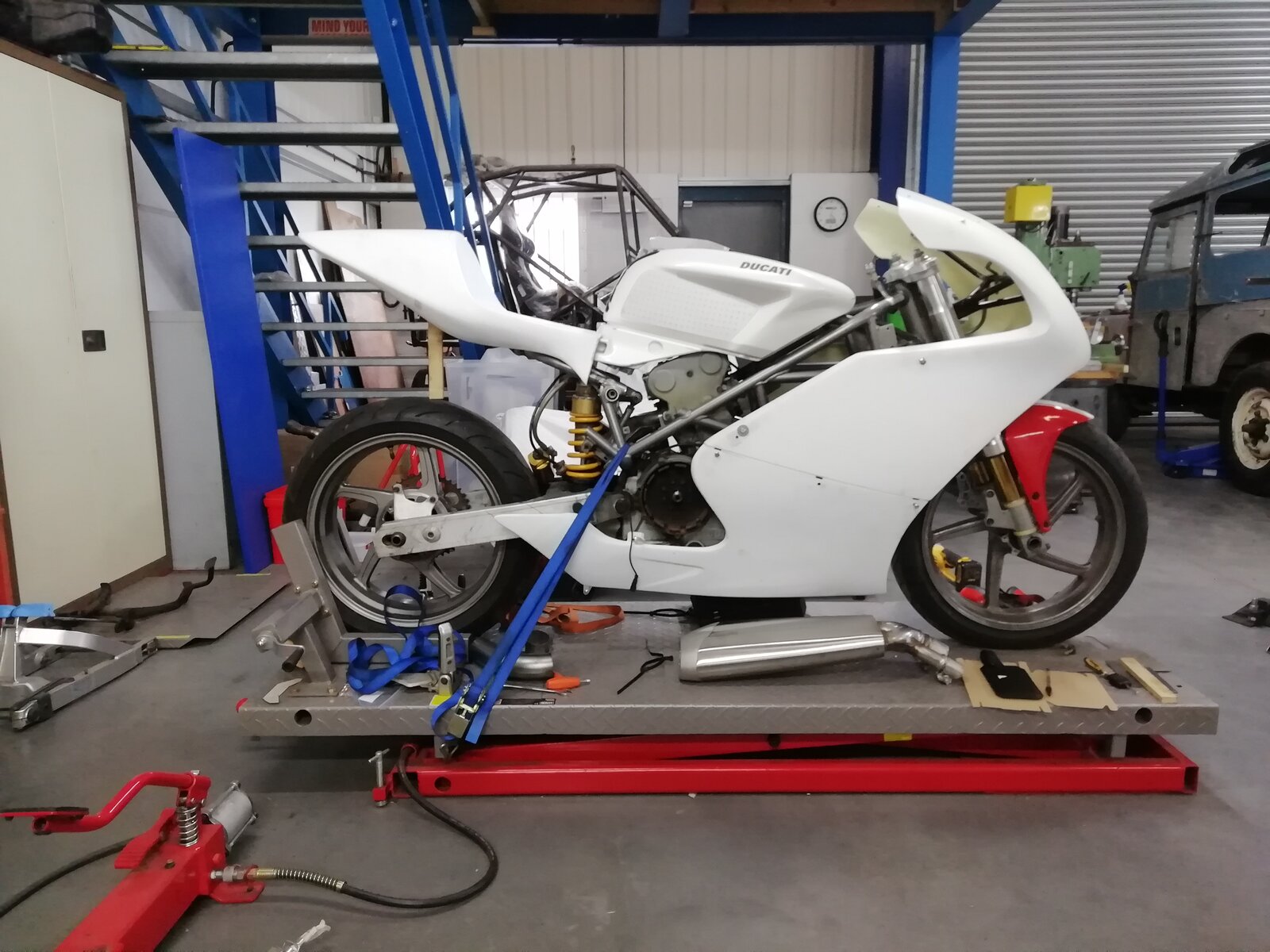

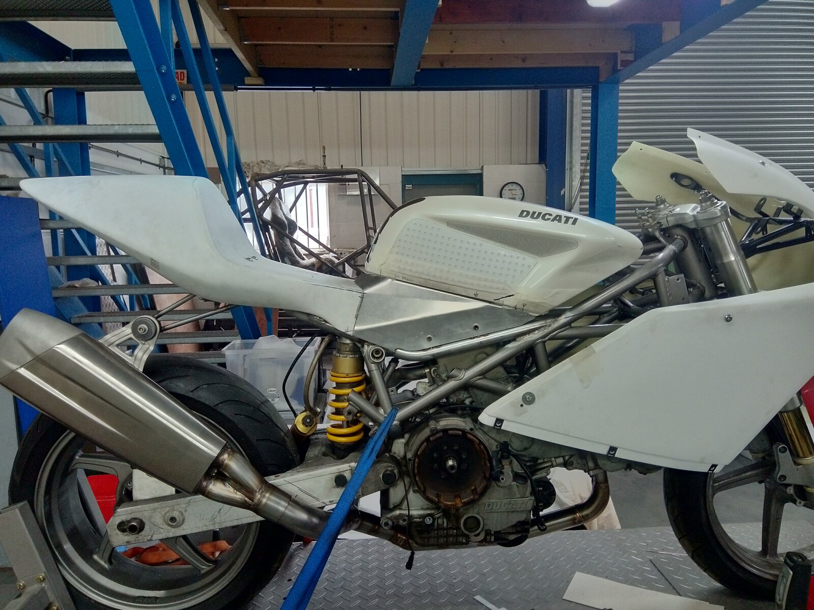

  16. Tiny bit more progress. Tanks in place and seat unit subframe functions.
    IMG_20190909_162852.jpg As always needs a little adjustment but is in place
  17. Looks good, Rear end is similar to my RRV. :upyeah:
    Are you sending the pipe out under the seat
  18. I do like the RRV shape.
    Exhaust endcan will be side mounted.
