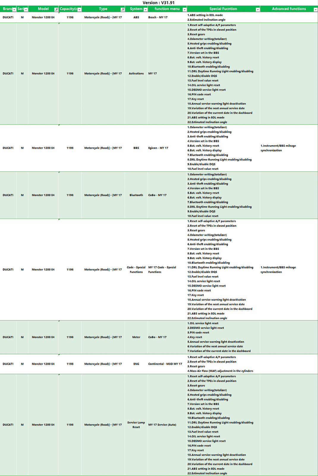

  8. What functionality does the OBDStar have for 2017 monsters?
  9. That's a pretty broad list; 1200, 1200 R, 659, 797 and 821 are all listed as MY17 models in the spreadsheet. Can you please be more specific about which one?
    ... just noticed that you have 1200s in your sig, there's no 1200s for that year according to the spreadsheet though. In fact the 1200s isn't listed at all... Just the 1200 in E3, E4 and R versions. The E4 and R are available for 2017, the E3 could be a late reg though if you're going by the plate year only.
    OBDStar capabilities for the 2017 1200 E4 Monster below.
    #29 Bumpkin, May 21, 2024
  10. Cheers bumpkin, it's a '17 1200s strange it's not stated for the S, bit looks a decent list
