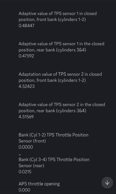

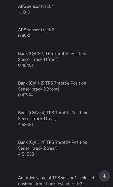

  18. Have any OBDStar users used it to investigate TPS voltages?
    He asks from the bottom of his rabbit hole
  19. Not specifically yet but happy to help be of service if you need a peak at another bikes behavior or something.
    Dave G.
  20. Please do plug your bike in, let me know the bike and let me know what the TPS Track 1 & 2 readings are on each throttle body plus what the “TPS Adaptive values” are.
    I nee to know if you see something like this please.
    ok it’s off a V4 engine hence the ‘bank’ and ‘cyl 1-2’ etc but let me know what you get.
    Thanks a million :upyeah:
