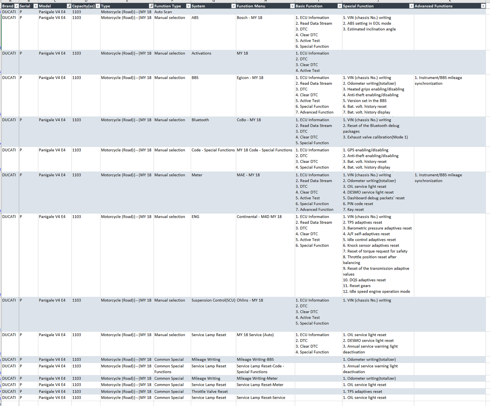

Discussion in 'Clothing, Gadgets & Equipment' started by Bumpkin, Jan 14, 2024.
