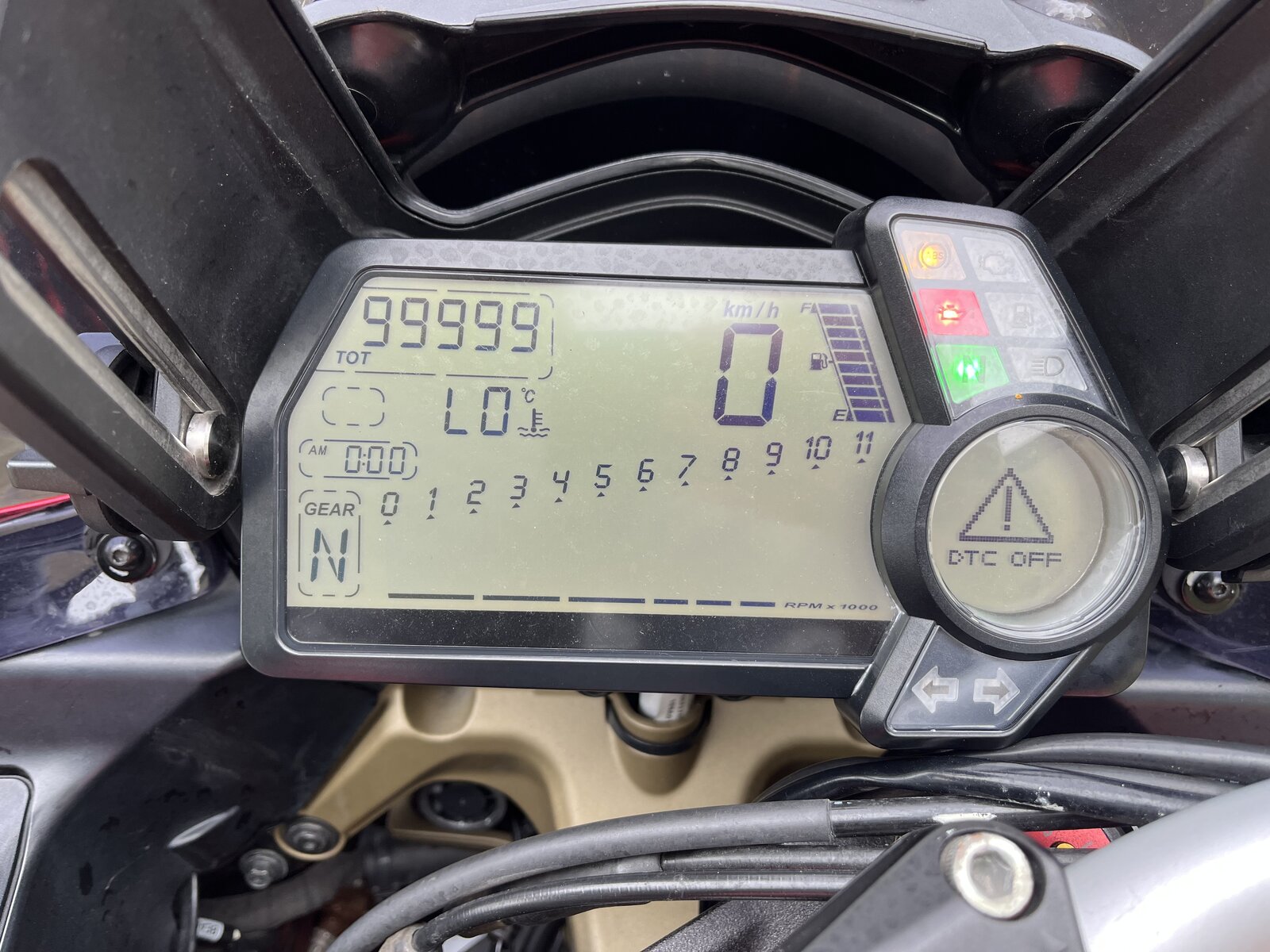

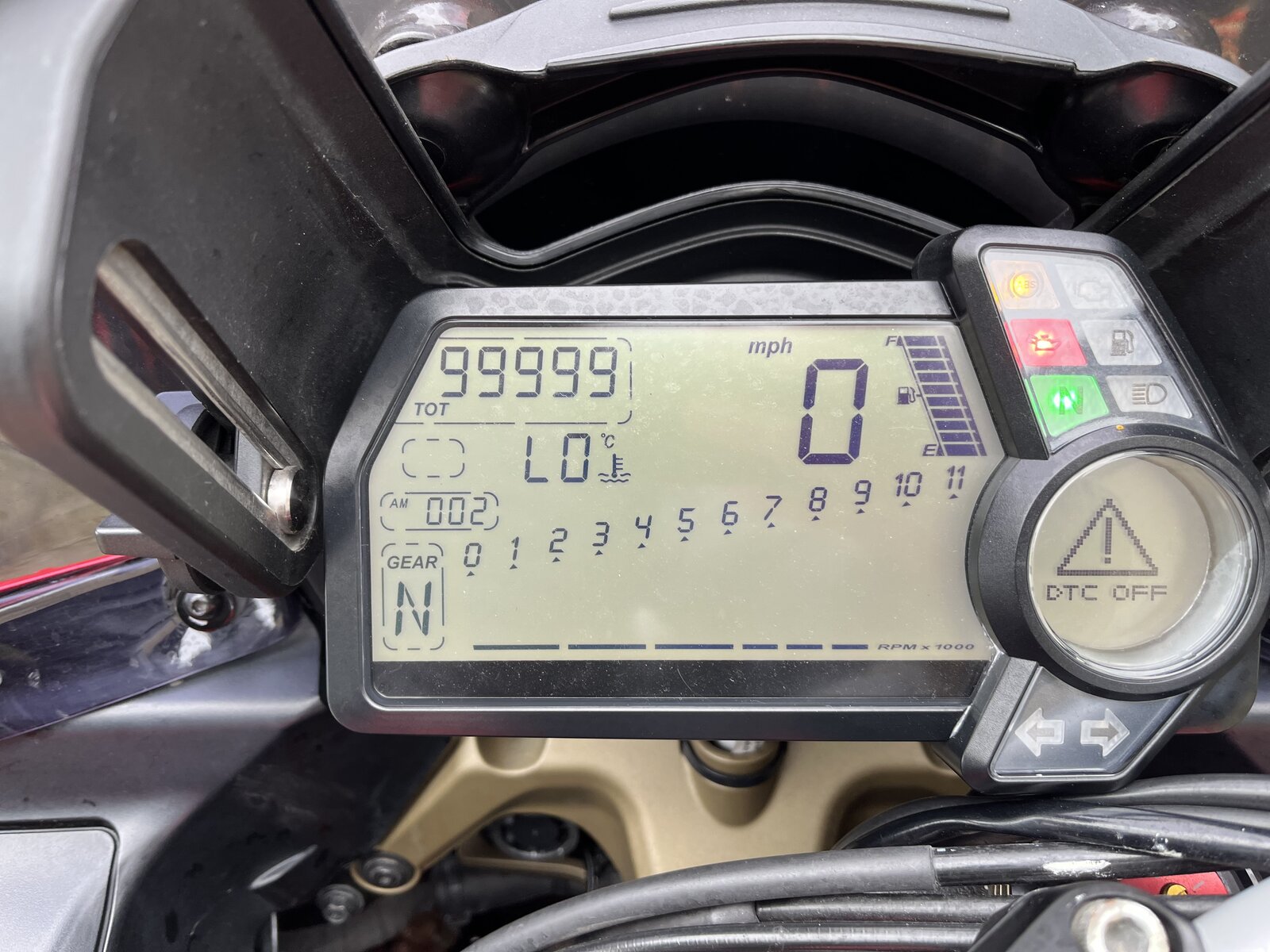

  7. Bit of an update....
    I took the bike to Ducati - their only suggestion is a new dash (£850) plus the new dash won't work with old fuel sender so I'll need one of those (£150), plus fitting. So well over £1k to fix a small electrical glitch!
    I have a plan B, which is to send it to Netherlands to Carmo Electrics, who think that they can fix it, but it will require cutting open the dash, so won't be a perfect job.
    Before doing that though, I seen a dash on ebay which I understood would be a direct replacement. I bought it (not cheap) and tried fitting it today, but it doesn't seem to work right. The lights up the side light up in the usual start up sequence, but the LCD doesn't display any info (although it does light up). The bike starts and runs, but everything is a bit strange - for instance the indicators flash like they're in slow motion. I then discovered that there is a difference in the part numbers - my dash is 406.1.078.5A, and the one I bought is 406.1.078.4A.
    I'm not sure if the dash I bought was faulty, or if the different part number means that they aren't compatible.
    Just before I send it back, is there anything that I'm getting wrong? Like could a bit of electrical cleaner and a scrub on the pins, or anything silly like that potentially make the new unit work!?
    My other thought is to cut the two dash units open and see if there is perhaps an obvious "odometer chip" in the ebay dash that I could perhaps transfer over to my dash. Has anybody had any experience in breaking these open!?

  12. The problem is that there seems to be about 10 different part numbers for dash units that are all supposed to be for 2010-13 ABS multistrada, but is seems like they're not interchangeable. It was hard enough to find one dash unit, which makes finding one with the exact same revision number seem impossible. Even buying a brand new one from Ducati seems like it would have it's issues (changing fuel sender as a minimum).
    If I knew for definite that there was just one chip that stored the mileage information, then I would happily open the two dash units and swap the chip over. I got the replacement dash off ebay for £180 (which I thought wasn't too bad), and my dash looks like it's either for the bin or going to need to be cut open to fix anyway, so it's not really the cutting open that worries me - it's more that there's a very good chance that I won't have a notion what I'm looking at after I crack them open! If I could get a bit of advice on that then I'd give it a go.
