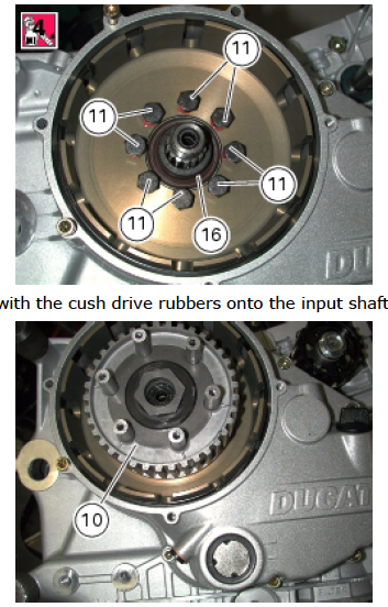

  1. I had a carbon one on there before but it shattered when I had an off, hence I had to fit the new clutch and what I thought was a sturdy cover.
    The bit you high lighted is perfectly smooth and round, like a washer, which only adds confusion, although I agree it does appear to be what's left of my cover.
  2. How many miles had you covered since you torqued it up out of interest? It's the other side I always worry about because the hot oil tends to break down the Loctite after a while. Hope you get back on the road soon.
  3. What has the crank got to do with it @Chris ? Just to remind you, the clutch is on the end of the gearbox mainshaft, not the crankshaft.
  4. if the clutch basket had any wear on the splines possibly from running slightly loos in the past? no amount of locktight will stop the nut coming loos as the basket will rotate slightly on the splines during acceleration and deceleration.
  5. The basket isn't held in by the big nut though, is it? It's bolted in with 8 smaller bolts. That's why it's still in place in thet pic. It's the centre hub that's held in with the centre nut.
  6. you are absolutely right of course, memory shot/poor terminology, but i hope you know what I meant. i.e left side crank nut and right side clutch nut are two most likely to come loose. Play at drum bearing also always worth a check while you're in there.

  7. is it not the center nut that has come off?
  8. works a treat - a mere doddle.
  9. yip use it all time. but there's no denying center nuts come loos when splines are worn. spring washers and lock tight rock. and even then?
  10. I know and hopefully you also know that if, on stripping, a loose spline is discovered then it's a 'no brainer'?? i.e. something with a 'substantial' mass* is going to 'walk around' far more so than if tight. This is why we should never complain when anything* splined is tough to remove.
