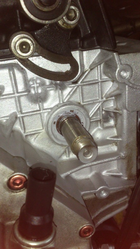

    Ordered new seal and shaft circlip from Baines, arrived in the post the next day! Nowt better to do today so thought I might as well get it out the way... :biggrin:
    Plugs out, strip it all off again - minor faff getting the wire circlip off (ordered a new one, 88210031A, £1.26)
    Old seal out, degrease the orifice & seal carefully with a little brake cleaner on cotton buds, a small smear of threebond on the seal just before it went in, then wiped round the outer afterwards:
    Not pretty, but you can't see it with the pulley back on. :upyeah:

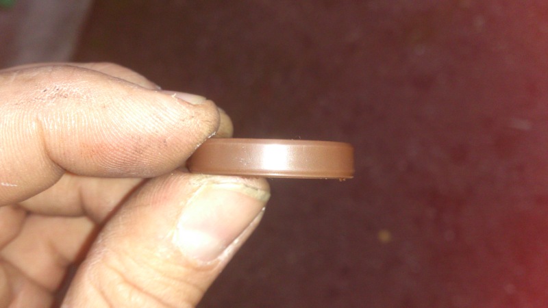

    The seal itself is pretty thin, with the actual contact surface even thinner?

    This is the third seal, we have established the oil is leaking around the outside of the seal itself so no amount of spring nipping will cure that one lol :upyeah:
