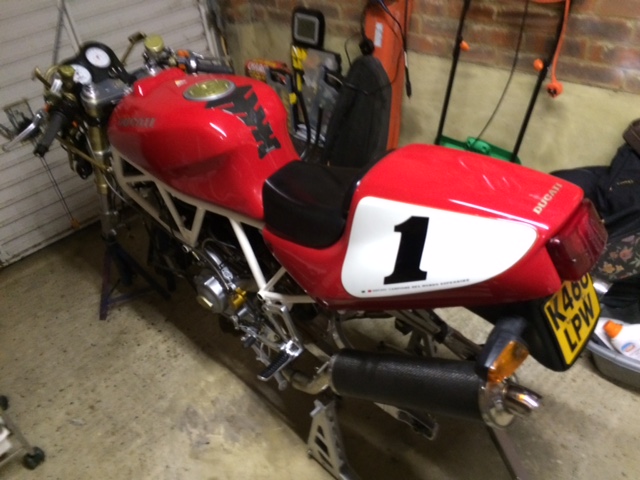

    Bikes really coming together now, one issue i am having is the 7.5 amp fuse blows when i pull up the Front break lever, i assume its a short in the switch maybe ?
  2. yep, suspect corrosion in the micro switch or maybe the wiring is crimped / damaged, great to hear you're making progress.

    Any way after a slightly painful two weeks of trying to sort out why i was blowing fuses every time the brake light came on (dodgy bullet connector) and why i had no spark (slightly iffy fuse) i finally got to the point where i could get her started and guess what ....she fired up first prod of the button !!!! idle needs to be fine tuned but well chuffed, its a bit chuggy but the fuel is five months old so a bit of fresh and she should be spot on.
    Well pleased :upyeah:
  12. well done! tis a good feeling when they burst into life :upyeah:
    (I had a similar issue with new fuel tap leaking, the two parts that screw together R/H & L/H thread need to be closer to each other, sorry not very clear, but try not to make the assembled tap too long)
  13. Ok ill try that cheers for the tip :thumbsup:
  14. Something i did notice was that the Hexagonal bar on top of the right coil (looking at the bike from the rear) was getting really hot, to the point where i couldnt touch it, the left was fine, any ideas ?
  15. electrics are not my strong suit, but that sounds wrong, wonder, could the insulation have broken down? or might a bad earth be responsible? (just tried to call my electrics mate, no answer, will try again later)

  17. Test the resistance.......?
  18. Sorry to say i dont have any electrical testing kit but.... i will be investing
  19. That looks nice and tidy Sev, cheers for the advice, ill go through all the connectors, earths and everything else and see if it makes a difference, if not ill get some new coils, mine have been rattling around in a Cardboard box for the last four months so could have become damaged.
